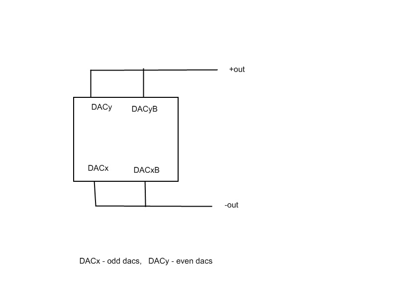

First of all, As far as I know, true differential mode + 9-bit quantizer register
settings only result in distorted sound.
Output pins are rearranged as shown in attached drawing(and of course each dac polarity must be re-programed)
register settings are :
- mono mode
- Pseudo differential mode
- 9-bit quantizer
results:
Positive output + DC block cap connected to SE input of the amplifier
- Clean audio playback, not distorted like true-differential register setting under 9bit quantizer mode.
Positive and Negative output followed by line transformer (for BAL-SE conversion)
- Clean audio playback.
Positive and Inverted Negative output (now same polarity with positive output), followed by line transformer
- Successfully cancelled.

9bit number can be split to two 8bit ones, only under pseudo differential register setting. Let's call them as half-9bitA and half-9bitB.
Usually one of them are just inverted (and assigned to DACXB), thus we can get complete audio output only after Bal-Se conversion.
If same polar these half-9bitA and half-9bitB connected in paralell is identical to complete 9-bit quantizer mode output, we can get two 9-bit SE output
from one IC without BAL-SE conversion circuit.
Then Additional polarity programming and Mono mode setting should enable us to "imitate" true differential mode.

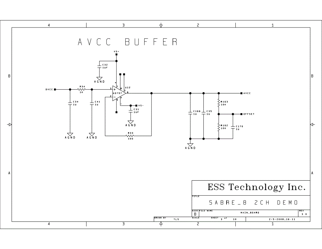

Why do the Avcc buffer in ES9008's evaluation board not oscillate,
even with AD797 which is known as easily oscillate opamp and 2uF enormous capacitive load?
a small capacitor of some 50-100pf in series with another resistor, together bypassing the FB resistor, increases capacitive drive ability for the AD797, plus here we are talking about low voltage and its not driving a low impedance. needs careful layout, especially at unity gain, but it works no problem.
alternatively, try lme49990
thank you roender , qusp.
I read AD797's datasheet and found a description about paralleling small C <33p with 100ohm resister.
Although there is no such C or any effective snubber but a simple voltage follower...
Could you explain in detail?
The AVcc buffer drives half of the current output from ES9008's analog output in the evaluation board's configuration.
The AC analog output is differential ,thus its load is always almost DC 2.112mA*8DACs= 16.896mA(=195 ohm!) and 1+1uF and offset generator.
I feel it is not so light load though it have (ideally) no voltage swing ,but does it have any influecnce for stability?
