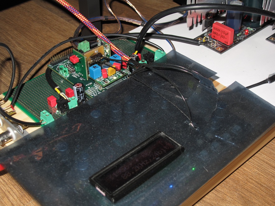

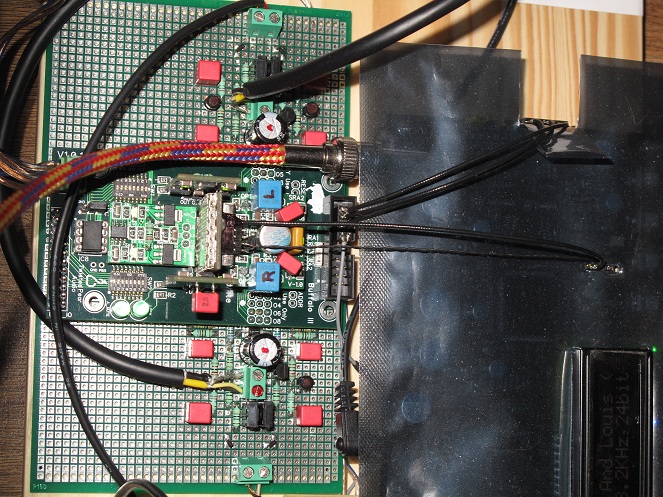

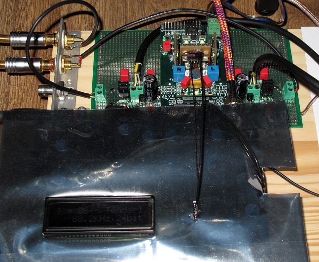

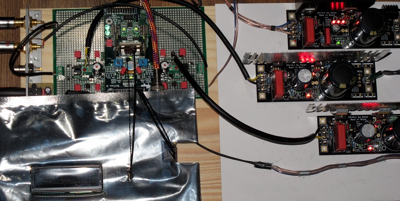

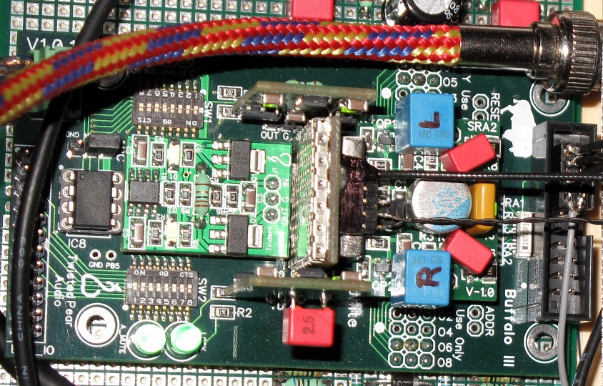

How close to the DAC is the clock? In the particular case of SDtrans384, 11.2896Mhz is not a valid clock. So, how is MCLK supplied back to the transport?
In my case, I have two CCHD957 oscilators (45.1584MHz and 49.152MHz) located very close to the DAC and the MCLK for the transport is divided by a Potato Semi D flip-flop. The DPLL bandwidth is set to "Lowest" and there are no unlocks from 44.1/16 till 192/32 PCM nor for 64 or 128DSD.
I'm not sure if BIII DAC accepts "No Bandwidth" with standard firmware in order to make experiments but will be interesting to know how is works.
Please see the attached pictures of my setup.
Kind Regards,
Mihai

... How close to the DAC is the clock? In the particular case of SDtrans384, 11.2896Mhz is not a valid clock. So, how is MCLK supplied back to the transport? ...
Among three, Tackbon uses SDTran384. Other two use QA-550 with NDK oscillator.
Tackbon's clock configuration is shown in his diagram.
By the way, your implementation of Crystek oscillators is really admirable! You have also prepared your own AVCC power supplies for your BIII.
