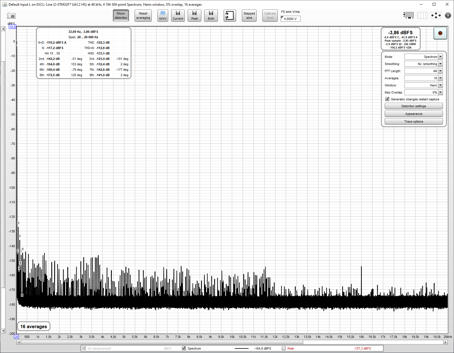

As I was testing my ES9822PRO board I noticed that the 1kHz FFT spectrum has high harmonics up to 100kHz and beyond.
Here is ES9038Q2M to ES9822PRO.
The harmonics of 1kHz continue throughout the spectrum albeit at a low level.
So are these harmonics coming from the DAC or the ADC?
Here is the same ES9038Q2M DAC but with AK5394 as ADC (fs is now 96kHz).
So it seems DAC is the culprit. Or is it?
To verify I switched to a 1kHz oscillator (my take on Victor's). Here is 1kHz oscillator + AK5394.
As expected spectrum is quite clean.
Let's repeat that measurement with ES9822PRO.
Surprise, surprise. The 1kHz harmonics are back. Also ES9822PRO has high harmonics.
So it appears that ESS architecture (Hyperstream?) causes high harmonics both in DACs and ADCs. Is this the cause for the infamous ESS sound?

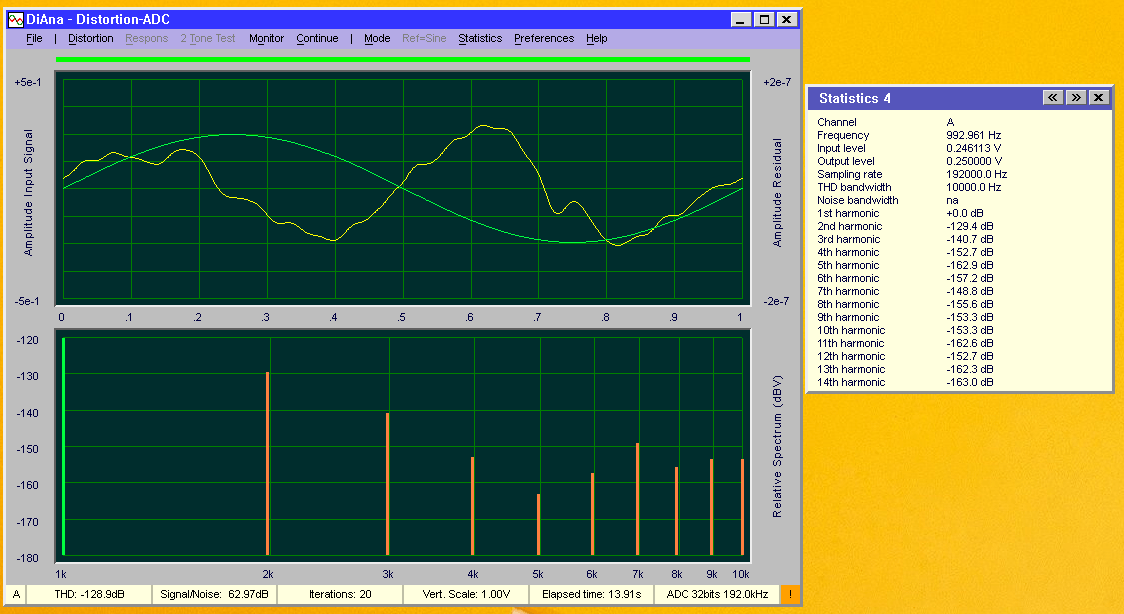

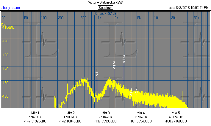

On the one hand do harmonics or noise below -110 dB matter? However it may when looking at a more complex signal. The AK5394 is a remarkable ADC. I have had similar results. Unfortunately the chip is discontinued. Possibly some IM type of signal would show higher levels of distortions. Also would be interesting to look at transient response. Below for reference is my Victor to Shibasoku and the Victor to AK5394 (Using Diana). Diana lists the harmonic amplitudes to the 14th.

None of your images show anything over 100kHz??
Correct. I made that assessment based on earlier measurement I made with the same devices at 33.69Hz. In that measurement high harmonics can be seen up to 12kHz. So assuming similar behaviour at 30 times higher frequency higher harmonics could go beyond 100khz (only 8 times higher than 12kHz).

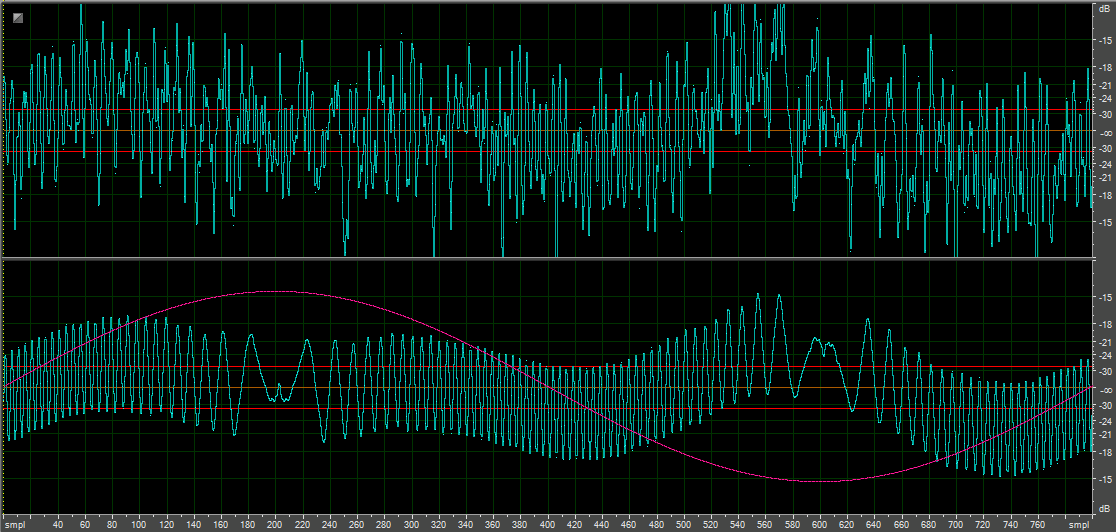

The error pattern might resemble a bit the known one for missing lower bits (which would produce a staircase) but actually its a sine-like error pattern. When I investigated the ESS hump in a DAC that has a massive hump the Eureka moment was when I looked at the distortion residuals with most of the noise removed.
Residual plot taken from my thread https://www.audiosciencereview.com/...-hump-revisited-khadas-tone-board-v1-3.30136/, at 0dBFS:
We can see a sinusodial ripple overlay in the residual whose momentary frequency scales precisely with the momentary slope of the exiting sine wave... which I later managed to model with a piece of software which just adds a sinusodial ripple to a sample-in --> sample-out transfer function: https://www.audiosciencereview.com/...-hump-style-distortions-to-audio-files.30758/
With a bit of tinkering on scale factors and error magnitude I got really close to the measured results for that DAC under test.
