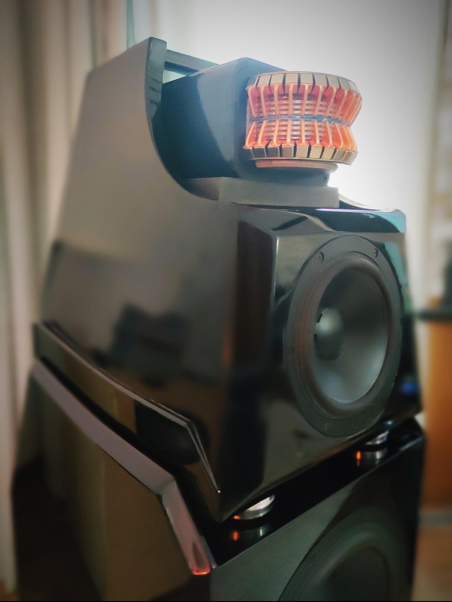

ESS AMT tweeter. Help for correct use

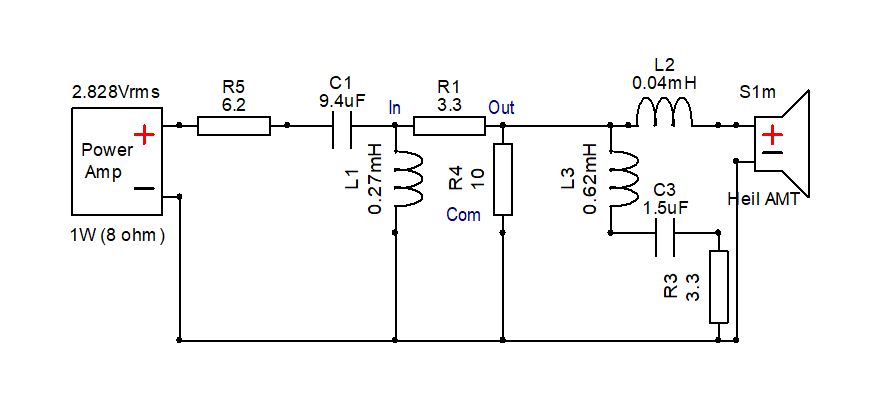

Another option for those looking for crossover guidance. I eliminated most of the resistors because I may use this with some pro high-efficiency mids, and I changed to 3rd order to protect the tweeter from high power. Note the 3dB divisions in the graph - about +- 2dB from 2.8Khz - 16KHz. I have not measured this version yet.
Hello, thanks for the information. What is the function of the LCR circuit in your crossover?
Hi Toni,
If you desire more overall level from the Heil then make the R5 resistor smaller.
One only needs to parallel any value resistor to the existing R5 ( 1.5R ) to arrive at a smaller net value.
You might start by adding another 1.5R to R5 ( giving a 0.75R value ) to see if the increase in HF level is attractive.
Apart from the above, how does this custom setup currently sound to you ?

Hi, as I said, only I have added the LRC circuit of your scheme. Currently the volume level of my ESS is adjusted to my taste in relation to the mid wofer and wofer. I do not know if it is necessary to use the same crossover T-Pad system that you proposes to get the same result from the crossover response simulation. I attach photo of my current crossover. The truth is that with the RLC circuit the "silabance" of the ESS is greatly softened. Maybe that problem is maintained (I place it now around 7-8khz) but it is much smaller than without the LRC circuit. I prefer the sound without the bovine of 0.05 uH. It's personal taste. I have to say that the problem of "silabance" is much greater when listening to compressed music, for example through youtube, than listening to music with my cd player. I am not able to explain the reason.
Thank you for you help
That is a broad, low Q "tank" - it flattens out the frequency response 3k-16k.
If you lower the resistor value, the Q goes up, and it will show a dip.
If you change the inductor or capacitor value, it will change the center frequency of the filter.
You can do these kind of filters either in parallel to the driver (as I have done), or you can use a LCR components in parallel, then place that group inline with the tweeter positive lead.
Hope this helps

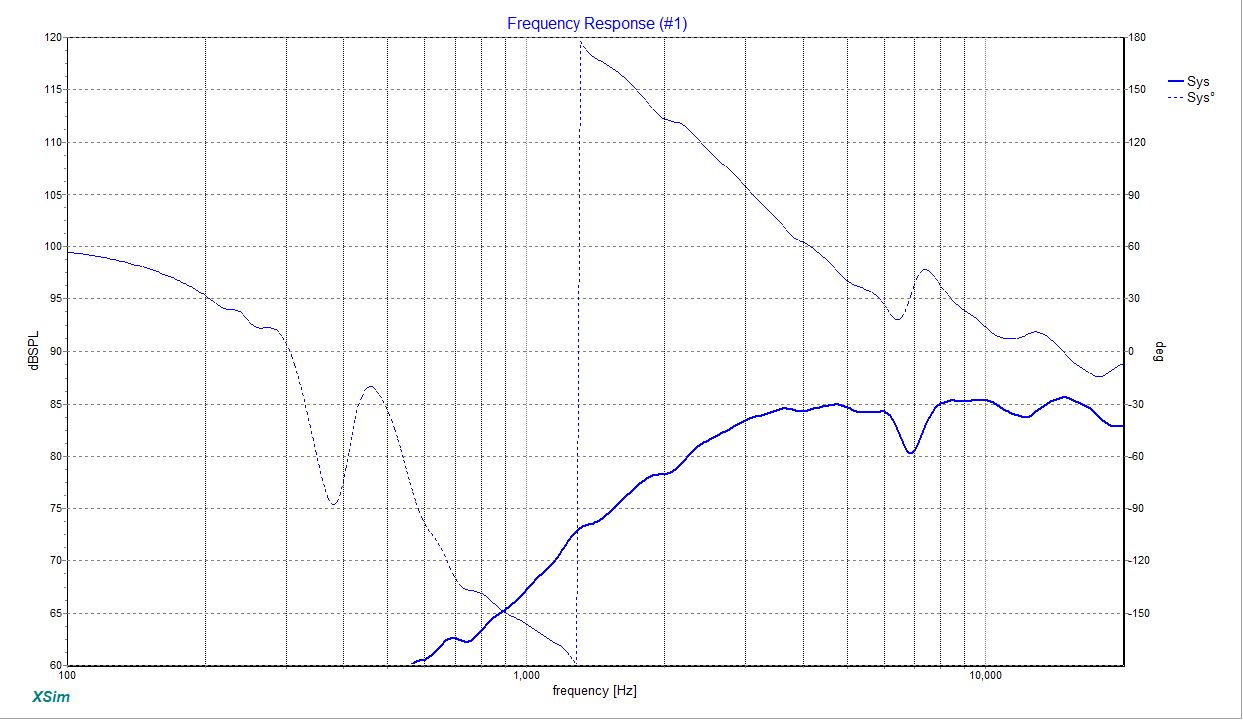

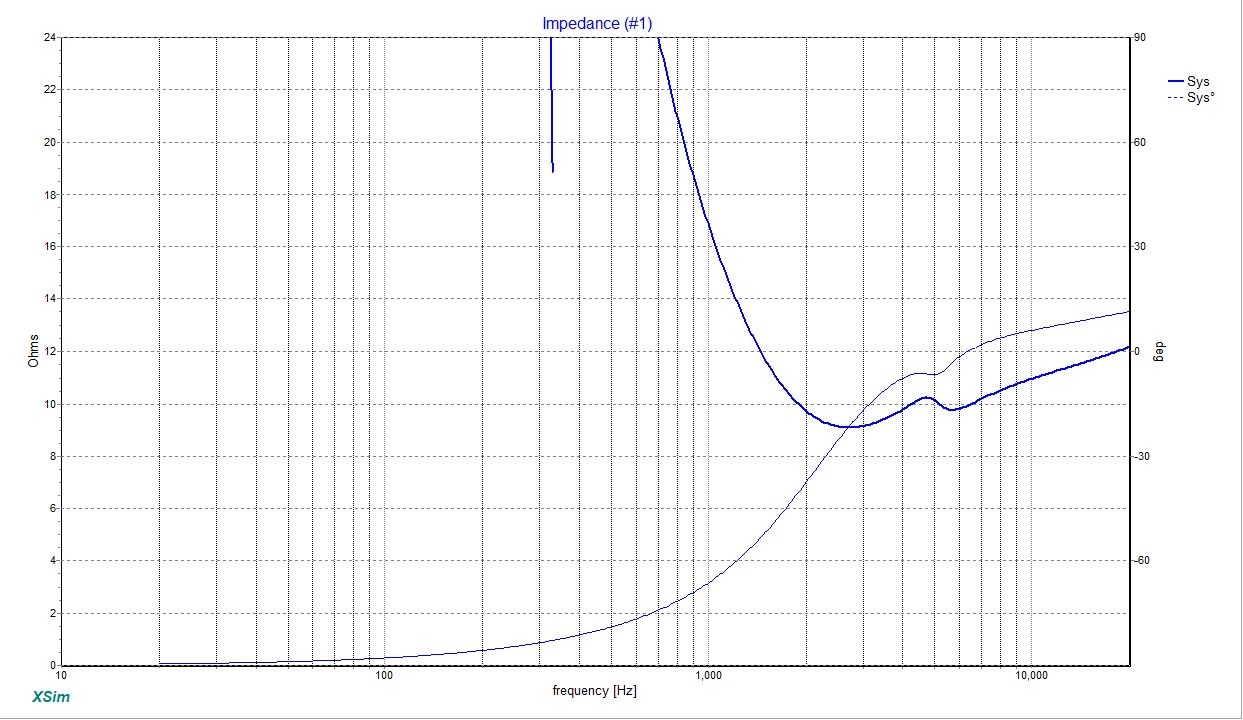

good morning, I am very happy with the XSim tool. By downloading the file shared by EarlK of the AMT, I have been able to include all the components of the current crossover. It is very interesting
It has caught my attention when I compared the original crossover made by Earlk with the one I have that the answer is practically identical. However, the impedance graph and the slope of the fall of the response curve are very different. The only difference between both crossovers is the Lpad circuit. I use Duelund resistors and they are quite expensive. Do you think it is worthwhile to adjust the values of the earl ear design by changing the current resistances for which the EarlK design includes?

Hi Toni,
Acoustic Center ( of the AMT ) ?
Simply put, I believe you will find that the ESS/AMT device is found placed some distance back from the front edge of the baffle because that position offers the best phase match with the other components ( woofers or mids ).
I don't own any of these device but I imagine that the Acoustic Center is right there at the pleated ribbon.

Hi Toni,
I don't think it's worth your effort to change the component values to match what I previously provided.
The frequency response curves are very close ( & your impedance graph is good and high ) so my advice would be to now enjoy what you have.

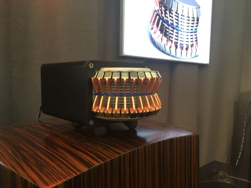

In the last High End show in Munich, I had the opportunity to discover the Air Blade from Arya. I am very interested in this product as a possible candidate to replace my ESS AMT in the future. Not because I do not like ESS, but because I think it can improve in some aspects the performance of ESS. Not yet sold Does anyone have any information on the price they will have when they are on sale?
BR
From AudioXpress:
"The company plans to offer its first batch of drivers for the high-end market starting August 2018, at a suggested retail price of around £1000 per unit (approx. 1300 USD). Products for Pro Audio and automotive market will follow at a later stage. Apart from the AirBlade driver project, Arya Audio Labs is also working on several other projects, such as the RevOpod damper or a range of Kappa cables for state-of-the-art high-end applications."

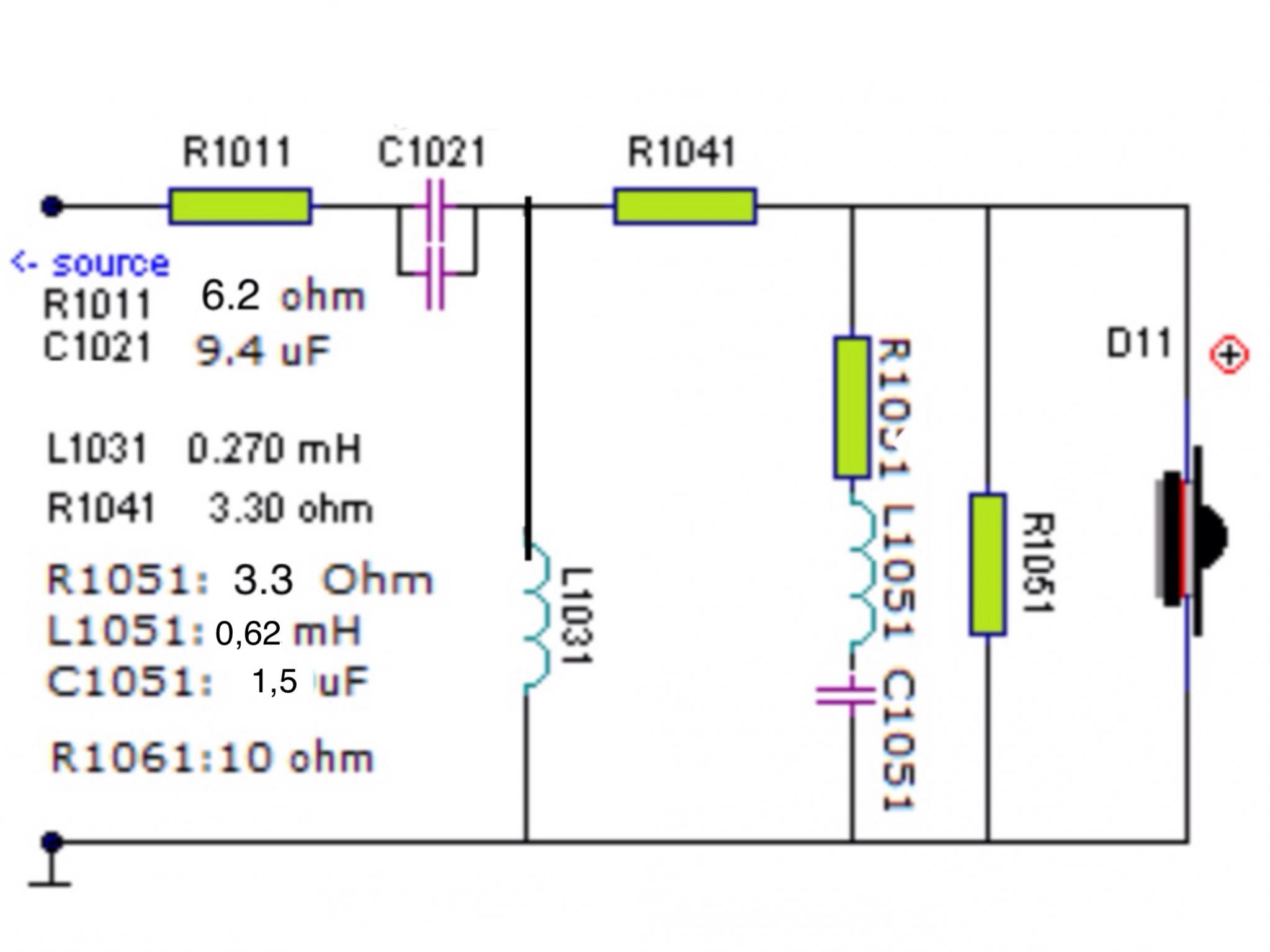

Currently I have this filter without L2. My question is about L1. I use in C1 Duelund cast copper. All resistors are Duelund cast graphite. I also use the Duelund bypass Silver foil (0,01uf)
BR

Sorry, but I really can't help direct you towards a better sounding inductor coil for that position ( L1 ).
I'm curious; What has developed/happened to the "sibilance" problem that was the initial reason for you starting this thread ?
Earl 🙂

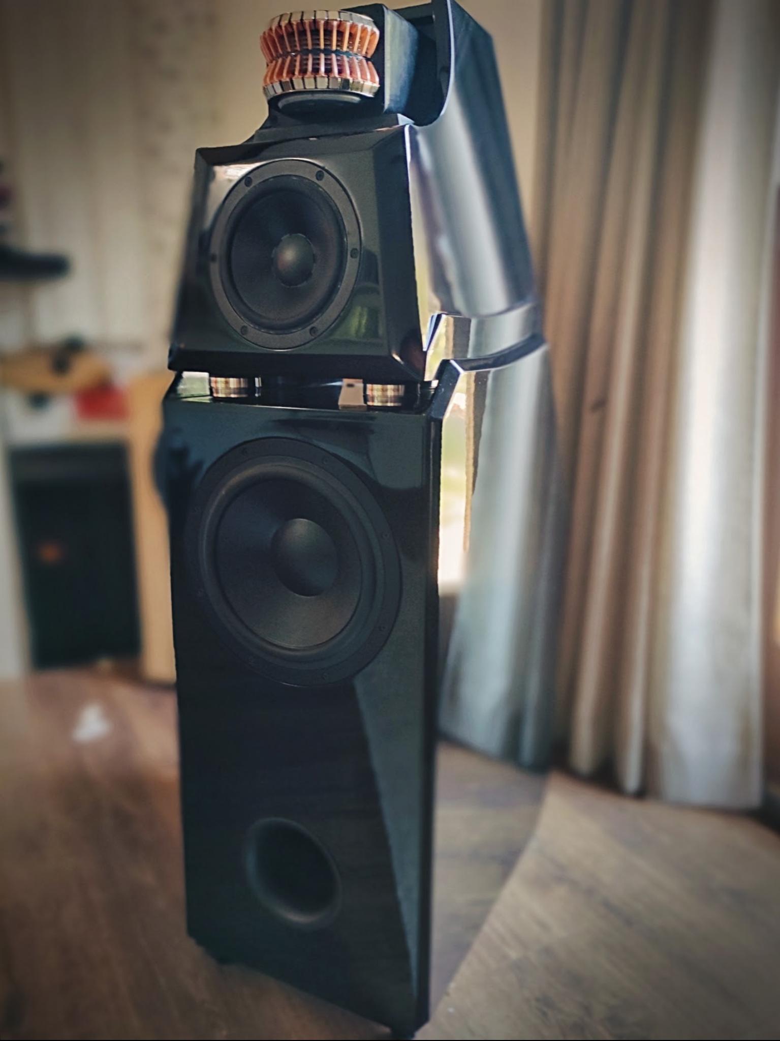

Thanks to the help received here, I managed to sound the ESS very well (for my taste). However, he had long been following the Arya Airblade with interest. Finally, I have acquired a pair that I have already integrated into my loudspeaquers replacing the ESS. Its integration has been easier than the ESS and I have to say that I loved its sound. For my taste it is a more refined, soft and delicate sound than the ESS, maintaining the character of AMT technology that appeals to me, such as transparency and naturalness. To date the best tweeter I have ever had.
BR
