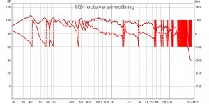

Not to upset the general spirit of tuning up passive notch filters, but for those wondering what the DSP crossover settings would be for a recently produced AMT-1 which is fully broken-in (in the following case using a 1979 Klipsch Cornwall bass bin with the back against a wall and the AMT-1 referenced to the front of the cabinet), the following PEQs were used to flatten the AMT-1 + Cornwall bass bin (two-way) response, crossed at ~700 Hz using first order filters (using an EV Dx38 crossover):
280037645_CornwallBassBinAMT-1PEQsettingsfinalscreenshot.JPG.15d1b1f5b7b0724f00ccddfb41a8a0c8.JPG
These settings were determined in REW using a microphone placed 1 metre in front of the loudspeaker assembly with the microphone's axis just below the centerline of the AMT-1 and pointed up at a 45 degree angle. There is plenty of absorption material on the floor between the microphone and the loudspeaker for taking polar measurements (0 to 90 degrees off-axis). The resulting on-axis SPL and phase response is as shown below, with the min phase trace in gray color. The vertical resolution is 1 dB and 45 degrees of phase grid lines, as shown:
1090553932_CornwallBassBinAMT-1at1mOn-AxisSPLPhase.jpg.f2e4a6fa5f66470d78f92fc71fe6cfaa.jpg

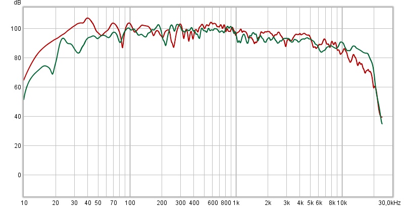

Hello, Here are the loudspekers curve response in the lisening point (red) and the L Chanel at 1m. (I use a subwofer too)
The crossover is the same of the Troels G. ATS loudspeakers. Jenzen-ATS Im only change the tweeter LCR and the first resistence. In any case I dont want make a great change in the crossover, only try to integrate the ESS in the actual configuration. I most say that the ATS original tweeter (Berilium SS) sound great but, in the other hand, the ESS have a special amb magic personality.

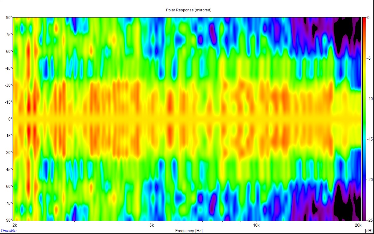

...Another thing, as far as I can remember in the frequency plots I have seen of the AMT1, it is only in the 0 degree plot that the spike at 5 kHz is an issue...
I don't see that at all: normalized polar plot to 90 degrees of an in-room AMT-1 EQed relatively flat using an EV Dx38, below:
attachment.php
If there were only an on-axis issue, it would show up as a big roll-off outside of on-axis at 5 kHz. I don't see anything like that...
Chris

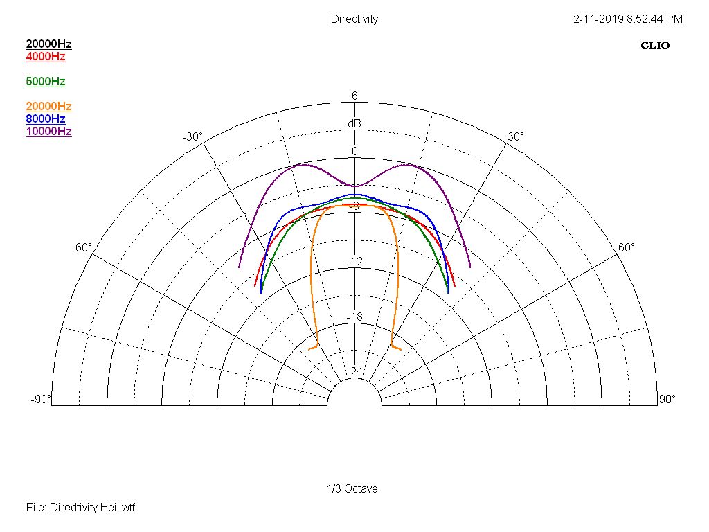

I am using a passive 5.5K notch and don't have a hole in the response off axis as well, that's the only EQ I have on them.
Rob🙂

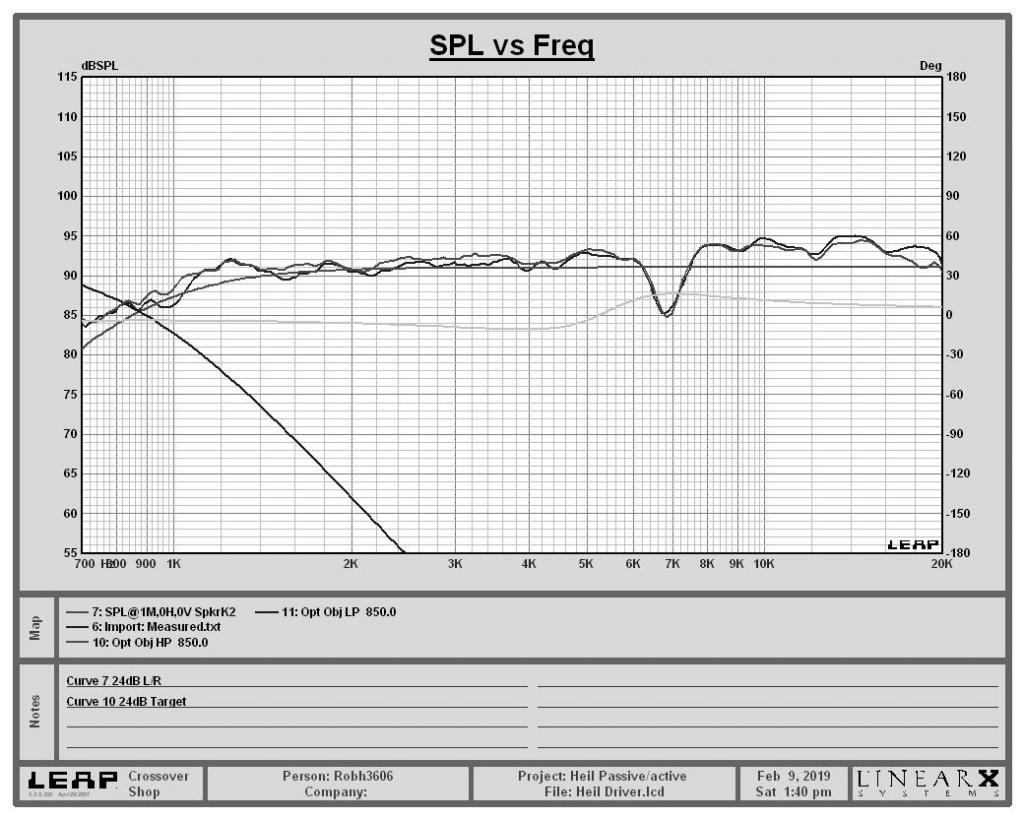

Hello TONI
Here I blew it up to make it easier read. It is a .075u with a series .33 resistor to lower the Q and broaden the notch. To make the .075u I purchased a .100u and took some windings off measuring on a WT2. The DCR of the coil is about 60 mili ohms to get closer to the target of .4 ohms total. I also attached a measured vs. predicted so you can see the on axis response is with the notch and the active 24Db L/R crossover. The others resistors were bring up the DCR overall to about 8 ohms. I loose about a 1db to or so overall.
Even though there is still a rising response it sounds good to me as the overall power response tends too flattens this out.
Rob🙂
