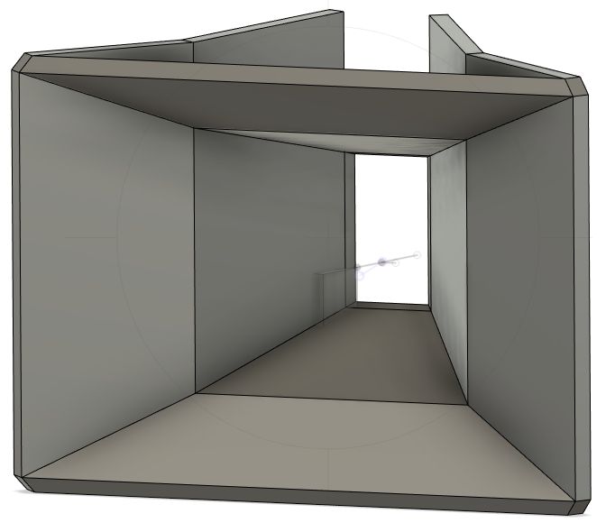

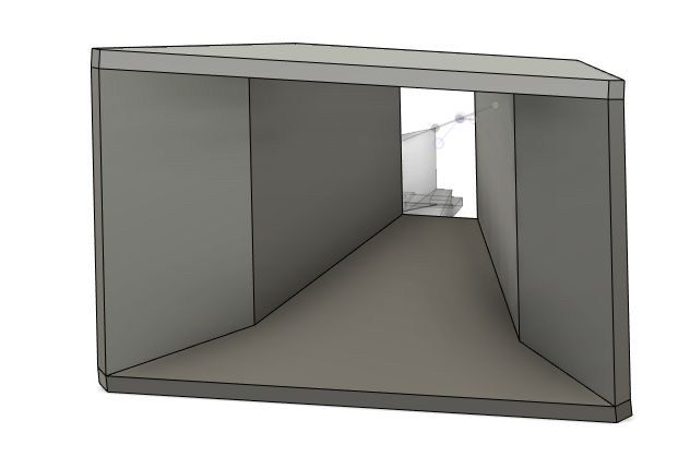

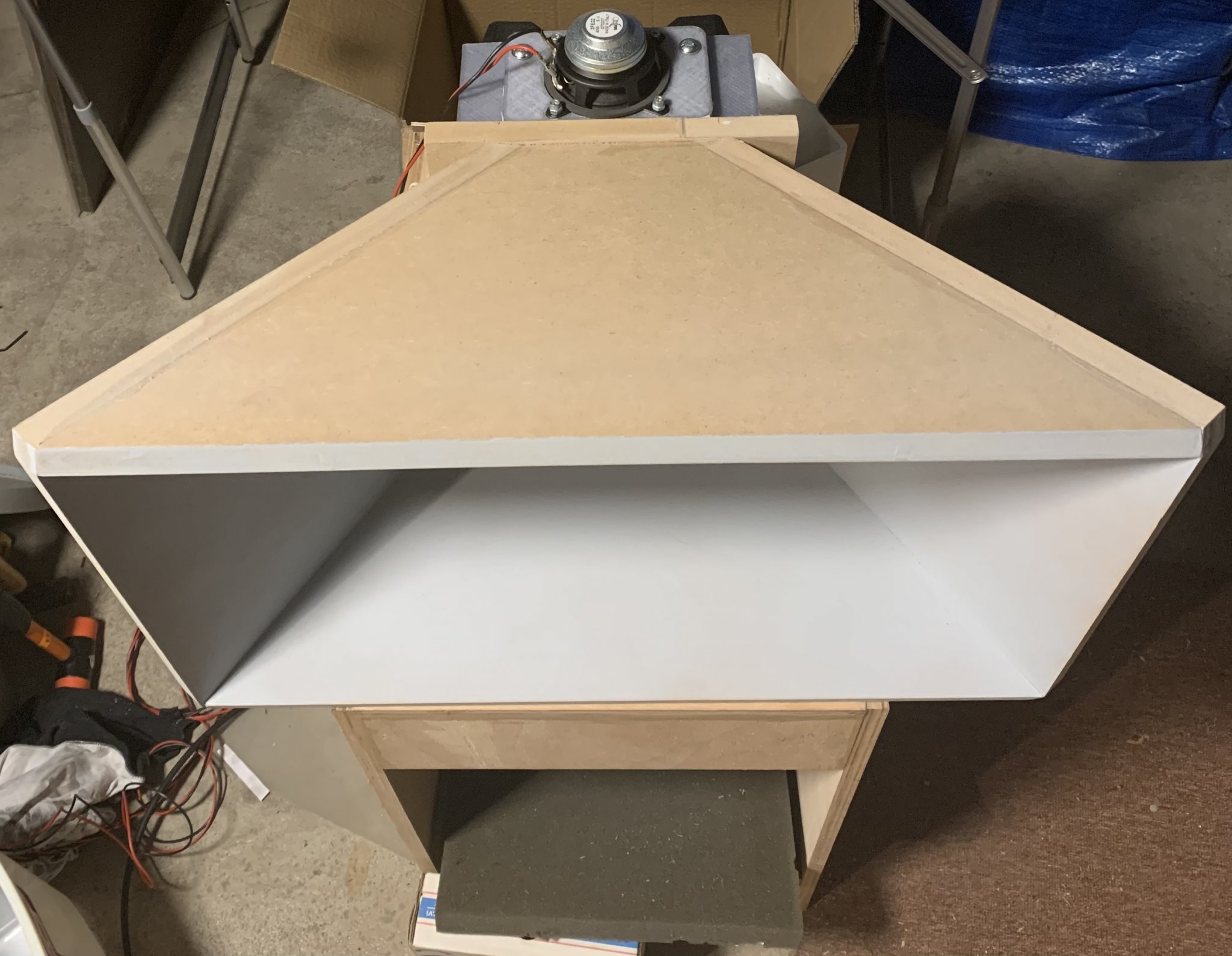

I do not like the old biradial design enough to put it on a CNC, I need to start with a less ambitious project. I have some spare 18 mm MDF and CNCing flat components for conical horns is easier and faster than full 3D. I have 3 preliminary designs, not sure which one will be selected.Most probably the first one. The dimensions are 1: 500 x 306 x 300 mm, 2: 353 x 308 x 300 mm, 3: 560 x 306 x 335. There are additional 46 mm of horn depth in the 3D printed holder/synergy attachment. The dispersion is set to 50 (H) x 30 (V).
I intend to use this horn from cca 300 Hz up or maybe even a bit higher. I really need to finish this project now when I have all the tools and materials I need🙂

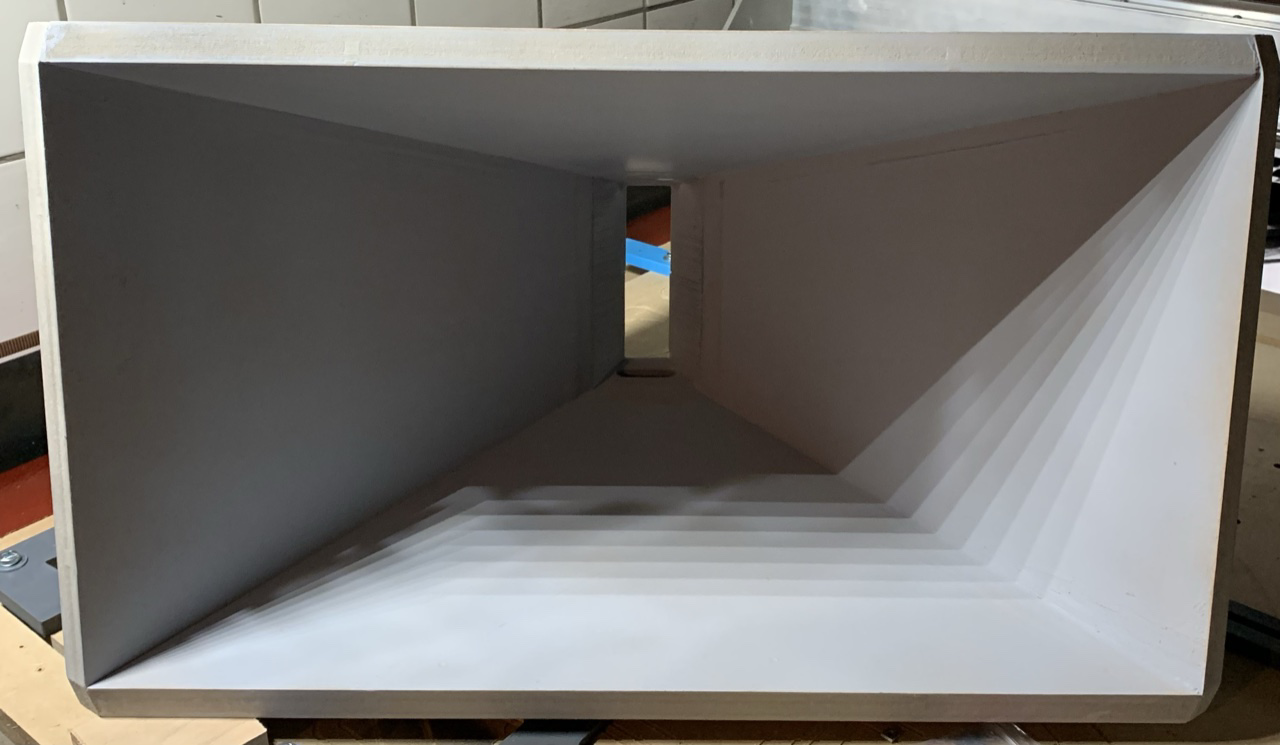

Kind of slow, but still progress🙂 The first horn is ready to install the drivers for testing. Just two layers of primer and little sanding. If it proves to be good, I will work a bit more on the finish and also on the plastic throat.

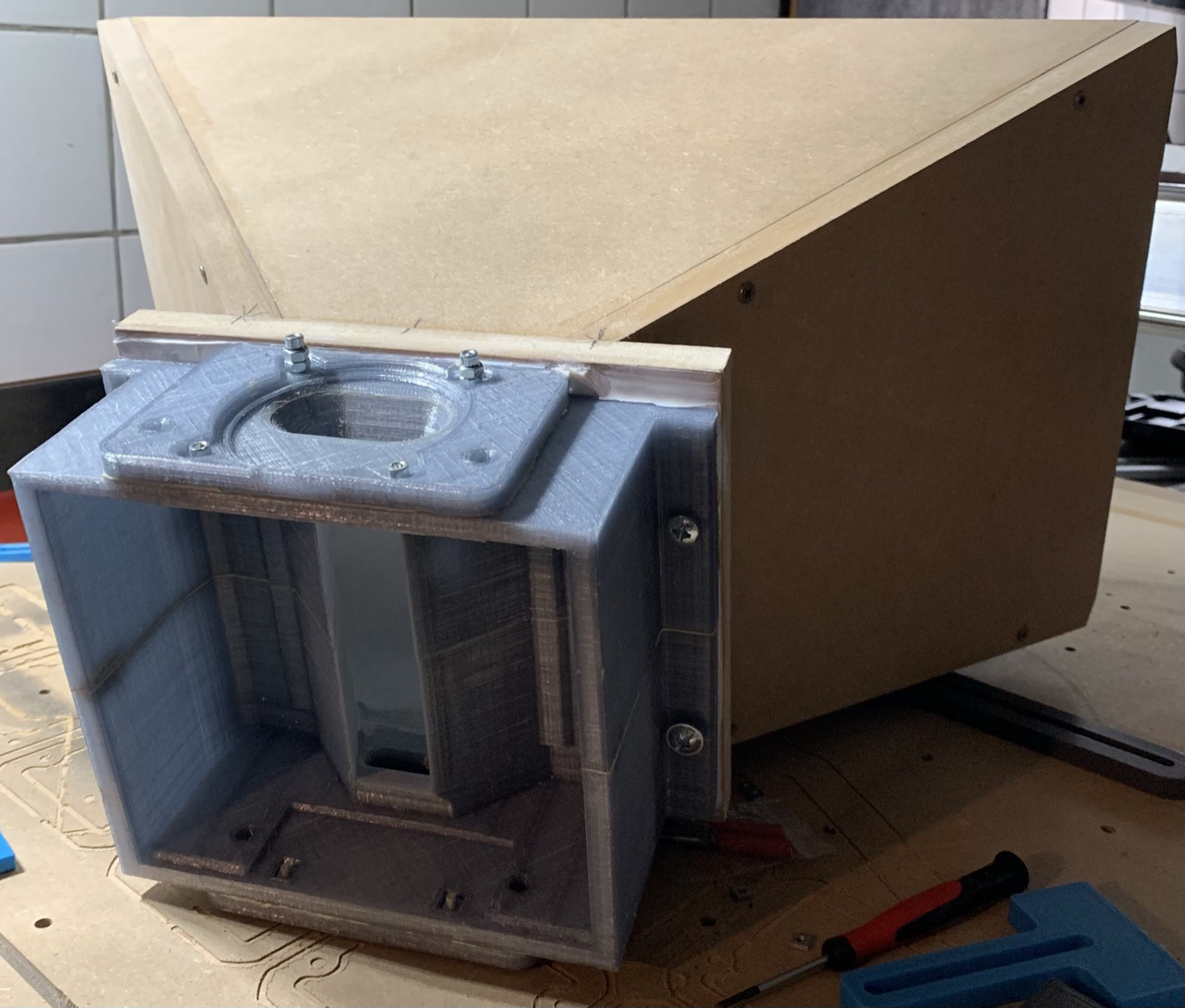

A 3D printed or CNC machined roundover on the front is something I consider to do. Something like 3-4" radius, printed/machined in pieces to account for my building mistakes🙂

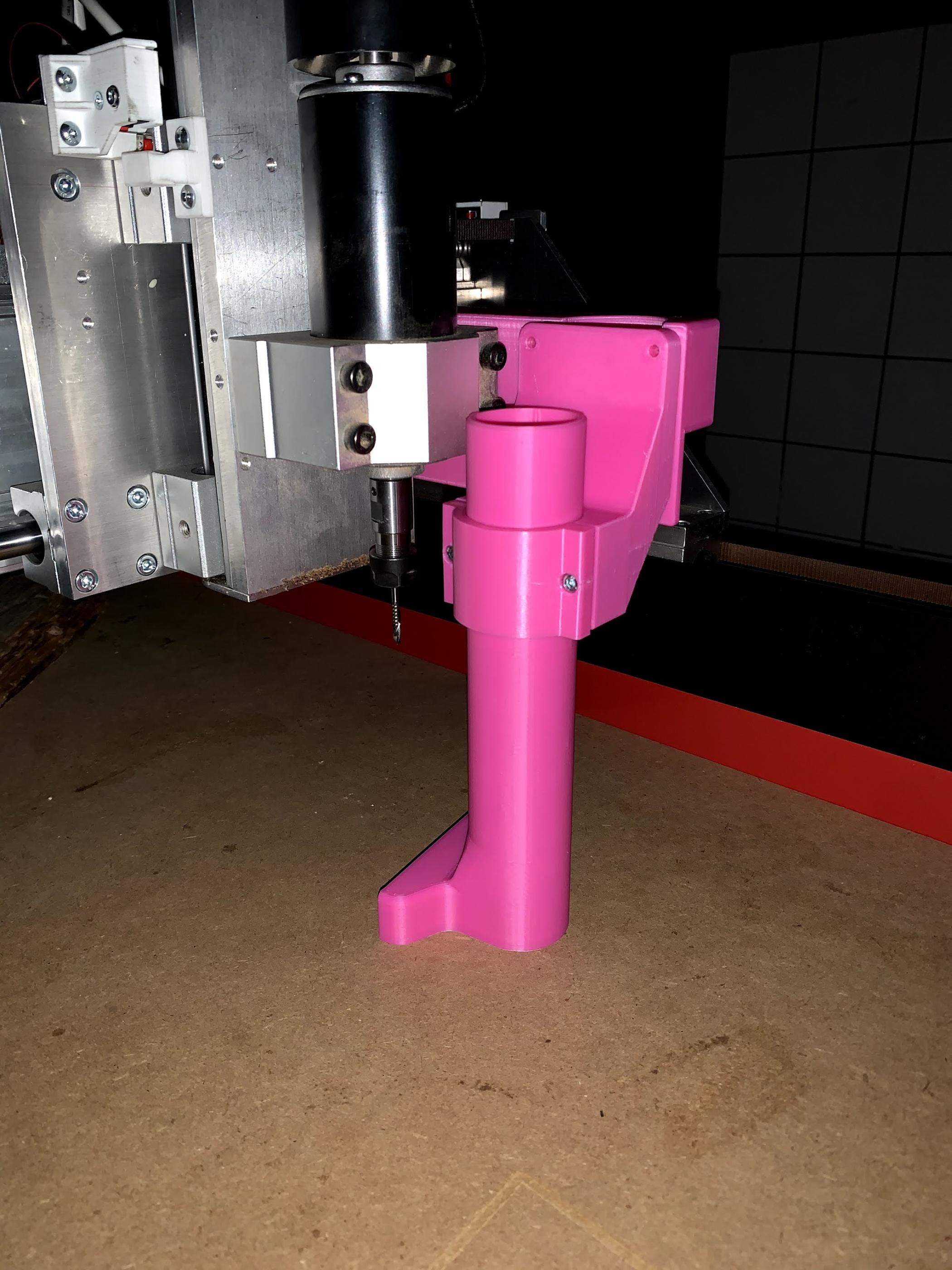

That is why I use a CNC router, I would not be able to do such nice cuts by using power tools🙂 Going for a business trip tomorrow, but I hope to install the drivers next weekend.

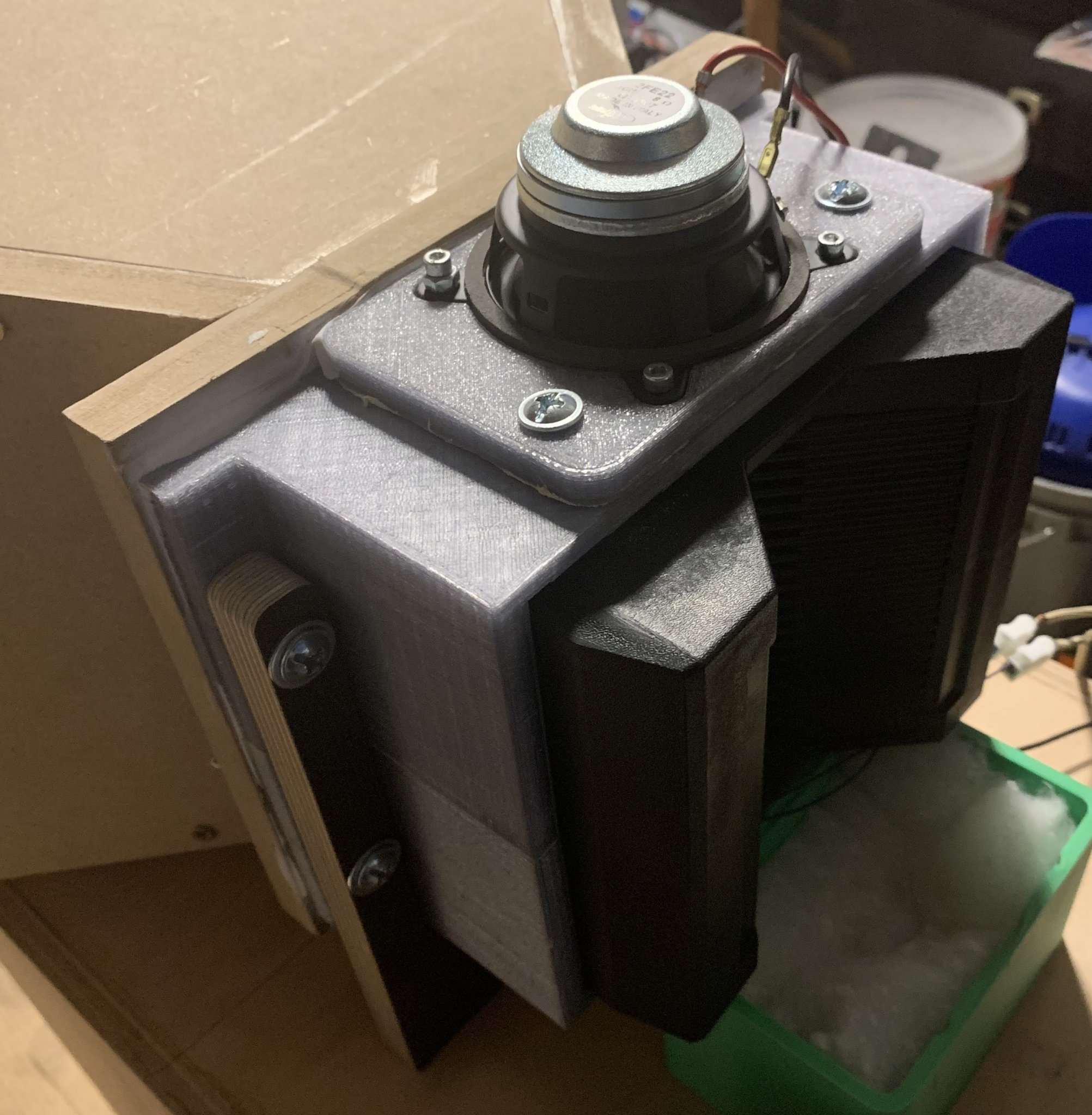

Drivers installed. Some foam tape was used to seal the connection between AMT and the printed part. It is only a temporary mount, so 4 M6 bolts are holding it against compressed foam tape at the moment🙂 I hope to do some first measurements without any back chambers this afternoon.

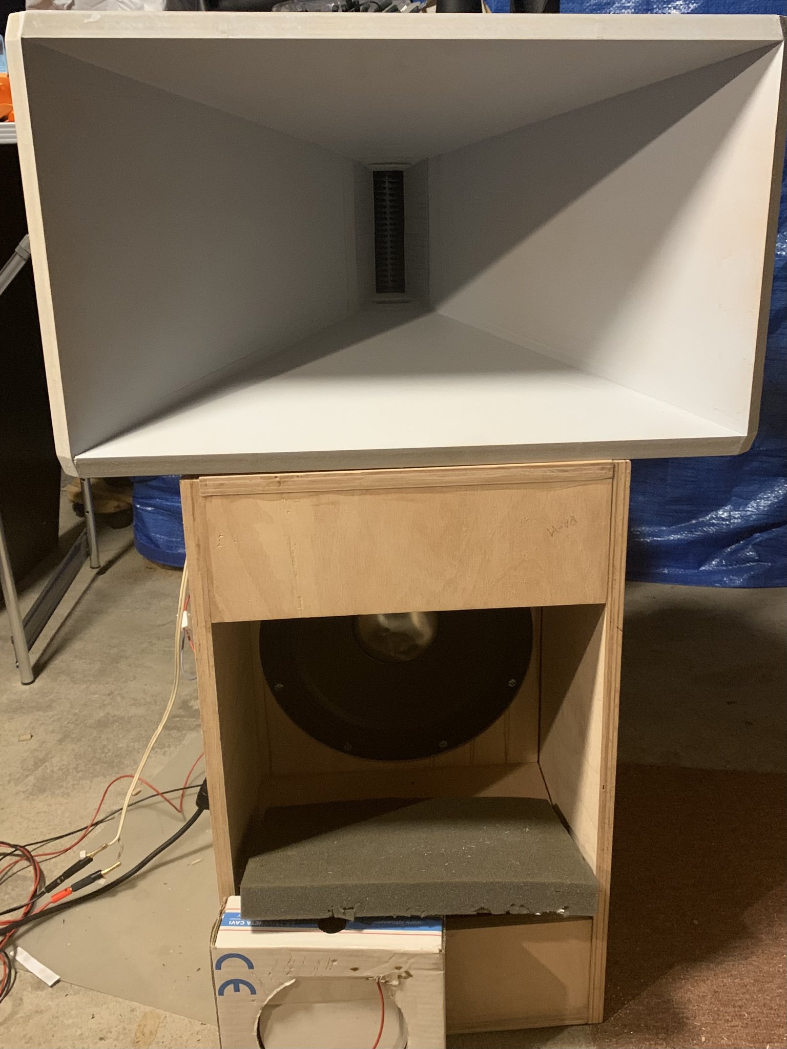

It took longer than expected, but it's alive now! I tried just some really quick setup 3FE22s in series, crossover at 1 kHz but it could go anywhere between 600 Hz and 1.2 kHz. The large Heils are really something special. The test was with open backs on all drivers and with my Paraflex kickbin below, which was not even properly time aligned. I must say wow. The horn works really well within its coverage pattern, the sound is really detailed compared to my SPL Runt inspired synergy horn (the DE500 being a weak point of it). The only thing I am not fully happy with is the narrow vertical coverage, but that is given by the size of the AMT I think. Making the horn wider vertically would not help much. I can learn to live with that 🙂
Now I need to create rear enclosures, since these will be placed close to a wall. The AMT will most probably get a 3D printed pyramid style box with polyfil, in total it should have same depth as the paraflex.
The AMT is basically flat with a gentle rolloff above 11 kHz and there will be a little EQ needed for the mids. The crossover will also need some work and proper measurements outside.
SPL wise it can do more than I am comfortable with, the details are there no matter how soft/loud I play.
I am so happy with the results that I consider a full redesign with 4NDF34s, I think even a single one would do. The new design would integrate the plastic and wooden part better and would also make mounting back enclosures easier.

I think this is the most impressive Heil application I’ve seen thus far. Can you share a few more details? How low does this multiple entry horn go using the 3FE22’s? What are the mouth dimensions? Have you managed to take further measurements?
