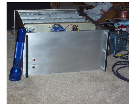

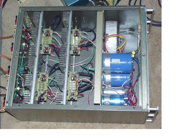

Just wanted to let everyone know I just got an ESP 8 channel! project 19 amp up and running. All channels are fxnal though I have not fully given all of them a workout yet. Soon...ah yes...soon. Though its kind tough to work out 8 channels! (I really don't know why I built an amp with 8 channels...I figured ...ah...heck...why not!) Sounds good...I'll try to post real listening impressions soon when I have more time. (oh, and pics too )

The specs are...800 va avel lindberg torroidal...35a bridge rectifier...and 35,000uF capacitance...bypassed.
No I didn't make the pcb's myself...they are from ESP
sound.westhost.com
Really high quality...definitely recommend Elliot...he's awesome. The amp worked right from the getgo. Amazing!!! all 8 channels ...kick tail!!

ok...more details...but only a few
Rail voltage is under 35v...the transformer is 25-0-25 ....so realistically I'm looking at 33 volts or so. The caps are mostly Sprague powerlytics...from surplus stuff that I had to form slowly on a variac. They work quite nicely actually. Hmm...what else. Silver solder throughout...etc. etc. blah blah.

well...hm...I'd use a 2kva transformer...if you want all those channels driven...or 2 x 1kva transformers. All of my inputs are independent...and intended for use w/ home theater. My yamaha receiver has pre outs for all the channels (5.1) which is really nice. Good stuff anyway. I used some heatsinks that steve@apexjr has (6.95 or so per)
www.apexjr.com I think they are TO-3 heatsinks that a friend cut in half. Each half is used for one proj. 19 board (2 channels - 2 chips...one chip per channel) I think they are quite adequate actually.

Also, some listening impressions of the amp. If I REALLY push it it can get ugly....but I really don't need to push it too much to get it PLENTY loud. It really is an impressive 50+ watts. :-D The sound is much better, more accurate, less sloppy than my yamaha receiver (which claims 100 watts continuous). Very clear and accurate. :-D
Onto a p3a soon! hmm...how many channels for this one?
