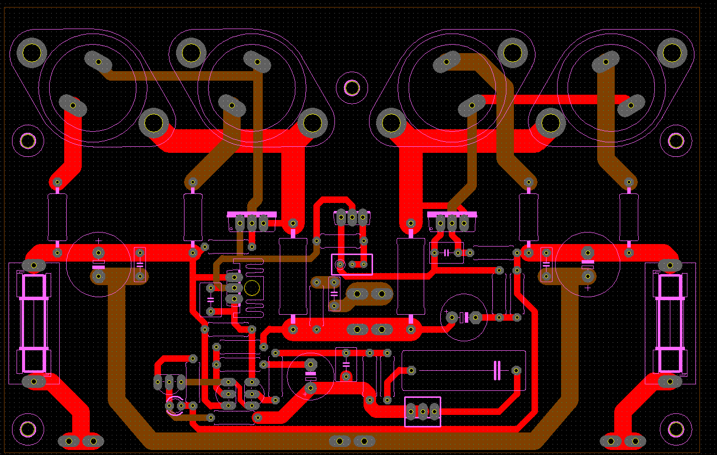

Took the previous version, rearranged a few components, added a 4.7uF cap again and switched from single to dual output pairs, for extreme situations when driving 4 Ohm loads and with enough power to drive atleast a resistive load down to 2 Ohm without trouble.
The amp PCB's have been ordered, now the waiting game begins.
Hmm, does it really matter that much?
But switching places with the 2 x 470uF electrolytes is easy enough.
Edit : Done.

I would be really interested to know HOW you doubled the outputs. With CFPsit should not be as trivial as with EFs. Did you double the drivers as well? Did you add emitter resistors on the power devices? Did you put base stoppers? Just some question that arise...PCB's are on their way from China. Should be here sometime end of the week/early next week. I hope so anyway.

I have already received my first PCB's, however Im already considering other options, like a P3A with 2 x pairs of TO-3 transistors.
Like the attached picture.
Ill most likely use my current PCB's but one can always consider future versions.

Emitter resistors, yes, they have been added.
It is done as recommended by the designer, Rod Elliott.

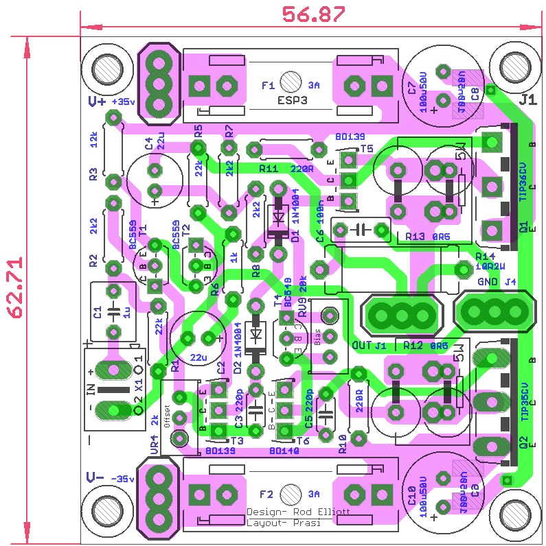

hi all,
i have made a layout for ESP P3 (not P3A), trying to minimize the size with mostly through hole components. the smd cap is optional as per the ESP website.
pl remove this post if this is not allowed.
prasi

the above link doesnt seem to be working... here is the link again.
High Quality 60 Watt Power Amplifier
- ESP P3A
