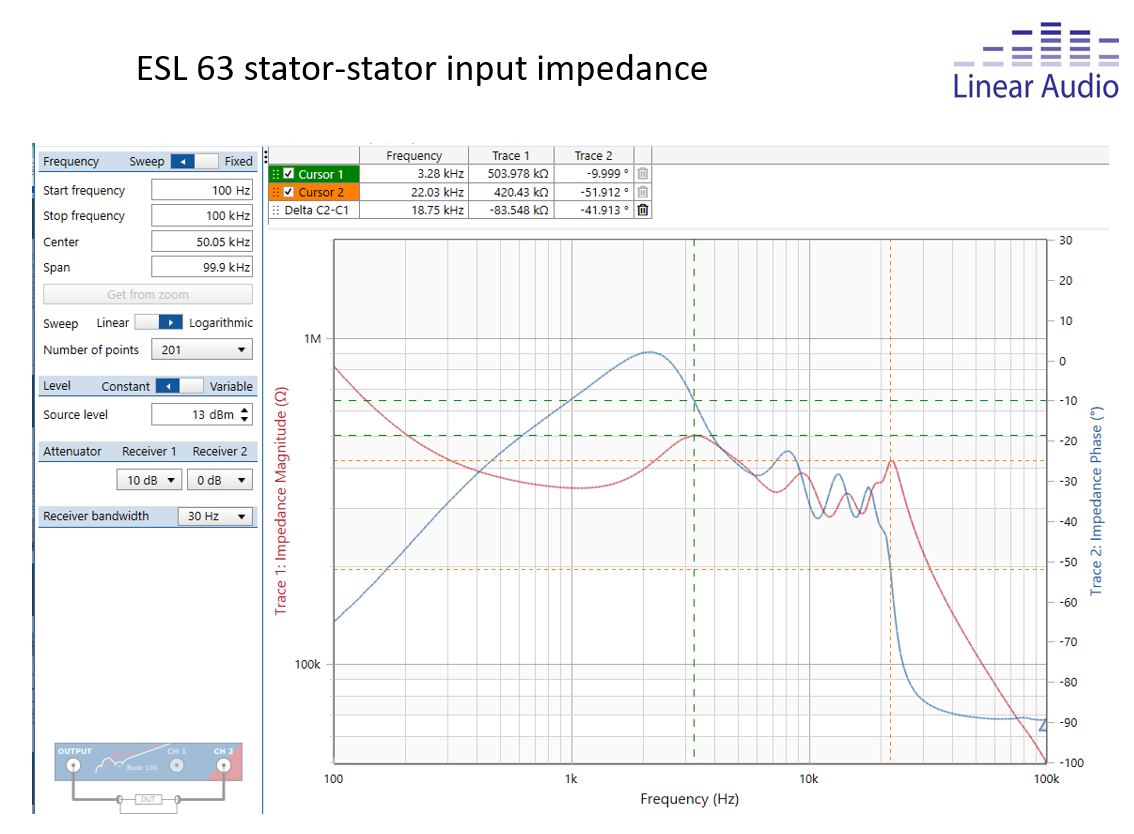

Measured at the secondaries of the step up xformers, with the transformers disconnected.
Jan

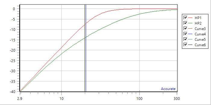

Take 40x40x40 ripole. Fit it with two 12-inch Peerless XXLS P830845 with SD=493, Xmax=30mm, fs=29Hz, Qts=0.65, and SPL_1W=86.6dB. This driver with it's rather highish Q is very well suited for open baffles/ripoles-and-the-like.
Resorting to the Linkwitz data. D=40cm for shortest front-to-back acoustical shunt. At 20Hz and for the ripole on the floor (+6dB) you get a volume-displacement limited max. SPL of 90dB (which is 20dB less than for a non-dipole setup with the same drivers).
Now take into account the driver's Qts=0.7 and resonance fs=29Hz. For a HP filter of Fs=29Hz and Q=0.7 the attenuation at 20Hz is around -7dB (voltage, not power). So finally you get less than 80dB/W sensitivity at 20Hz. So, for listening at moderate levels, this Ripole will do it's job along a 60W amplifier. At 20Hz, max. SPL cannot exceed 90dB anyway. This comes at a stout +- 15mm breathing of both driver's membranes, nota bene.
As mentionned before, these numbers are for Qts=0.7 (red graph). The gren graph instead shows the result with the same driver data except for a more power hungy Qts 0.3. My XXLS drivers had a bit less volume-displacement capacity and, most annoying, an open-baffle-desastrous Qts of 0.25. And the W-housings were minimally dimensioned. These facts might have contributed to my personal mix-blessed OB-Sub experience.

Did you measure the source impedance of the transformers as well? They are part of the equation for the total transfer curves.
With transformers I expect the level will have quite a noticable effect as well.

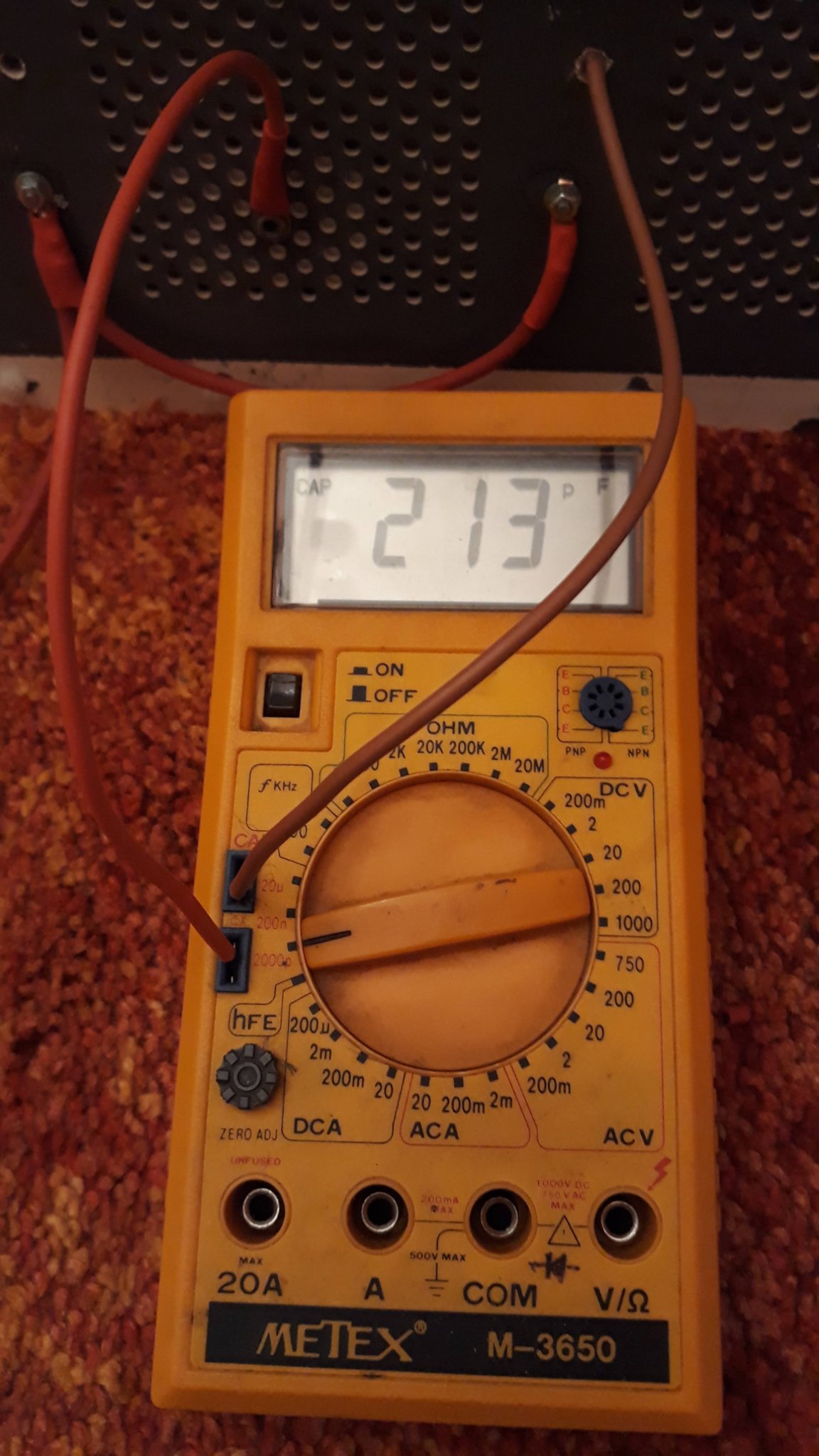

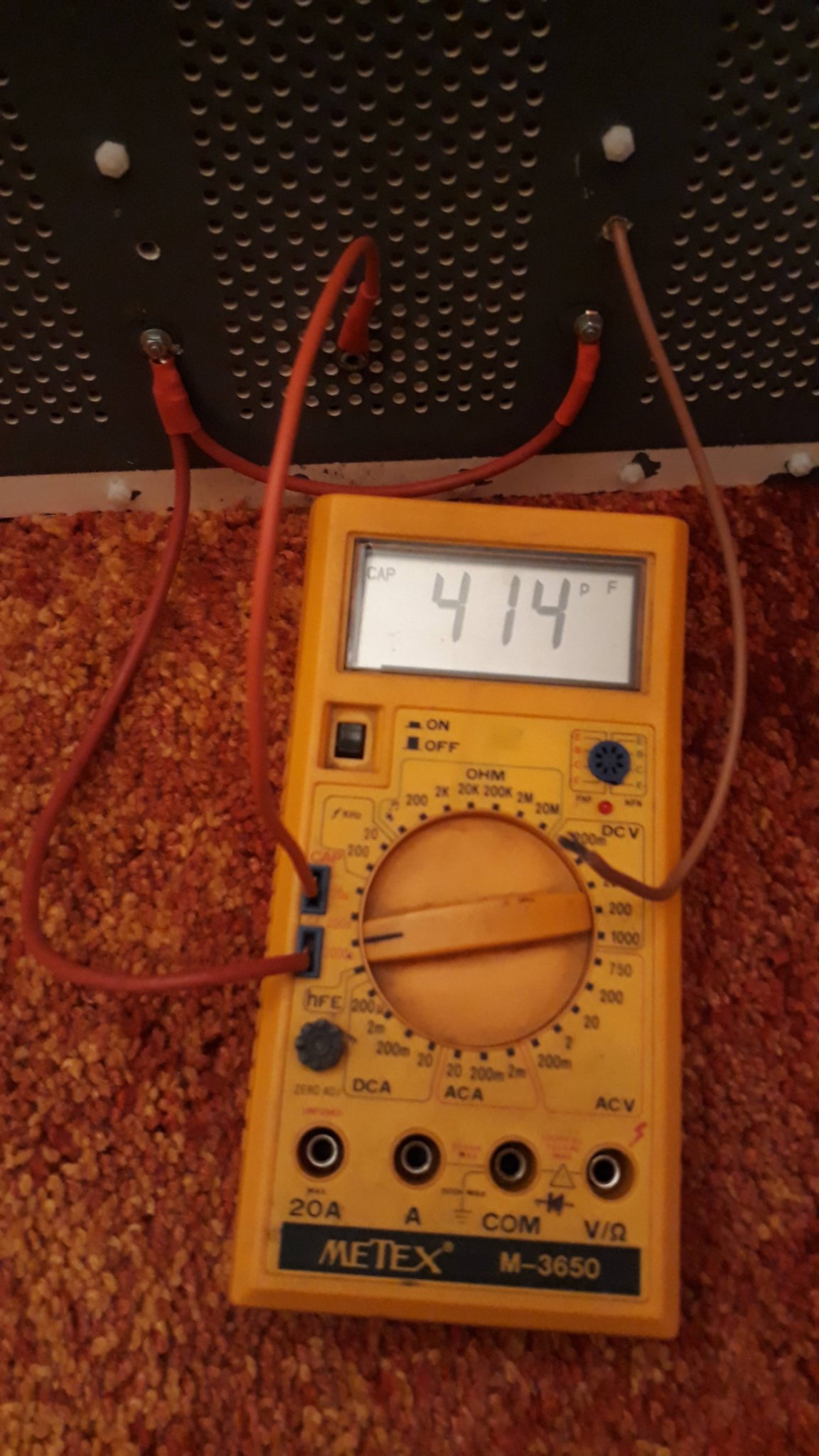

This is the rear stator to diaphragm capacitance on an ESL (57) bass panel. Front stator to diaphragm is the same, so total is double. And there are two bass panels parallel, total is quadruple = 1660 pF.
