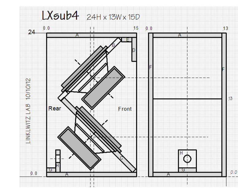

ESL57 - how much sub does it really need?
I'm building a pair of Linkwitz LX open baffle subs to complement the ESL63's.

3 high quality 10" woofers will work
If you do not demand earshattering levels and you use them for music, not home cinema, even less will do.
I have dipole subs with only one 12 inch driver per channel, in a modified H-frame. There is plenty of headroom for home use, and they are EQ'd down to 25 Hz.
I have these subs for over 20 years now, first with ESL57, later ESL63 and now Audiostatics. I did never measure max SPL of the system exactly but 95dB with all kinds of music is no problem for sure and that is quite loud in a home setting. More than I need anyway.
The driver is the (now obsolete) Peerless XLS12. Linkwitz used them in the past as well , I think in the Phoenix. Linear Xmax of a whopping 25 mm and 40 mm mechanical limit, that helps.

I've tested several woofers over the past few years. My preliminary finding is that if you can get away with a larger woofer like a single 15" do so. With a high efficiency 15" less excursion is necessary to produce equal volume (to move the same amount of air) compared with a 10". It's also a more efficient design in all regards -- a single large magnet moving a larger cone... For near field distance small woofers of 6"-10" are preferable as a smaller cone produces a more focused sound. The Visaton W200 and the Seas are excellent choices.
Any listening at over 10' and at reasonable volume 10" woofers become problematic in my experience. As is observed and reflected in linkwitzs LX521 subwoofer enclosure design, the increased excursion necessitated by smaller 10" woofers to achieve volume results in reflections, room interaction and ultimately a greater degree of audible resonances. In other words, a less excursive a woofer achieving equal output at a given frequency will produce less room and or enclosure related resonances due do to lower amplitude and more diffuse wave propagation. On the other hand, if listening in single point location, within a certain volume range, the focus of a smaller woofer may be advantageous.
One design which could potentially mitigate the issue of room reflection presented by smaller subwoofers is to design an open baffle bass enclosure where the rear of the woofer points toward the ceiling, or slightly canted forward toward the listener, in a compact curved folded horn of a ~45 degree radius where the front of the cone fires down and then forward out of the front of the enclosure towards the listener. The advantage here is that rather than dealing with rear wall reflections, one is afforded much more flexible positioning having presumably at least +8' of distance between the ~floor and ceiling for the woofer to dissipate its rear wave energy.
I have an Seas 10" LROY woofer on hand to experiment with. It's certainly an impressive design being powerful at 4ohms and ~18Bl. It's composed at high output as it is pistonic, has a robust cone and is thus low distortion. The heavy cone and voice coil is a limiting factor. Compared with a 55mms cone 98db sensitivity 15" woofer that I have on hand the Seas does not achieve equivalent speed and transient response. If using the the Seas for just sub bass frequencies, say 30/40hz and below, at normal listening levels, the Seas is maybe a better choice. For a more conventional approach of an 80hz crossover point, which is substantially different from 30hz, a low mass 15" is a far better choice. In other words, as a supplementary woofer with the Quads 57s or any other electrostat, I would look to a large driver with a light cone.
If low volume near field listening at a low crossover frequency is the plan then the Seas would be a good choice. Other brands that produce a similar product are Visaton, Wavecore, Faital Pro, and SB Acoustic//Audience, which seems to have reissued some of Peerless's older drivers.
I did never measure max SPL of the system exactly but 95dB with all kinds of music is no problem for sure.
ESL eventually means constantly struggling for and with the bass response. Make your choice ...
Assuming
-Sd = 550 cm^2
- Xmax = 25mm
Then in free air, dipole max. SPL will be
78dB @ 25Hz
87dB @ 35Hz
96dB @ 50Hz
  • The H-frame and in case of d=250mm accounts for +4dB
  • The sub may (?) be placed on the floor: +6dB
So finally you get
88dB @ 25Hz
97dB @ 35Hz
106dB @ 50Hz
This is simulations. And it looks nice. In real life instead, as alway you will have to deal with annoying multifactor facts. As for me and in my "very best" time, I had 8 of these Peerless XXLS-12inch drivers built within 4 W-typed dipole enclosures. Despite the sheer overkill aspect of this setup, I did not really like the overall result when matched with ESL's. Sure, with all this volume displacement, I got some sub. I got sub in terms of frequency range, of course. But also sub in terms of overall rendition quality. Because of ESL's work in their's own class.
1. At Xmax = 25mm at low frequencies these Peerless drivers produced a lot (!) of wind and mechanical noise. This might be more or less the case for any driver, as Linwitz found out, this driver type having been one of the most suited in his experiments. Therefore, the real max. usable SPL is substantially lower if you do want rather to listen to clean bass than to the driver's noise and air turbulences. And so also the benefit as a deep frequency extender for an ESL will be lower than suggested by the raw Sd/Xmax-related SPL numbers.
2. Be aware that any addition of a magnetodynamic driver to an ESL will come along with two basically different transient response types. A light planar mylar membrane will not have the same dynamic and transient behavior than a heavy and complex bass cone assembly moving. Drive is finite ... This will mishmash any transient and/or phase response. So best for a coherent and deeper/louder bass response is not addding a dynamic driver, but might be addding a lot of ESP aera dedicated for bass instead. Your might place an extra bass-extending pair of ESL assemblies closer to your listening position, much closer than the main ESL stereo speaker pair for best SPL and least room modes stimulation.
3. Be aware, that especially for dipoles and for lower frequencies, the emmitted acoustical power is strongly related to the placement near walls. "Lower" relates to the ratio of wavelenght to boundary-dipole distance. Best compromize is an angle of 45° related to the next wall. Therefore, avoid having a dipole sub neatly orientated towards the listener for best results.
And now for the ESL57's need for sub? I would say none, or nearly none. You would not need much more bass potential along with an ESL57 (I also owned a pair of these). You basically need none, if you like to "simply" enjoy audio at home at reasonable levels. In this case, you will be fine with most of the available audio materials. But you will definitely not be able to show off a androgens-loaded TAIKO session in it's full fury dynamic to your stunned and jealous audio friends. No. Not even with a stacked pair of 4 ESL57s.
Actually, I listen to a sub-less pair of Quad63. I prefer the sublimely precise overall rendering to a belly-punching bass experience. If I really had the urge for more bass, then I would go, as mentionned above, for a pair of auxiliary bass ESL panels on both sides of my listening position. In any case I would avoid trying to match my ESLs with magnetodynamic subs. No more. "Match" comes closely before "mess" in my diytionary.
... And as for the Taiko-Session, I would better go to the concert hall. Even with a supersub, taiko may remain subsub.
