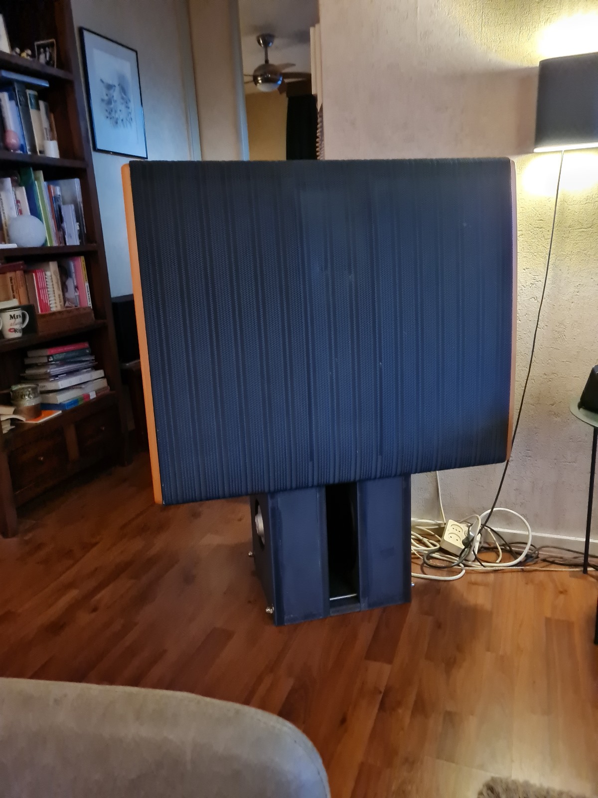

In my case, I went for 2x12" Ripole subs. And they make for nice stands for the ESL's too:

In my case, I have crossed over at 70Hz because 1) the ESLs do reach down to 50Hz but that's with a lot of effort and the Ripoles have no trouble there, also I didn't want to cross too high because I want to avoid the nasty resonance the Ripoles have around 150-200Hz.
I'm really very satisfied with this combination, it is as if the ESLs reach down effortlessly to 30Hz and below, while they still do their "disappearing act" in the sweet spot with a good recording.
I've used a miniDSP 2x4HD as crossover, the ESLs are powered by a Quad 303 and the subwoofers by an XTZ Class-AP100.

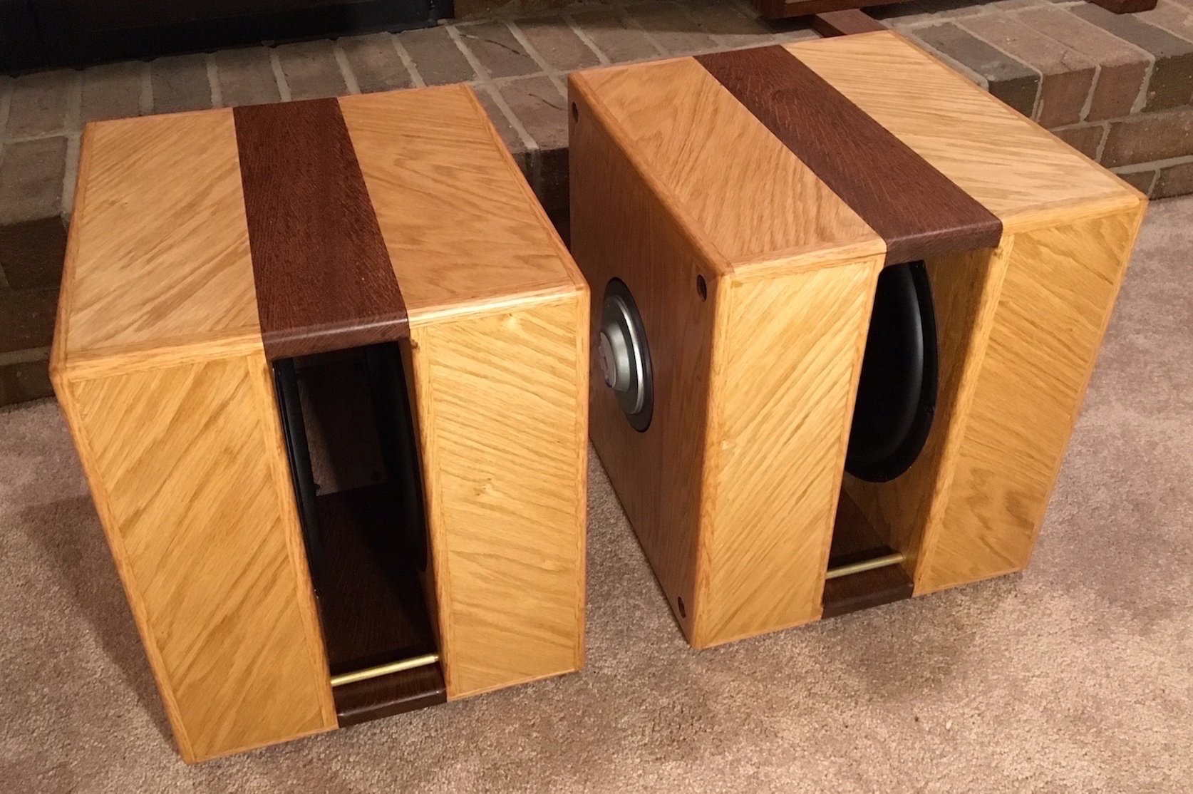

I use and recommend a pair of RiPol subs. My ESLs are homebuilt hybrids but a full-range ESL like the Quad 57 would benefit even more.
Also, I would use a DSP crossover and chop the 57's off sharply at around 80Hz or higher. The 57's play lower but much of the low bass you hear from a full range ESL is the diaphragm's drum-head resonance, which sounds bassy but it's peaky and mostly distortion.
Chopping the 57's off sharply above 80Hz would elminate much of the drum-head resonance and replace it with clean bass from the sub(s).
I highly recommend a pair of 12" RiPol subs, which are dipolar (cardiod, actually) but you would have to build them yourself unless you wanted to spring for the Modal Akustic commercial version from Germany, which is quite expensive.
I'll be happy to give you my CAD drawings and a parts list for a pair of these 12" RiPol subs:

In the above picture, the subs are about 15 1/2" high (39cm and a little because I put felt "feet" under them). For a normal sitting height on the couch, about 3,5 meters from between the speakers "ear height" is about 3/4 of the ESL. Mind you, the ESL's are then almost vertical. Basically I took off the little stands and sat the ESL's on top of the subs.
The original idea was for them to emulate a window from the balcony looking out over the orchestra. For modern use, it is said Peter Walker recommended to "put them on a beer crate".
I really don't think I could get any better response than this.

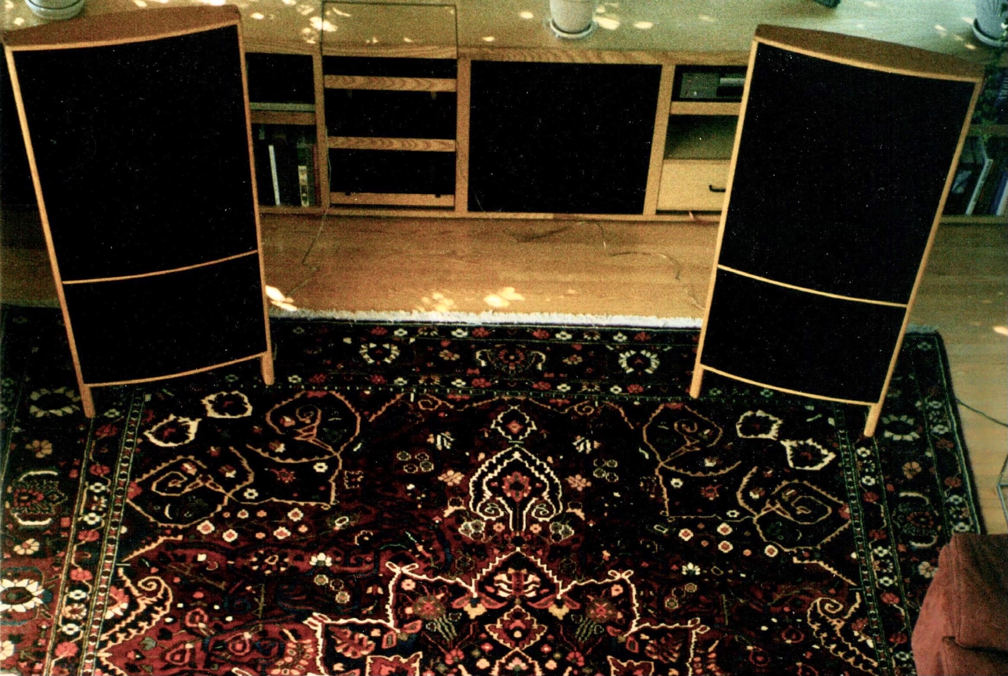

Just another alternative solution to the limited bass of the Quad 57. I bought a beat up pair of Acoustic Research (AR) 3 speakers years ago and mated them to my Quad 57s. Surprisingly, the width of the ARs was approximately the same as the Quads if you redesign the stands for the Quads which is not difficult to do. I ended up with the Quads spectacular midrange and very deep integrated bass. I crossed over at 100Hz with a passive electronic device between my preamp and amplifiers ( 12db/octave) . The ARs were American built in the 1960s so they may not be available in the UK but alternatives may exist at a low price on the used market. Have fun!!
