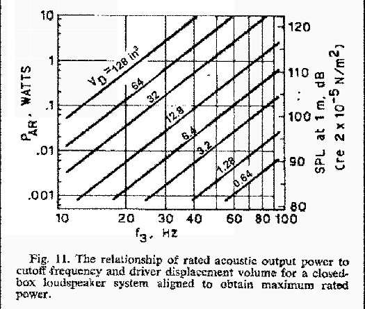

A 15" woofer with a useful excursion of say 5mm can move 0.57 liters of air (please check my math). An ESL with 1m^2 area and say 2mm excursion can theoretically move 2 liters of air.
Since an ESL is supported at the edges and does not exhibit pistonic movement the amount of air moved is going to less than theoretical , say only 1 liter. This is still more than a regular woofer so in my opinion displacement is not the issue, the front/back cancellation is.
When a sub-woofer can move 10mm it is just equal to an ESL. with respect to air movement. A regular sub does have the advantage of a larger force.

Yes I agree,
It is because of the front to back cancelations it takes much more displacement to make up the difference of that of a single driver in a monopole configuration can produce.
It is not really on issue of how low can you get it to go,But how loud for a given size.
For instance some examples of the 8' tall Acoustats can do the low frequencys rather well as there is alot of surface area.
But it was also stated that a subwoofer is still sometimes used as well.

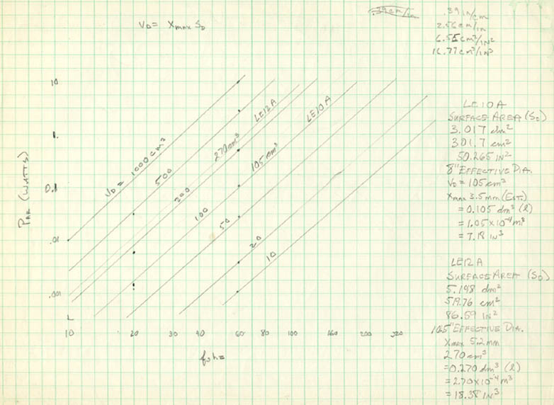

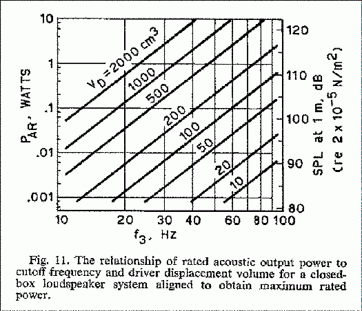

Here are a few charts that I found while digging around in some old threads the other night that may be of some use.
And a zip file of two Linkwitz Labs Excel spreadsheets that I find most useful for determining ESL sizes and Dipole vs Monopole displacement per frequency and maximum SPL

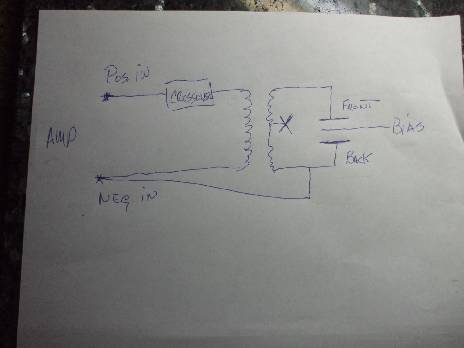

I have 4-5 of the Acoustat Base tranfourmers here.....an what i have found that if i just run them on panels with just 1-2ohms on the pos input an dont use the center tap on the panels side an gound the back side of the panel an one end of the winding an use the other end of the winding to drive the front of the panels it not as eze to saturate. Have you ever setup you xfourmers this way...if not why?
Thanks for your time...
On paper it looks that way....but
Forgive the Art....i have posted this in the past..i came across this with ML in 96....
An got in touch with Mr powers At ML to get more info and a schematic...
an when i got the schematic it was as you see in all there schematic... the nom. setup with the centap grounded....an one end of the winding going to the back an one going to the front of the panels..just like all ESL i had ever seen...Acoustats,Soundlab,so....i called to see what was up an was told that thay had came up with this setup to sale in UK...thay had to ground, well the neg input from the amp to the front panel...Safty.. thay even ran two wires from the same place to the same place...what i siad..thay have some panels with 4 wires... an two run to the front ....well i got to looking at the set an siad just what you have... can be right... but it work an whin i took out the setup an put in the one on the schematic from ML...i lost output??
so whin i put the SE I call it... setup back in with the back panel gronded not the front i got even more output....so then i move on to my Acoustats an it did the same thing .....;sound great an gave more output....so thin i move on to my soundLabs A3s an got the thing...great sound an more output....so i pass this on to Moray....an he look at it an tride it an it workt for him all so...
So i gess that as we no, the paper is not right all the time...
I think it helps with the mismach in the tranfourmers windings...an it stops a fulx back an forth that come with the back of the panel that has no bias feed coting...all i can say is after trying it bouth ways ...i alway endup here At whats in the art... give it a try...you can always go back!....an i have never found any one that thinks more output out of a ESL is a bad thing...
To me how it sounds is the same way a SE tube amp sounds vris a pushpull
faster an sweeter....just one mans o-pine
Thanks for your time an all years of info on esl you have given
