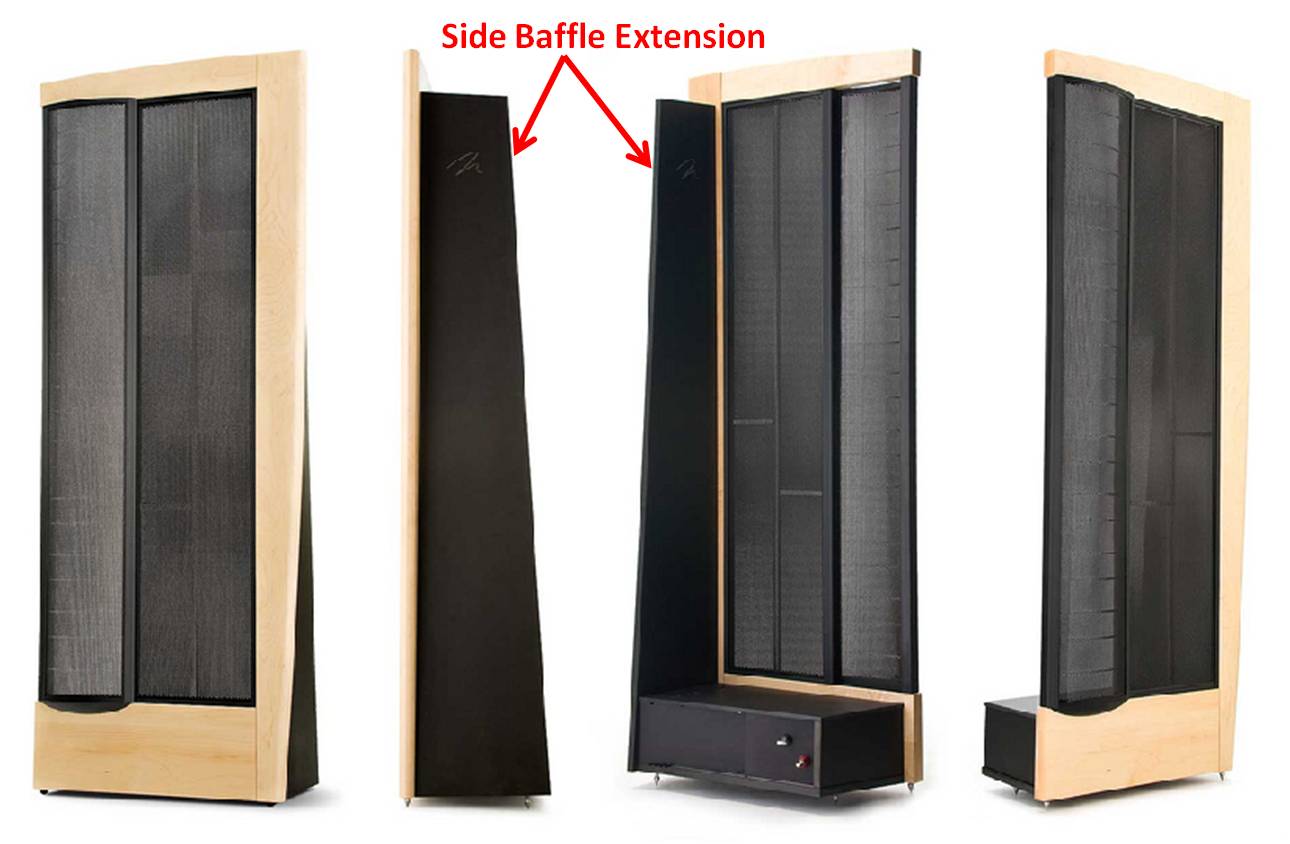

In general acoustic foam is not very affective at absorbing low frequencies, below about 300 Hz.
To block the out of phase bass from the rear of the ESL you pretty much have to use a physical barrier.
For their full range model Martin Logan adds a large baffle extension on the side nearest the bass panels to increase the bass output.
Adding an additional baffle extension on the other side of the panel would have increased the bass output further,
but the response and radiation pattern of the curved mid-treble panel would be adversely affected.
Also, with two large side baffle extensions, a cavity would be formed behind the panels which would potentially add an undesirable cavity resonance.

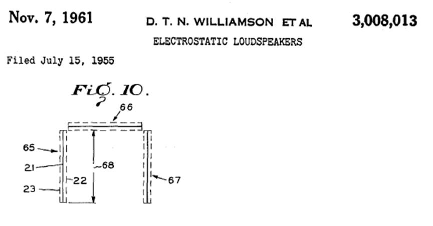

One other possibility was mentioned in the Williamson-Walker US patent 3008013:
Replace the baffle extensions with active ESL panels that are only driven at low frequencies where the phase cancellation is most problematic.
At higher frequencies, these panels will be essentially acoustically transparent so they will not induce a cavity resonance or adversely affect the mid-treble response.
