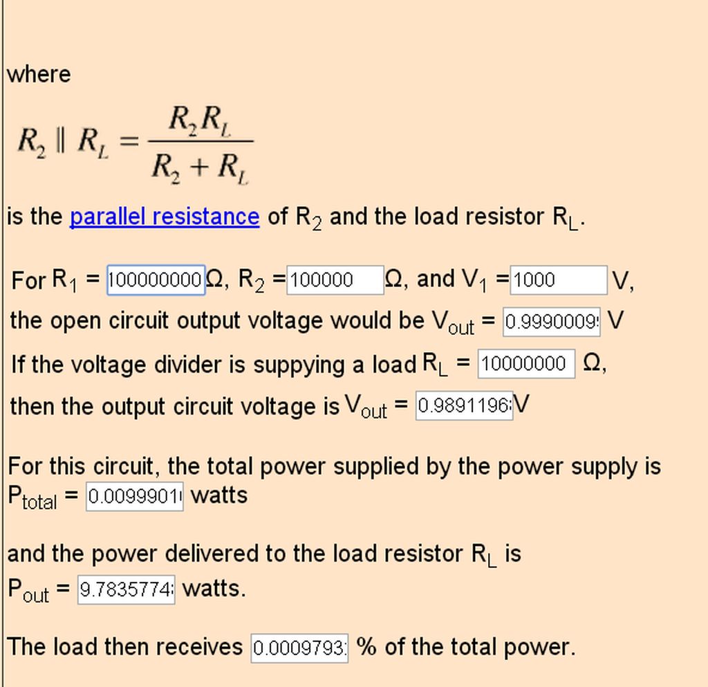

That is a method that I would not suggest to use if you value your meter.
Also just because the meters spec sheet may indicate it's input resistance or impedance is X, you have no proof of exactly what value it really is, it is just a generalization and it could be off by as much as 5 or 10 percent if not more.
In this example for a voltage divider total of 100meg (actually 100.1meg) and a bottom resistor of 100K, A meter with a 10Meg input resistance shows error of only 1% due to the loading of the meter across the bottom 100K resistor.
Voltage Divider
This is not bad and much safer for your meter at 1V per 1000V displayed.
I use a 10k or 20k multi-turn trimmer pot included on the bottom as well to calibrate it to more exact scale as well.
You can probably also get away with skipping the opamp buffer if your meter that has that high of an input impedance.
The nice thing is that some opamp's have an input resistance has high a 1Gohm and higher, Some do not you must check for this in the spec sheet of the opamp you may be trying to use.
Mine are not that high at about 200k to 2 meg for my DMM's.
For an analog meter you will need to use a buffer to keep it accurate or use a trimmer to calibrate it, most are typically 20k or less.
The calculator above is a great tool for finding the right values of resistance to use.
In this example Ptotal is .00999 watts and 9.7835e-08 watts to the RLoad so don't be alarmed by the value in the screenshot.
Cheers!!
jer 🙂

Using a 10M for the final grounding resistor keeps the testing point voltage low.
It also allows easy calculation for the loading effect of the 10M meter probe.
45M +10M gives an effective 45M +5M for a 10:1 reduction using the 10M meter. But more suitable for measurements < 2kV
Alternatively you could use 1M1 for the lowest resistor.
Then 99M + 1M1 gives an effective 99M + 1M for a 100:1 reduction using a 10M meter.

The lower you make your Bottom grounded resistor the lower your testing voltage is of course but also the lower it is compared to the input resistance of your meter the lesser percentage amount of error you will have from the loading of RL(aka Meter)
If you have a a 10meg for the bottom resistor and your meter as a 10meg input resistance(or impedance) then your bottom resistor is now effectively 5meg and this will give you half of the voltage reading that you would be expecting.
The ratio of the bottom resistor and your meters input resistance will give what margin of error to expect as follows (Bottom resistance/Meter resistance)*100=margin of error in %.
In the above example (100,000 ohms /10,000,000 ohms)*100= 1% error as shown by the calculator in the screenshot.
If your bottom resistor was 10k then your margin of error would only be .1% with the same meter, and for 1Kv this would only be 10v of error per 1Kv .

No and No.The lower you make your Bottom grounded resistor the lower your testing voltage is of course but also the lower it is compared to the input resistance of your meter the lesser percentage amount of error you will have from the loading of RL(aka Meter)
If you have a a 10meg for the bottom resistor and your meter as a 10meg input resistance(or impedance) then your bottom resistor is now effectively 5meg and this will give you half of the voltage reading that you would be expecting..............
You must know your loading effect on the circuit being tested.
You calculate the effect of the loading.
I gave two alternatives that use the known loading effect.
Then showed what the results are. There is virtually no "error".
Using the 10M lower resistor parallel to the 10M meter, gives an effective 5M for the lower resistor.
There is no 50% error.
If the 10M resistor is +-1% and the meter impedance is +-5% then the combination is 5M +-2.96%
Use that with 45M +-1% for the upper resistor string and the divide ratio is 10:1 +-<4%
And with selection of the resistors using a couple of DMM that can measure 5M & 10M resistors, by comparison, you can get a divide by 10 ratio much closer to +-0.5%.
Then use your Hamon divider in a Wheatstone Bridge to check how good your ratio has turned out to be. With care you can get <<1% and maybe approach 0.01%
You are left with the meter accuracy as the only significant error in the measurement result.
Yes, you are correct Andrew I didn't read or post properly, as have been up all night now working on learning some C.
I do apologize for my mistake.
I got to thinking about my example and I used a generalization and I do like to be exact.
Leaving out the ratio of the top resistor makes a big difference as well as not using the proper formula for the parallel resistance for the bottom two combined resistances.
It is late for me and I thank you for pointing that out for me.
Sorry for the confusion.
My math is good but I forget to think out complete formula's now and then, mostly from laziness of having to try and type them out and make them look right and understandable in the forum.
But it is no excuse for my sloppiness and is why I rely on online calculators anymore. 😉 He,he,he!!
