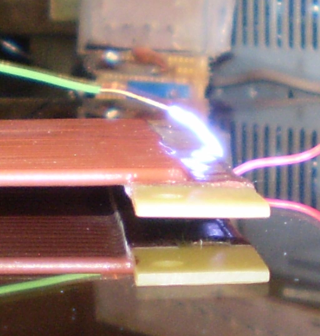

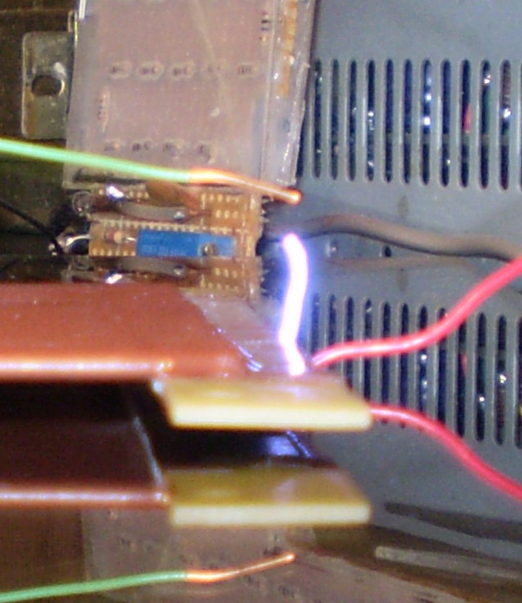

First the output of the HV is quite close to the LV circuits and feedback components for 7kv.
Wasn't sure of the best way to handle that. I used 1812 size resistors, but the user may need to cut and remove the PCB trace between sections connected to the lower voltage outputs. Was trying to keep the project small by not using large thru-hole parts. Also, the voltage multiplier only needs to be populated as far as the highest voltage tap the user wants to utilize.
But, It won't detect any sudden changes from the actual output voltage coming off of the multiplier stage at any of the later taps.
I don't know how you would do this with the LT3751 and the multiple taps on the multiplier and still maintain the same range of adjustment. If you can do a schematic, I can look at plotting it. Most ESLs are hybrids with a Fc of 200-300Hz so they probably don't need regulation at the outputs anyway.
As this is being offered as a DIY project, my bigger concern is whether the user can solder 0603 size components to the PCB. U3 also has a heat sink slug on the underside that needs to be soldered down to the PCB. This would normally require a hot air station to do, but I think I can put a large enough thru-hole centered on the pad that it could be hand soldered from the underside.
The flyback controller is also not a particularly easy circuit to trouble shoot if something is assembled incorrectly.
Geraldjr-
Regarding the HV problem; what if the taps were split into two sections as shown on the new plot. Taps 2x, 4x, 6x & 8x would have 3 resistors that add up to 90M (56/22/12 or 47/33/10) and taps 10x, 12x & 14x would be five 18M resistors.
The other possibility is to cover the 1812 resistors and pads with HV corona dope after everything is installed.

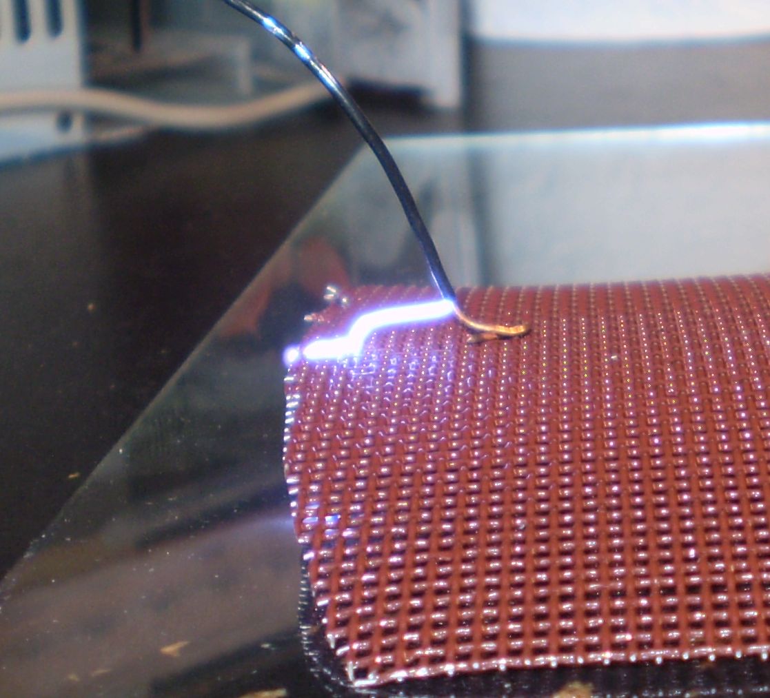

Unfortunately I am not aware of any SMD resistors that are designed with voltage coefficients in the +1kv range, generally this are only available as through hole parts.

The dielectric breakdown of air is ~20kV/inch. At 7kV, it should be ~ .35 inches. All of the copper is coated with LPI solder mask which has a very high breakdown voltage. It shouldn't be a problem, but it probably should be prototyped and tried before releasing it to the public.
In this post I show the arc length for 4.3dkv.
The ruler I was using is graduated in 1/10".
http://www.diyaudio.com/forums/plan...tor-insulation-mylar-coating.html#post2767803
This one is at aprox. 5.3kv,
http://www.diyaudio.com/forums/plan...tor-insulation-mylar-coating.html#post2767712
Although a bit blurry as I moved the camera but you can see just what a 10.32kv arc can jump,
http://www.diyaudio.com/forums/plan...tor-insulation-mylar-coating.html#post2772703
This all coincides with about 3/8 for 7kv or so.
And at a full 14kv it is approximately 3/4" to just under 1" for a good solid arc.
Before it jumps the gap, if the gap is wide enough, the corona fingers are reaching out and they get longer and longer as the gap is shortened until it finally jumps.
Yes, A good coat of conformal coating will help tremendously with this.
I have found that your typical Clear Acrylic Spray Enamel is good for about 1900v per mil or so.
Here are some close ups of this at 14kv, you can tell the distance on my window screen sample as it is common 16/18 holes per inch wire mesh.
jer 🙂
