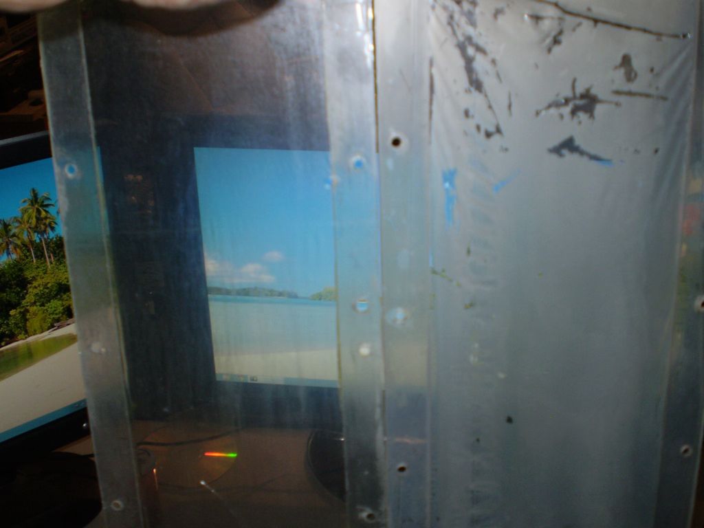

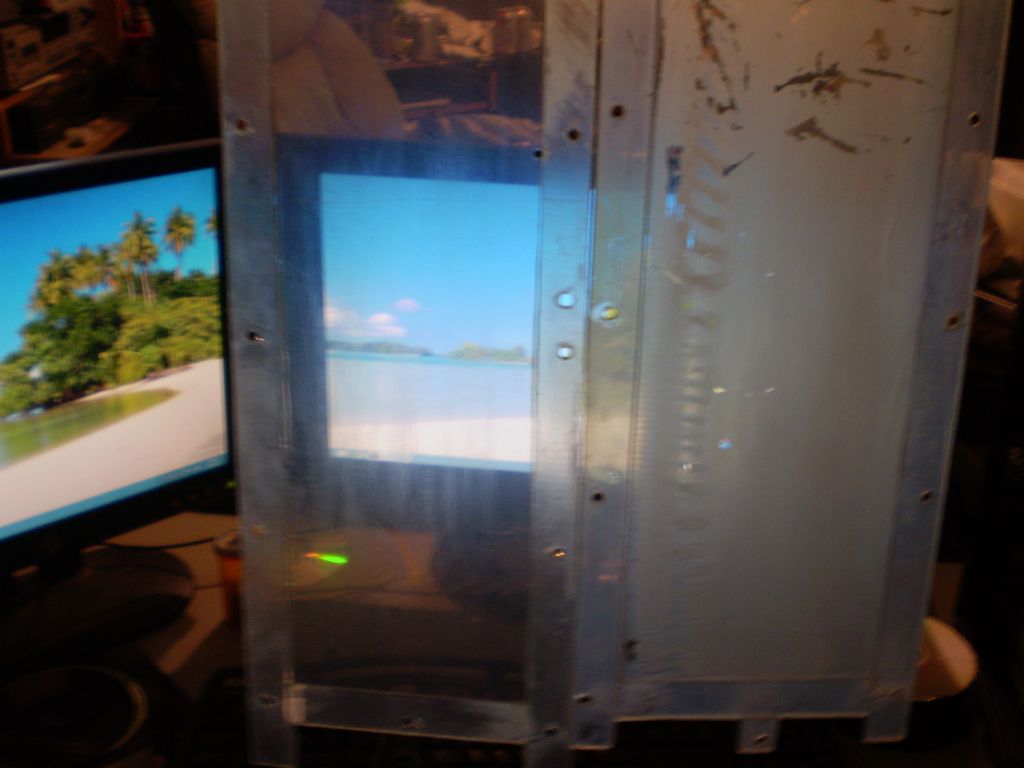

Double coating with a sponge made the membrane quite smoky and it's impossible to get homogenous transparency. The spacer surrounds are uncoated on purpose. I still think it might not be that bad from under the stators, as long as there is no window at the backside (and there won't be due to UV).
I have not tested the coating yet, I hope the sensitivity is fffing great and THD still very low to compensate the loss in aesthetics.
I've never seen Licron crystal look like that.
Was pretty common for the original Licron formula 1755.
Any idea what the humidity was when you applied the coating?
Hi Steve, around 50% says my humidity meter. It was way more transparent after the first (sponge) layer, the second made it much more smoky. I should have tried it after the first coat and then apply more if it was not enough, but too late now.'

Actually it looks about right,
http://www.diyaudio.com/forums/planars-exotics/109789-esl-diaphragm-coating-7.html#post2142822
It is more noticeable do to the refraction of the light.
I have had better aesthetic results as well by just spraying on single coat but it is hardly noticeable once the diagphram is hidden behind the stator.

Here are two shots that I just took of both formulas and you can see the difference.
One is with the flash on and the other is without.
Sorry the one without flash got slightly blurred as the battery in my camera was getting low.

Licron crystal is quite clear winner in aesthetics from those two panels🙂.

I can just imagine how your big panels are going to sound with that thin stuff.
Can't wait to hear your next report about your results.
I'm thinking of when I do rebuild my 8"x22" panels to add a tweeter panel with some of the thin stuff that I have and use a pair of my 8" subs in a dipole configuration for my Nearfield system in front of my mixer.
As it won't be designed to do loud, Just only clean for mix downs.
