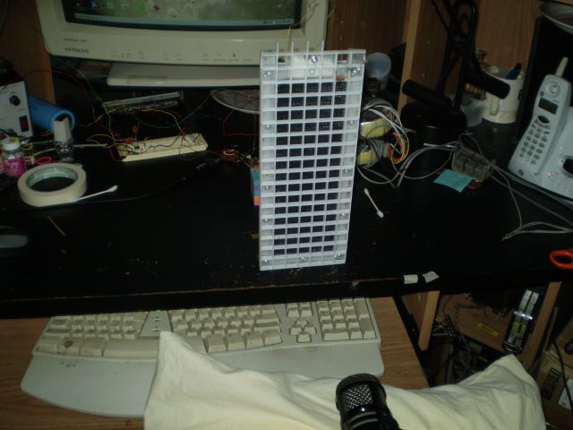

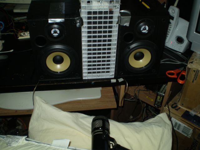

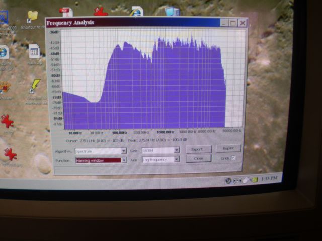

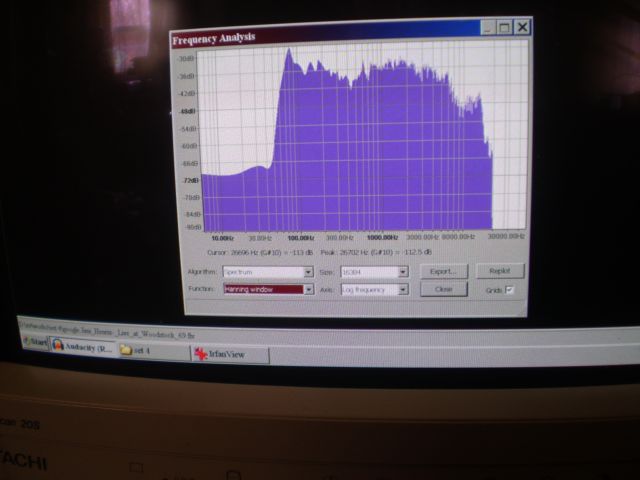

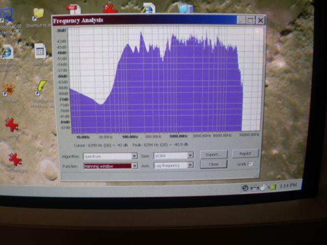

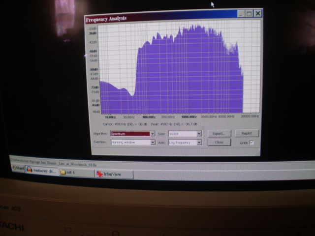

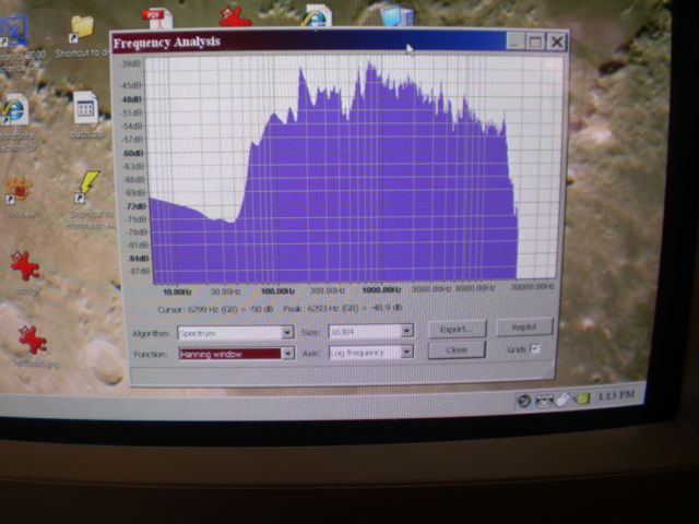

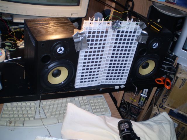

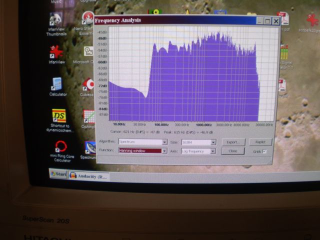

Hi guys,here are some crude frequency response tests I did today.
Since this thread is for coatings ,I will only post these here once so as not clutter up or confuse anyone trying to read this thread.
When I get a more calibrated setup going, I'll start a new thread on the subject.
The main point is that the test do show some improvement on the exterem high end due to the different coatings and/or added thickness's and added mass.
The eq setting that I used was what I preceived to be flat and good sounding by listening to some music at a low comfortable level and not blairingly loud by any circumstance.
And by the results I am not that far off, suprizingly!
The eq settings were as follows 75hz cutoff high pass filter was on at all times to avoid any transformer saturation and amplifier issues.
#1 flat no eq.
#2 around 180hz mid boost at +6db and +9db 12khz highpass shelving.
#3 +9db 12khz highpass shelving.

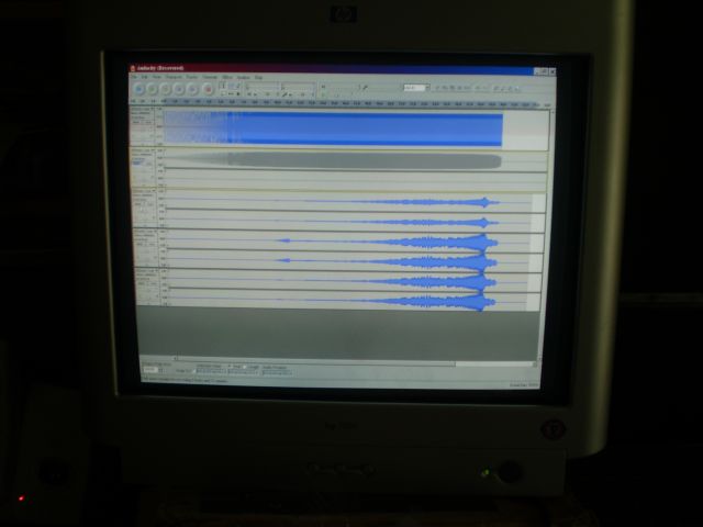

The board picture shows a sample of the integrity of the signals and are as follows.
track #1 test sweep , 4hz to 20khz linear sweep for 30 seconds.
track #2 frequency response ,no eq,straight thru the board to sub master #1 and #2 of 8 into the computer.
I could have used an aux send as it they have a flatter response and don't have any high end drop off,but this is the way I have it setup for now.
track #3 test 1
track #4 test 2
track #5 test 3
The hump in the response in "open no eq" may be that of the micrphone response ,but I am not sure ,as i said these are crude real world tests.
Also the notch at 400hz to 500hz depicted in all of the charts could be refractions of reflections of the monitor and/or cubby holes on my desk.
I once did A test where I tried to elminate them as much as I could with room treatment and came up with a very flat response,I believe I posted that one on another thread.
The measurements were taken 1 foot away and off center about 1/3 up from the bottem and I am not sure what happend to the high end response of both panels depicted in th graphs ,but i asure you the highs were there and they sounded good
Feel free to ask any questions if there is any confusions, enjoy. jer

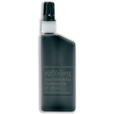

Surely all of them do contain particles but for some reason a lot of inks are made of encapsulated carbon particles, especially the jet printer ones.
Some of them can be diluted by water some by alcohol, some would not dilute in spirits/water.
The one that conducts electricity as described above is "Rotring" and, I assume, should be readily available throughout the Europe.
Again encapsulation in good non-conductive matrix like polyurethane varnish is killing the conductivity. I have failed to check emulsion type urethane lacquer though.
It is based on water and supposedly contains small flakes of aforementioned plastic. Such a structure has to be conductive somewhat like the pva glue, which is porous.
With carbon black added of course.
I have settled down with industrial type intrinsically conductive antistatic coating and not the carbon black mixture. Only time will tell how good this particular coating is.
