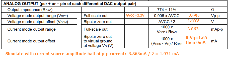

I'm making progress on the design of my I/V stage. I had to pick and choose from the parts thare are currently in stock (which is slim pickings tbh) but so far I have:
LT3471 Boost/Inverter to get +18V and -18V.
TPS7A49 Positive LDO for +18V to +15V
TPS7A30 Negative LDO for -18V to -15V
OPA1612 Dual op-amps
But I'm struggling with a few of the key concepts.

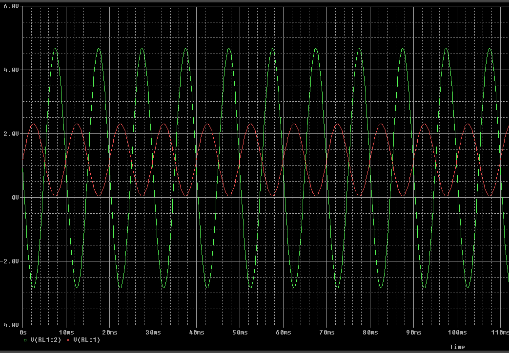

1. Opamp feedback resistor - In the Sabre reference design and application note, the feedback resistor is 2.72K, whereas in most other examples the resistor is around 800 ohm. The 2.72K seems very high and when I model it as such, the output is about 7V peak to peak. With 820 ohm, the output is about 2.25Vp-p. 7V seems very high for line output, even for professional level?
2. The sabre reference design puts a AVCC(3.3V) voltage divider of 10K and 6.34K on the non-inverting input of the op-amp (1.283V) whereas most other designs divide it equally (1.65V). Why the one-third divider as opposed to equal divider?
3 Both biasing options in Question 2 result in the output being offset from circuit ground. What would happen if we simply gave circuit ground to the non-inverting input? Then the waveform would have no DC offset? What are the drawbacks?
3. With regards to the DC offset relative to circuit ground: I don't fully understand balanced audio: Is the ground wire in a balanced audio cable used for anything other than shielding? Meaning if there is a DC offset on Hot and Cold relative to the cable shield/ground, does it matter? Or does the device that takes the balanced audio in create it's own virtual ground?
I'm attaching
- my simulation schematic and the results, with green being the sabre reference design (2720 ohm feedback) and red being most other designs (820 ohm feedback)
- The analog ouput section of the ES9038Q2M datasheet with my calculated values
- The ESS reference design document I keep mentioning.

1. Opamp feedback resistor...
It can affect more than just output voltage. Other things that may be affected include hump distortion, and or other harmonic distortion, and or sensitivity to RF from the dac in terms of whether or not the opamp might try to exceed its slewing capability. Suggest using a combination of measuring and listening to help understand any tradeoffs there may be.
2. The sabre reference design puts a AVCC(3.3V) voltage divider of 10K and 6.34K...
Sometimes lowering the reference voltage helps with hump distortion.
3 Both biasing options in Question 2 result in the output being offset from circuit ground...
One can remove DC offset from the I/V output by appropriate selection of the non-inverting input voltage divider. One may or may not find that dac sounds as good when the opamp is biased that way. Since pots can add distortion, a pot could be used to find the desired division ratio, then the pot could be replaced with fixed resistors before judging distortion results.
