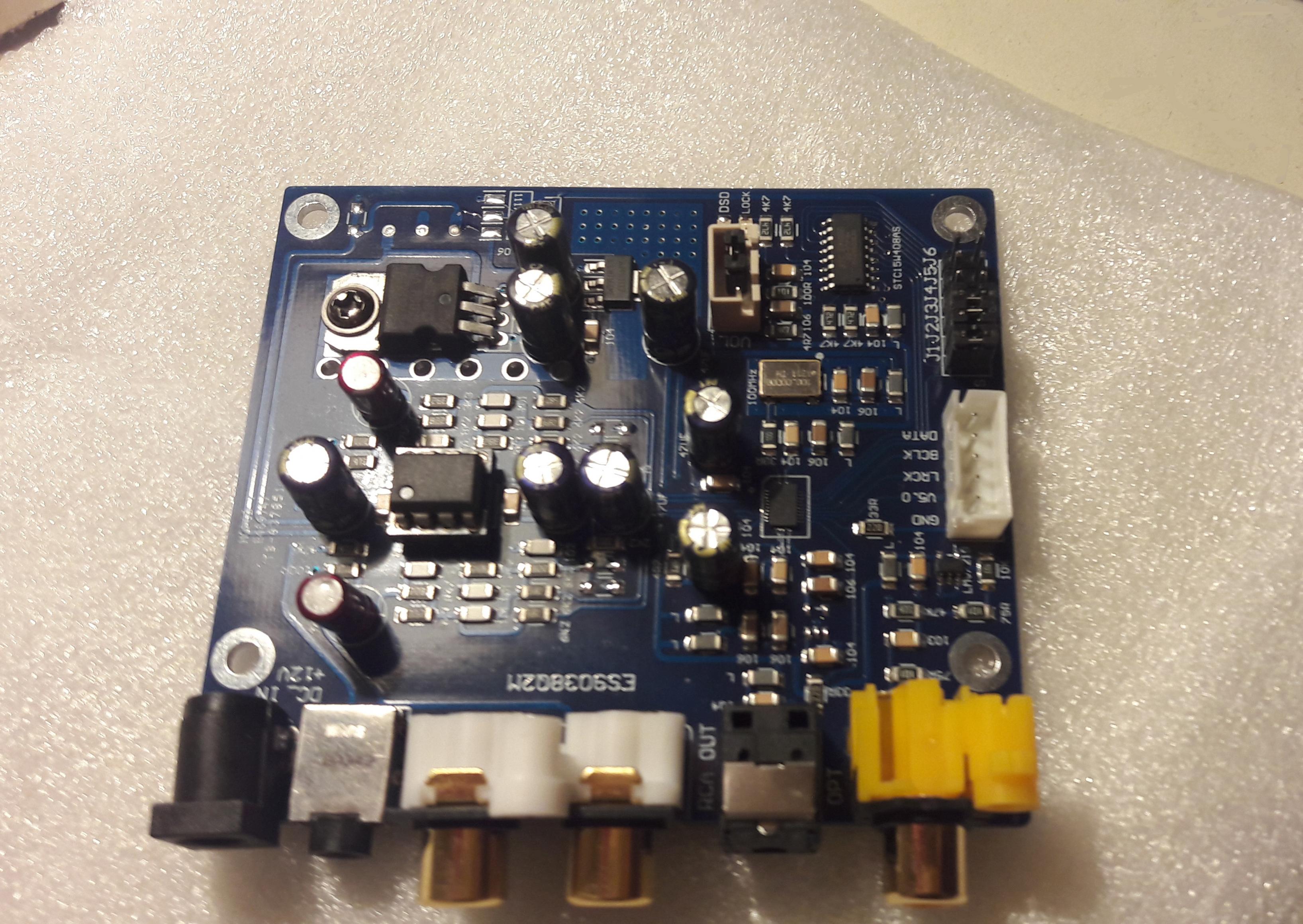

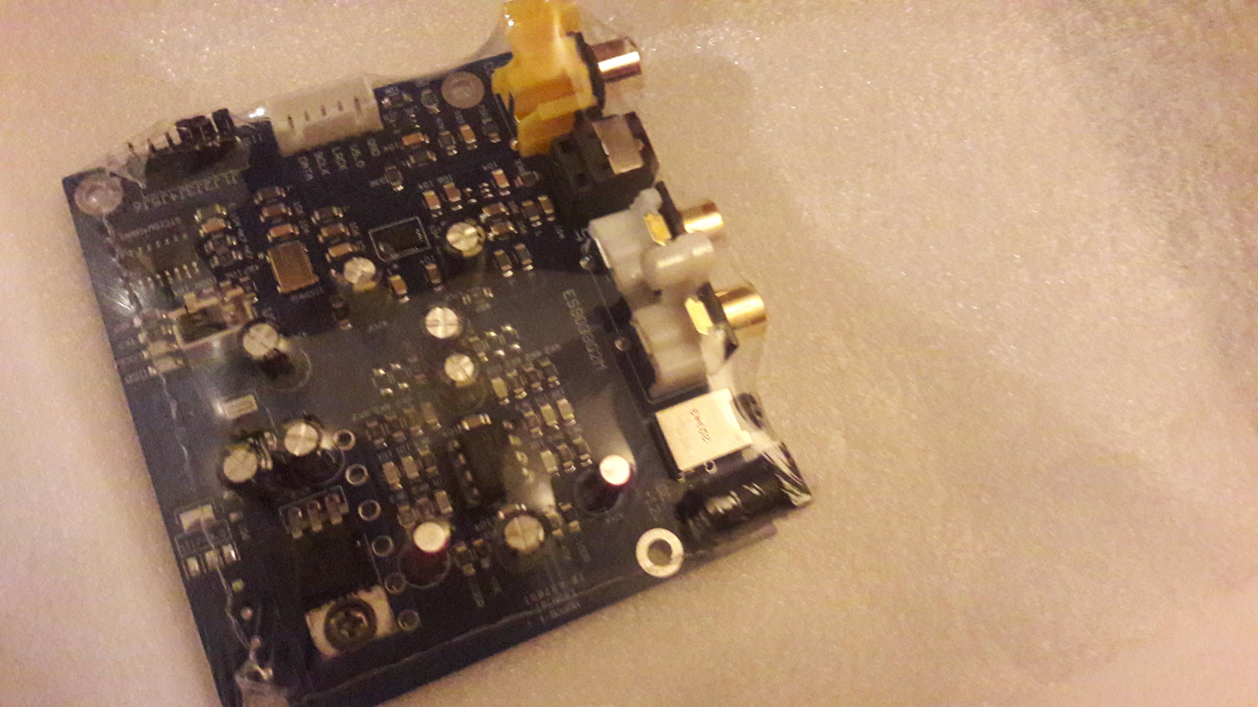

today the ES9038Q2M from taobao/ebay/Kguss arrived, i call it the "blue" one:
for me it sounds absolutely "platy", sounds like plate/sheet..changed immidiately to Muses02; not far better..
i guess it really needs the 15V; have here now 12V (plug)..
something really important is missing; don´t know if its a "crappy"-made pcb or something..
absolute no comparison to my old ES9018K2M and ES9028Q2M-chinese-boards; they sound far more hifi, are superior..
with my Skysong-USB-bridge its almost unbearable and on a Pi (via I2S) it sounds better; less problems/hassle..
(okay, this is "whining" at a high level, but nevertheless)
wrote my experiences so far also here->ES9038Q2M: just arrived, first impressions.. – ES Sabre-90xx-Rpi

yes, thx a lot for asking !!
its from Taobao->Guangzhou Yuan Jing Electronics Co., Ltd.
->YJ-ES9038 Q2M I2S DSD ?? ??????? DAC-???
meanwhile i think its really because of a very poor made pcb..
the pcb is very thin and light (the "old" ones (green) are double the thickness..))
by that the components on it are very "small", less quality i think (excuse me for my bad english, i´m not a native speaker)..
anyway, absolutely not to compare with the "green" ,older, ones..

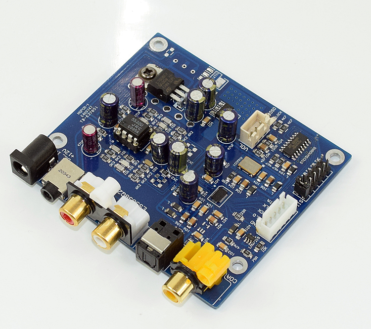

there were also some green ES9038Q2M from audiophonics or ebay for example..ESS ES9038Q2M I2S DAC Module Board 32bit 384khz Balanced DSD 1x LT1963 Regulators - Audiophonics
they seem to have other components on it (hope of more quality)..
i guess i´ll buy maybe some of them to cross-check it with my blue ES9038Q2M here; because here its sounds really like sheet/plate (okay for normal user they sound maybe "okay"), but for me its absolutely no hifi anymore..

yes, i would also say the green SMP (CP) could be a better choice..Audiophonics with their 50€ ES9038Q2M seems also to had that green SMP (CB)-version..To be on the safe side, I think I'll stick with the green SMP board (I am looking to buy one soon).

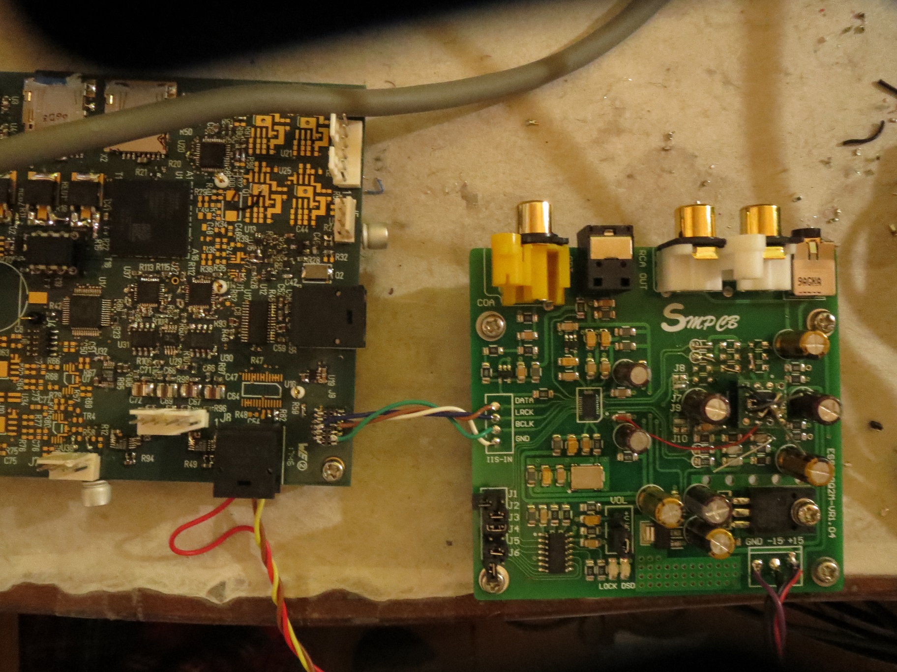

I have "old" one 1.04 version, powered by Kubota Power suplly +-15V, Rpi3 + KaliReclocker is powered by Ifi Power plug supply 5V, honestly amount od details (high middles and overall highs) and soundstage is much better by this DAC9038q2m than ES9023 from Mambo or 9028q2m from audiophonics, but also too much present of high middles sometimes cover rest of spectrum and maybe it seems that sound dynamics is missing...with good quality of record it is better solution, but poor recorder metal or rock or another music can caused feeling that this dac is not good...but it is cheap board so what can we expect more...

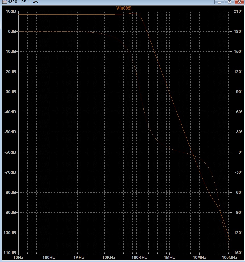

Attached how LPF Buffer looks like.
It seems, if i did not make calculation mistake or mistake by measuring, that
capacitors are only 11 a 22pf and cut off frequency then should be around 1.4Mhz which is too high, if new caps would be 100 and 220pf and rezistors remained so new freq. would be around 140khz which should be OK for 9038q2m, so i will try to remove smd caps and replace by 2.5mm pitch wima FKP, maybe i will make my own simple PCB as the replacement of current analog stage and will cut off directly onto pcb from DAC out signal before input rezistors 6.2k, also would like then to replace opamp by HDAM discrete board or discrete HDAM op amp which will be newly mounted on "new" experimental board....can anybody also check if caps are only 11 and 22pf ? so small capacitors are hard to measure onto desc...or why there is so high cut off LPF freq, can anybody explain (only if i didnt make mistake) ??

I measured the registers and capacitors of my board (Ver 1.04 green). The registers are same as your data, but the capacitors are not same. Your 22p is 330p and 10p is 100p like the attached. I changed JRC5532 to AD4898-2 with a differential current mode to measure the performance in DSD. The board has very excellent numbers for the price. IMD is especially incredible compared to another DAC chips I have ever measured. I have no comment about SQ because I don't have an environment to listen to the board.
Sorry I mistook the schematics. My schematics of #172 is the copy of Ver 1.04 board except for AD4898-2. I measured the board by the schematics of post #73 with AD4898-2.

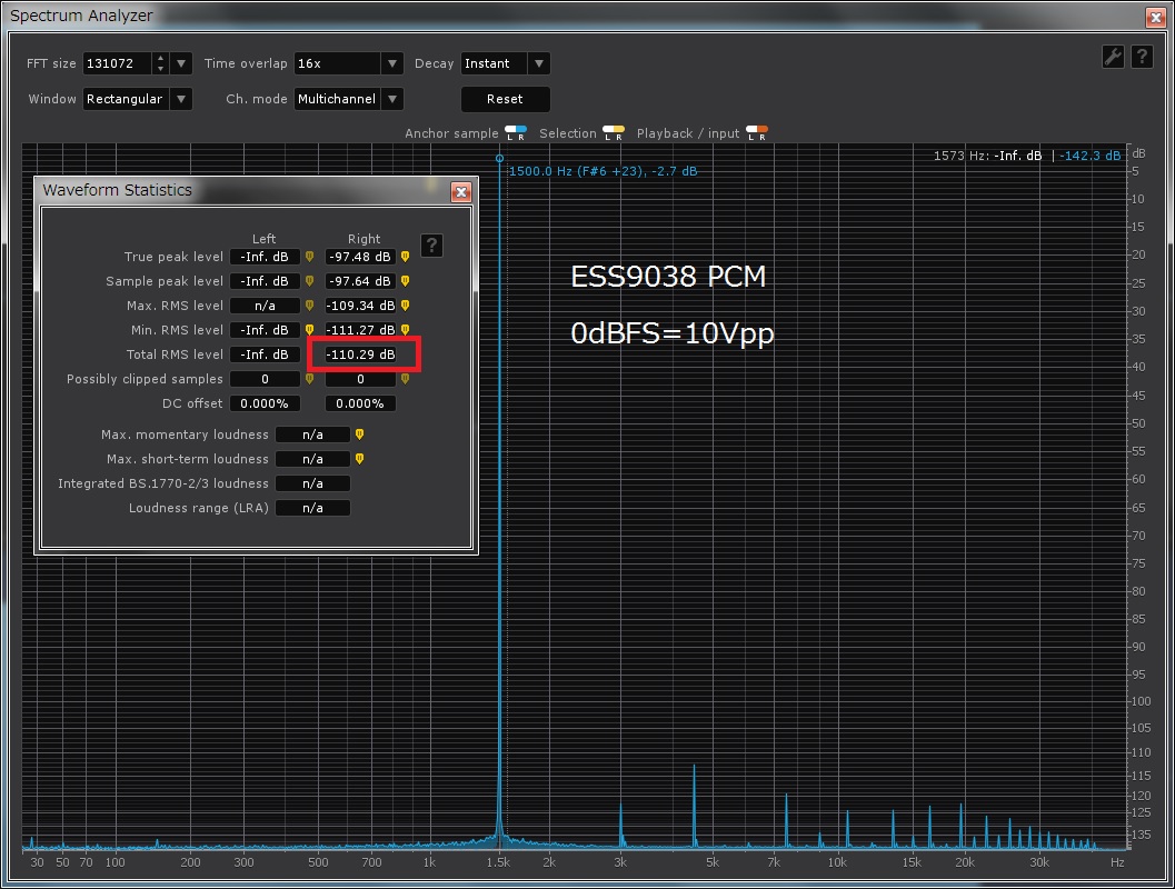

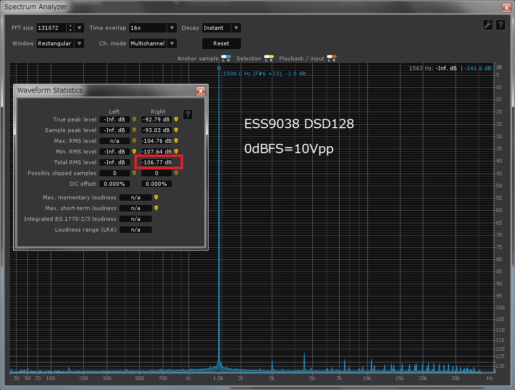

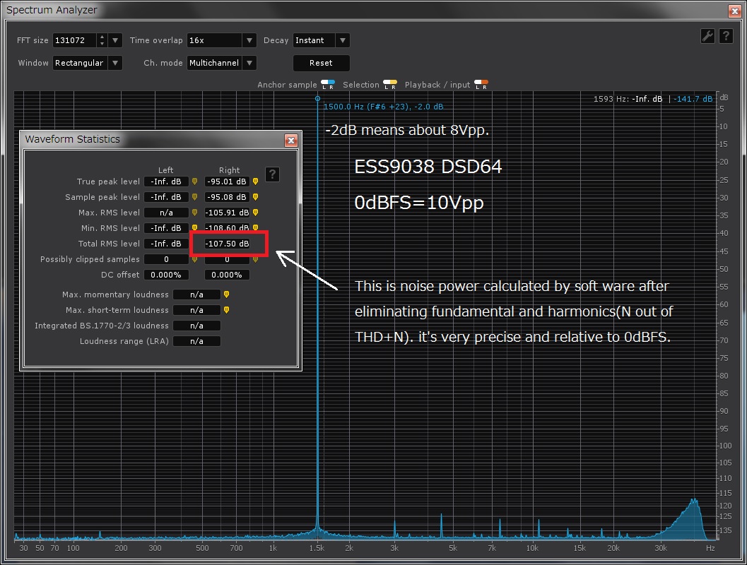

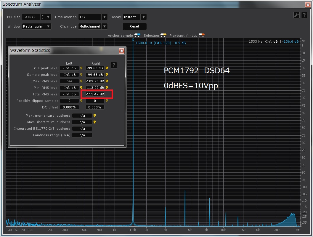

The attached are my measured data about ESS9038 Ver1.04 board with AD4898-2 current mode differential output and pcm1792 for reference because a relative comparison is more understandable than absolute data.

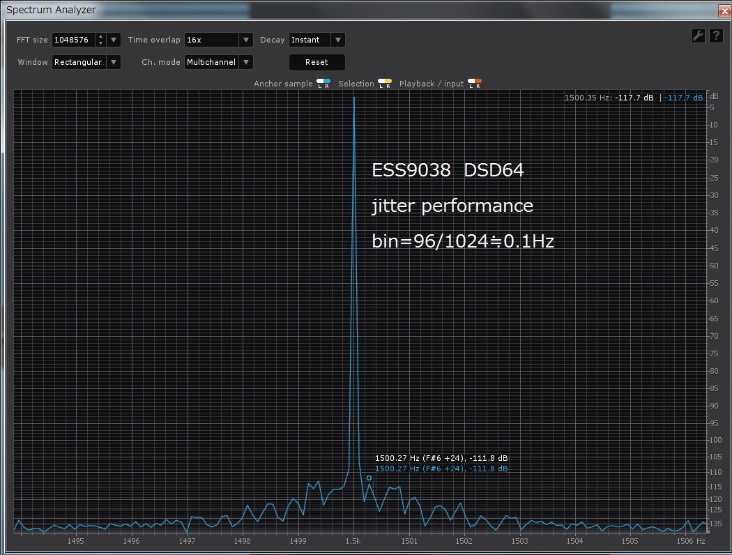

I usually use iZptope to analyze ADC output connecting through optical SPDIF because it has many functions such as notch filter, denoise, and pitch adjustment. But next time I will use popular SW like audio Tester😉.
The frequency is 1.5kHz instead of 1kHz to do coherent sampling which can obtain exact bin by the rectangular window. My ADC board(AD9760), which is now under developing, can lock to the external clock which is necessary for coherent sampling. You can analyze jitter performance by 0.1Hz resolution at a 96kHz sampling with 1024K FFT.
PCM1792 has less THD than ESS9038. But the output is -0.9dBFS which means 9Vpp. I'm sure 6Vpp(2Vrms) can have better THD.

It seems like your analysis SW does not show the THD. Some of the numbers are a bit confusing, e.g. the PCM1792 meaurement shows the RMS as -111.47 where the third harmonic is around -102.
What is the distortion of the ADC used for testing? At these levels of distortion a passive notch filter may be needed to see the real DAC distortion without uncertainty whether the distortion is from the DAC or from the ADC.

But nonetheless - interesting measurements. Surprising that THD varies as much as 10db over a period of time. The min and RMS are what I am looking at but also wonder why THD in your setup spikes (like JensH observed that the PCM1792 spiked when you took the screenshot)

I don't have an op-amp that runs in class A. But I don't expect it to make any significant difference anyway.
Even with an ideal op-amp (not in stock anywhere the last time I looked), I wouldn't expect the performance to change compared to using the NJM5532.
As I see it, the distortion is created by the DAC, when operating in voltage mode, not the op-amp.
And the noise is almost entirely defined by the high resistor values in the original circuit. My measurements correlated well with simulations done in TINA TI.
Changing the op-amp from the NJM5532 to LME49720 made almost no difference. Actually I measured an increased distortion of 0.5 dB, but that could easily be measurement uncertainty, temperature differences etc.
It would probably be possible to reduce the noise of the filter/buffer by scaling the component values (lower resistor values/higher capacitor values), but I have a feeling that it might result in increased distortion due to the higher load on the DAC.
If you want low noise and low distortion,the current mode operation is the way to go.
