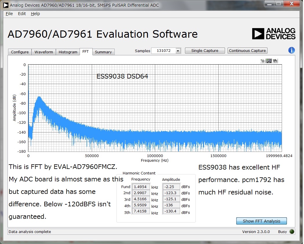

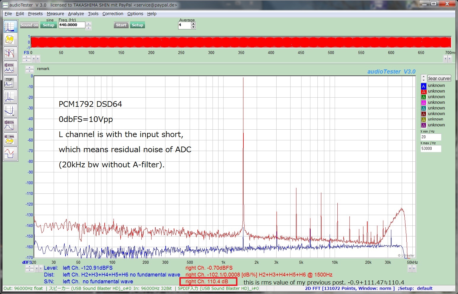

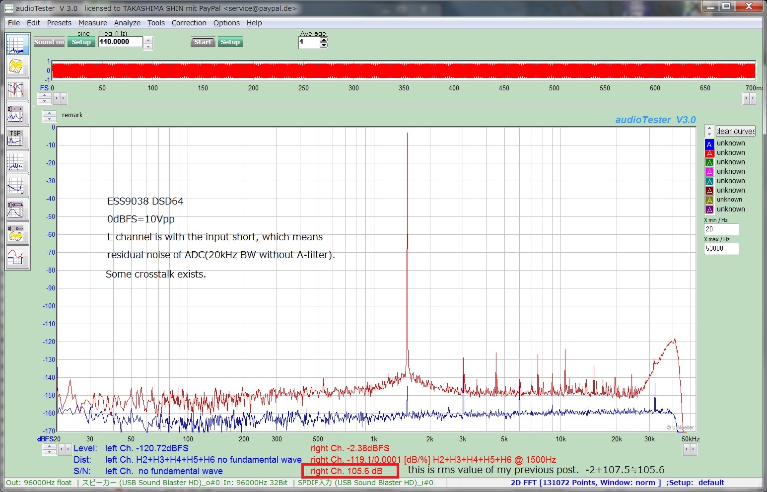

It seems like your analysis SW does not show the THD. Some of the numbers are a bit confusing, e.g. the PCM1792 meaurement shows the RMS as -111.47 where the third harmonic is around -102.
What is the distortion of the ADC used for testing? At these levels of distortion a passive notch filter may be needed to see the real DAC distortion without uncertainty whether the distortion is from the DAC or from the ADC.[/QUOTE
Sorry, my previous post was a little bit confusing. The attached are FFT by audio Tester. I intended to show S/N of audio Tester, but some calculation was needed. I measured data again today. They were almost same as the previous one, which is what I want. Absolute accuracy below -110dBFS is beyond a DIYer. It's very difficult for a commercial product to achieve such precision. My destination is relative comparison and repeatability.
My ADC is AD7960. FFT by evaluation board of AD7960 outputs almost same data as mine. But of course, more than -120dBFS THD is not guaranteed by the datasheet. What I can say is relatively low THD exists, but absolute value isn't reliable.
