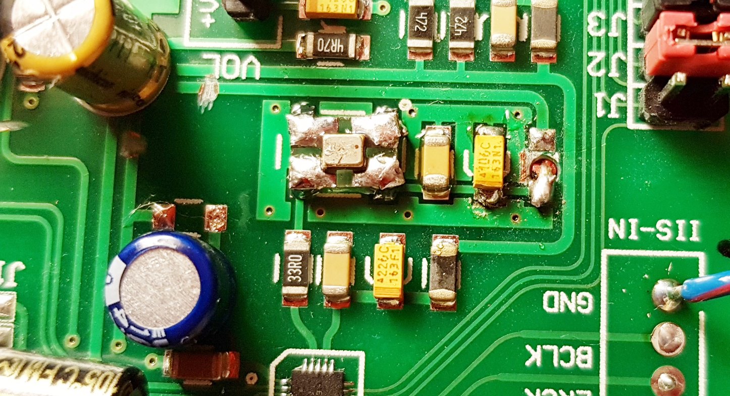

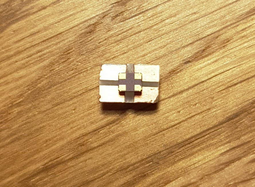

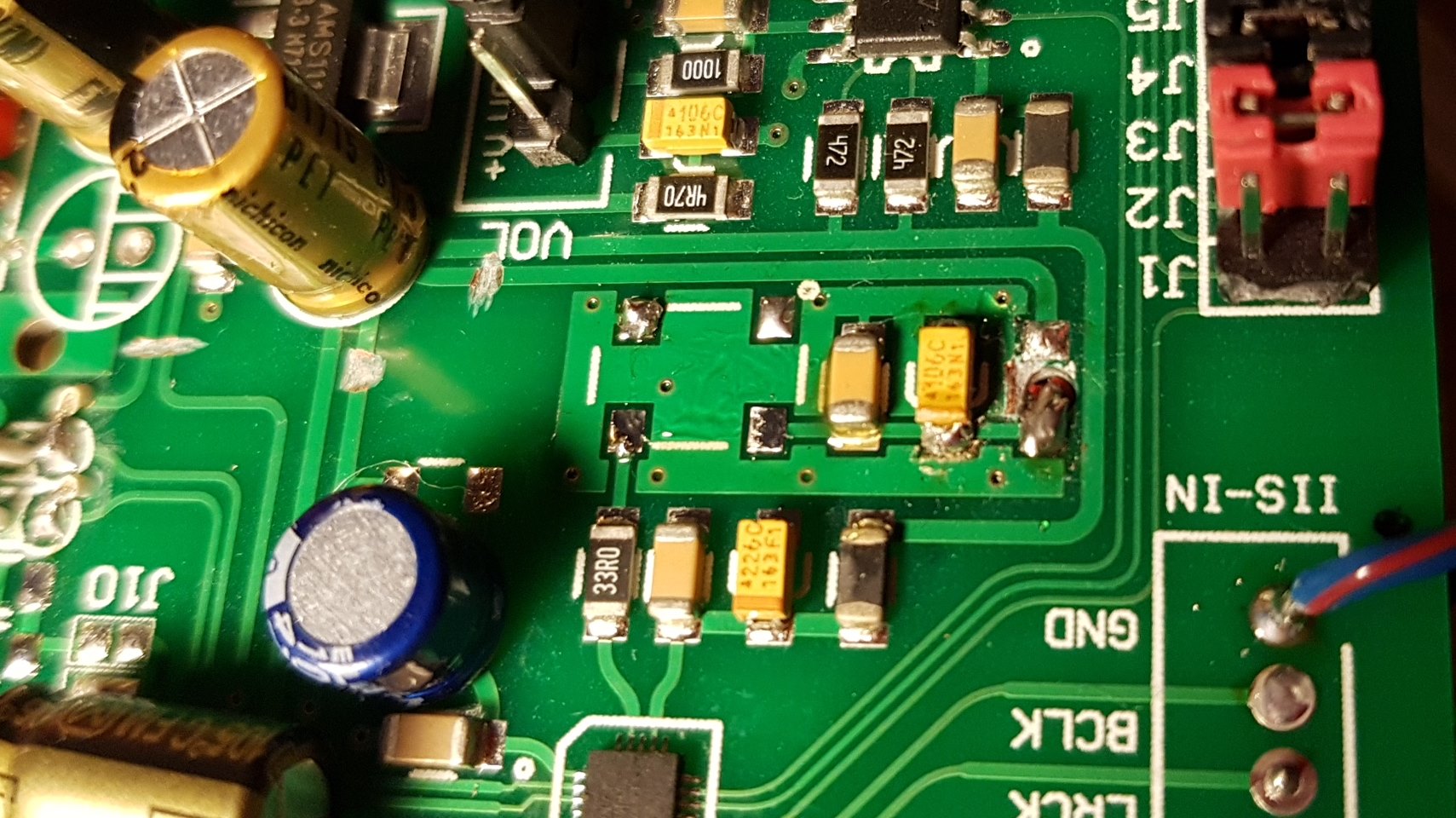

Got a new Asus X470 MB with a ALC S1220 Codec. Actually it sounds better than an older external Assemblage DAC2 with the factory upgrade . Dynamics, pace, clarity. It is all over the older DAC. Never expected a built in sound chip on the MB to be superior....easily discernible. Tells me that this digital stuff have to considered as short term stuff. Keeps jumping in performance and older stuff needs to be put away. I was thinking I would take the old stuff and stick it in the office and it would be half decent. Oh Well.
new clock on board
Hello,
Yesterday I installed my new NDK SDA 49,152 MHz clock on my board (v.1.04). As the new clock is very tiny (2,5x2mm) I had to build an adaptor board with same size as the orig. clock. I used a 2-line print board and cut the 2 lines so that I ended up with 4 lands to solder the clock on. For soldering the clock I first put 4 stripes of copper film on the outer land parts to make the connection from the lands to the solder points on main-board on bottom side of the adaptor board. After placing this copper stripes I added some smd solder paste on each land covering the copper stripes and the lands completely. Than I placed the clock in the Center of the "cross" so that the clock contacts touched the Corners of the land fields and sticked by the solder paste. Then I heated up my new solder hot air gun on lowest Speed with around 275 °C and soldered the clock - worked perfectly. Then I installed the small board onto the main-board by soldering the copper stripes to the orig. solder points of the old clock. Before that I had to de-solder the old clock and used some modified solder iron. I removed the orig. tip and replaced it with some thick copper wire parts that I bended so that I could heat up all 4 solder Points at the same time - it worked.
How does it Sound? I would say the difference is not big and some people say the memory of sound lasts no longer than 1,5 sec. So a comparisson before / after is very difficult. Anyway I had the impression that it further cleaned up the heights (more silk like) and the stage is a little wider.
The deep bass got some more power towards kick-bass which gives a "rounder" impression with more substance and more natural feeling. As I changed the AVCC caps the same time from my "normal" 47uF aluminum to 47uF polymers 47uF (K50 with lower ESR) this might also have influed the bass performance. All in all I am very happy now with the sound allthough I already was before this clock change.
As a ranking of most efficient mods I did to my board I would judge it like this:
1) Change from voltage to current modus by i/v board -> improves dynamic and makes the sound very natural by getting rid of hiss in heights and less fatiguing , less edgy sound.
2) apply AVCC opamp PSU (inkl. own reg. for Vref) -> gives a tight and controlled bass "in-time" with the higher f-range. Pulses are very controled now and come with kick- and deep bass at same time
3) clock change and clock PSU with seperate reg. -> gives finer heights and removes some harshness. Soundstage increases a little in depth and wide.

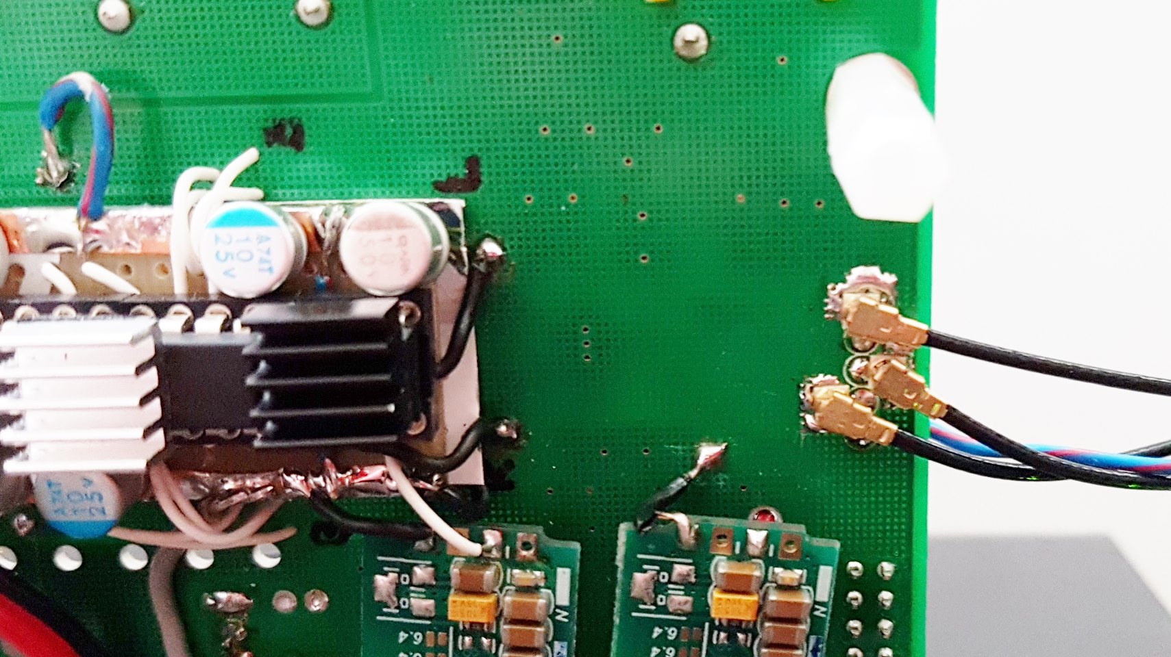

For all using I2S Input I highly recommend some shielded wires. I installed some UF.L sockets on the bottom side to connect them. As I use SW upsampling to 96kHz incl. room correction both done by my Raspi I am not planning to apply a HW upsampler. Next step will be changing diodes of my analog PSU to HEXFREDS and care for installation into a housing such as a better heat-management. I checked temp. of my opamps and PSU transistors. opamps are around 50 °C and PSU transistors are at around 60 °C - maybe I will connect them to the housing bottom made of 3mm aluminum plate to improve cooling. Opamps get bigger cooling devices and board will be installed upside-down for better ventilation of opamps on bottom side. Output traces are cut after orig. DC Offset cap solder points and wired from there to new output connectors in the housing.

Freezebox, Thank you for the detailed update on all the mods. Sorry you did not get more improvement from the clock. In addition using NDK SDA 49,152 means some of the higher bitrate modes will not be available. But, if the clock is working properly jitter should be much lower for the modes it does work with. There have be some reports of NDK quality control on their clocks (or ones without the A suffix) to be variable. Some people will buy a few and see which ones are the best and use those, or so some of the reports on the internet seem to be saying. Maybe someone else could clarify about the history on that.
Anyway, if the clock is indeed lower jitter then you should get used to whatever improvement it offers over time. Then, you might notice more change if the old old clock was put back.
Also, hard to compare with the equivalent mod done here since the clock I used is a Crystek 575.
Sure wish we had more more build reports to get a better idea of how mods turn out on average. Your contribution for that is very useful to many others who are still thinking about what to do, so thanks again for reporting your results.
