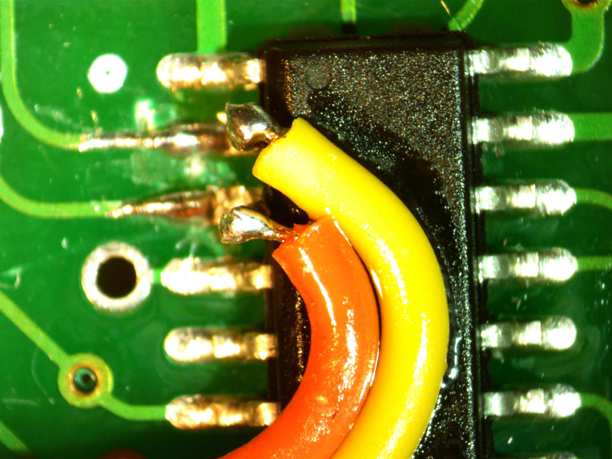

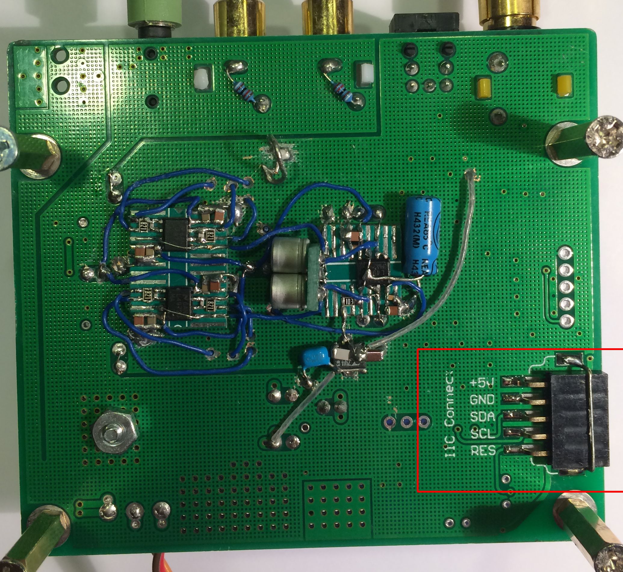

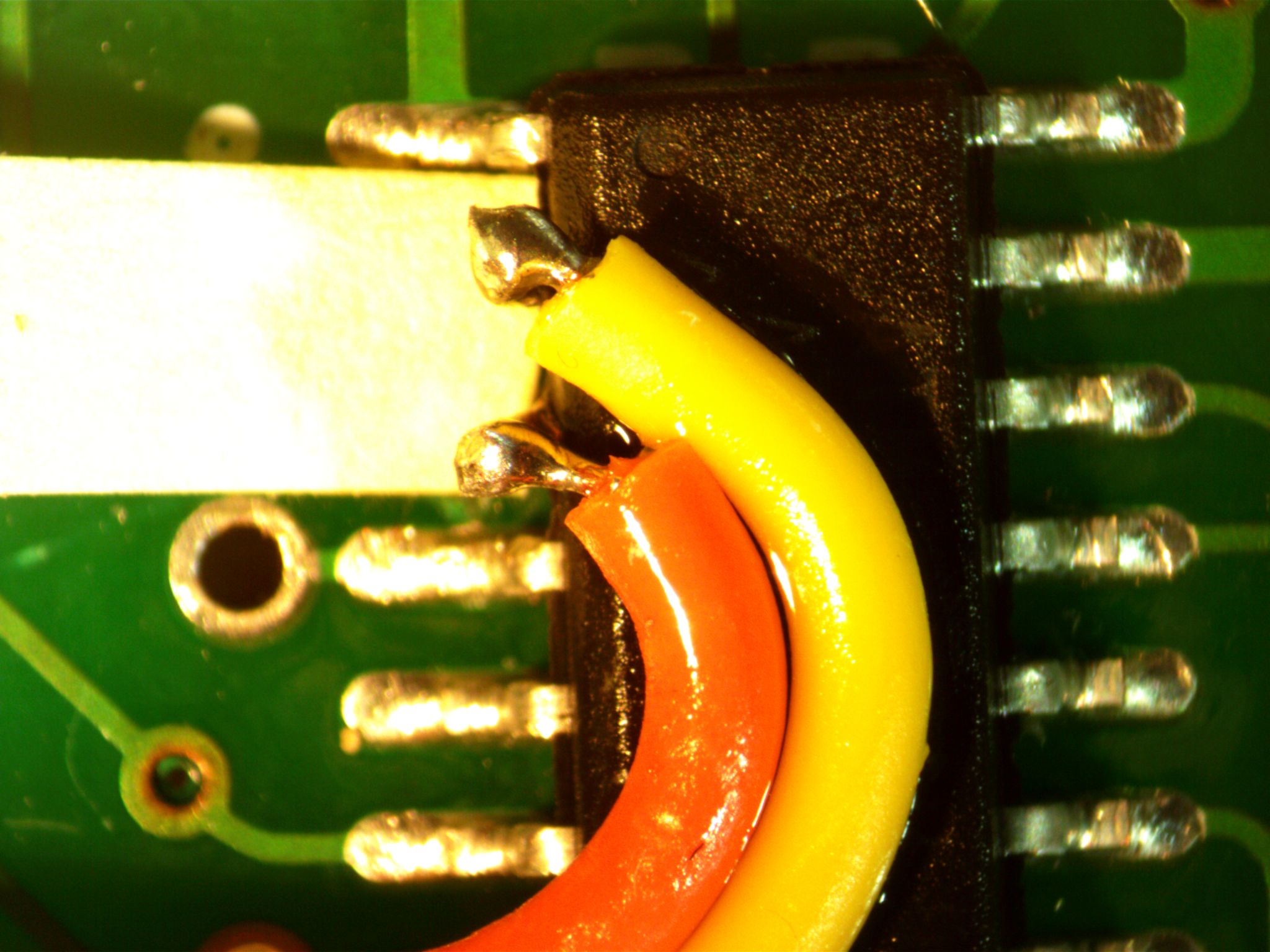

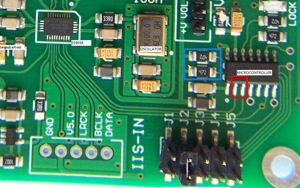

Okay then. Let's talk some more about hardware mods. You will need to be able to take control of the I2C bus that the microcontroller uses to control the DAC.
To get you started I will post some pics below of necessary mods to the DAC board. A little later I will post something about an Arduino Shield to work with the DAC board mods.
It is necessary to unsolder or lift a couple of pins on the microcontroller that run the I2C bus. There is a data line and a clock line. The pins on the microcontroller are circled in red. Pullup resistors for I2C are in the blue box, just for reference.
On the the bottom of the board a female pin header connector can be soldered on to connect the microcontroller back up, or to connect the Arduino as controller.

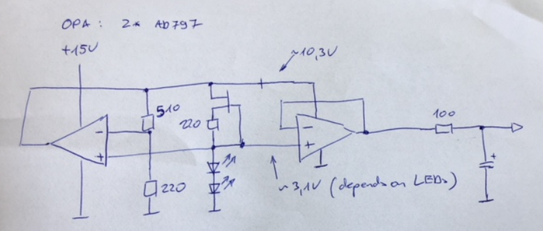

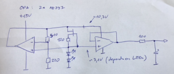

Hi All,
AVCC:
Could someone please model this circuit in Spice regarding noise? (I'm not (yet) enough falmiliar with it)
I merged 3 ideas from the following sources:
1) OPA as power supply
Frans de Wit from diyaudio:
Balanced input all DC coupled RIAA preamp
(The 4th picture where from raw source a clean power source is created.)
2) Walt Jung who used LED in an OPA circuit as VREF
http://www.waltjung.org/PDFs/Walts_Blog_2014_GLED431.pdf
3) And JFET (2SK170) as low noise current source from the SALAS circuits.
Thanks,
Szabolcs

PS.:
1) If you find that the LED still has too high noise it can be simple replace with a resistor, since the constant current source and this R will give a contstant voltage REF.
2) I'm not sure if this circuit will not oscillate at high Freq. (maybe some pF needed perallel with the 510)

What makes you think one AD797 output can for sure supply enough current to power another AD797? They use more current than they output, right? How do you keep the second AD797 from oscillating without power bypass caps, and how would those affect loading of the first one? There are lots of other things to think about and consider, some of which won't show up in spice. It would only take a a few seconds to come up with a very different design that is much better if you knew more about engineering. I guess I would say if you like to play around and have fun with circuits you probably have some work ahead of you to learn how to model, build & test, and to learn more about design. It's okay you don't have to be a world class designer right off at the beginning, but you have a lot of work and learning ahead of you. Good luck and hope you have fun along the way.

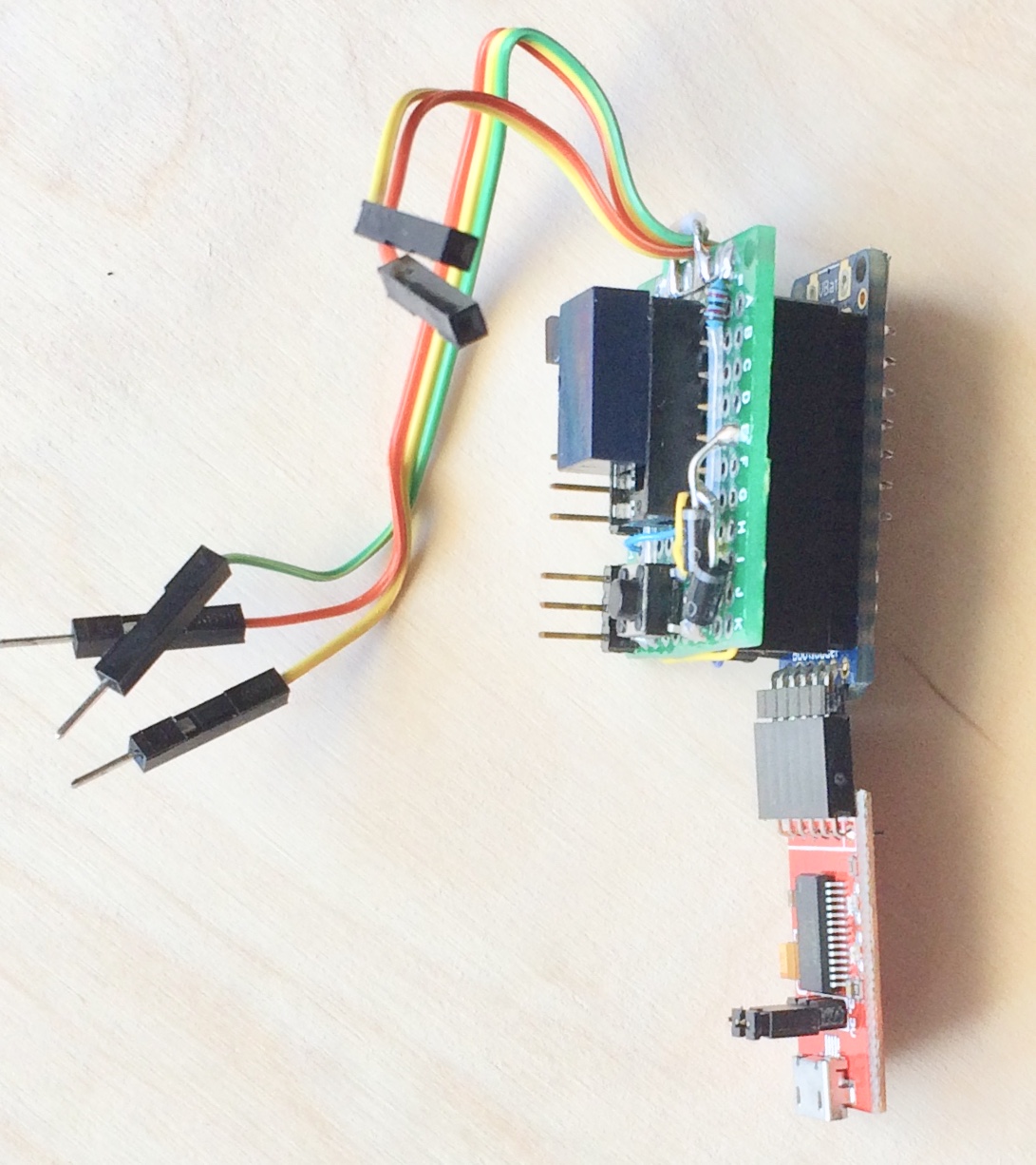

Looking forward to see your Ardunio project!

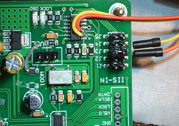

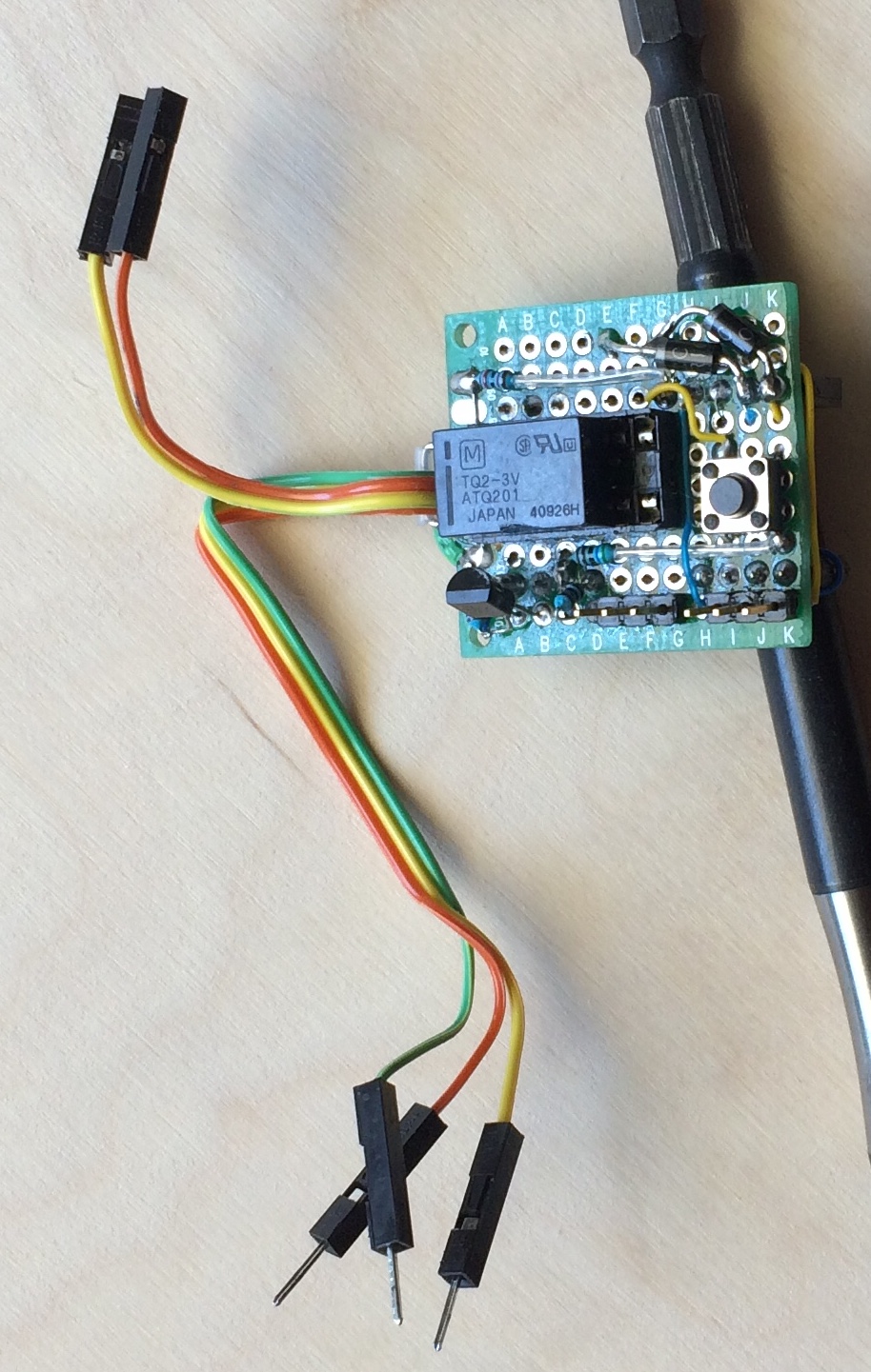

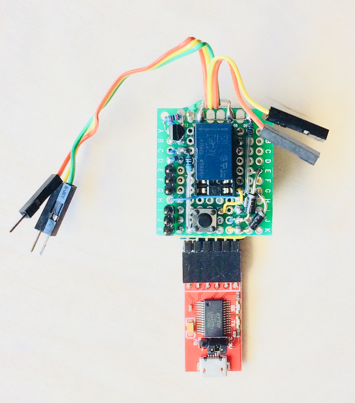

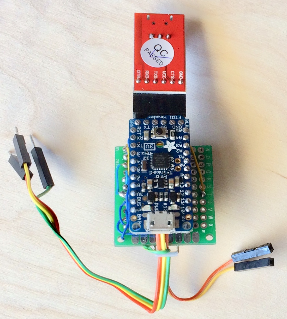

Okay, here it is:
Basically, there are some schottky diodes to protect the Trinket pins from DAC pullup resistors if Trinket power is off. The I2C bus connects to the pins on the Pro Trinket diagram labeled SDA and SCL, I2C data and clock, respectively. Also, important to take note that even though the Pro Trinket diagram is labeled 5v, I am using a 3.3v version to prevent any accidents with mismatched voltage levels.
There is a 3.3v DPDT relay on the shield to seize control of the I2C bus from the DAC microcontroller. Please note I usually use yellow wire for SCL and orange for SDA, but they got accidentally swapped when soldered onto the microcontroller so I swapped them back on the Arduino shield board.
To be clear, to use the shield I unplug the microcontroller from the I2C connector on the DAC board and connect the wires from the microcontroller and the DAC board I2C connector to the orange and yellow wires on the shield. The DAC can be allowed to boot and operate normally from the microcontroller. I can take over at any time with the Arduino, and then return control later. The DAC microcontroller doesn't seem to mind, it just keeps on doing its thing when it is connected.
The shield also has a transistor to drive the relay coil current and a flyback diode across the coil. There is also a button and pins for 2 pots in case I want to control volume or something using the Arduino and a pot.
The little red board is an FTDI interface which is a complication of using a Trinket and wanting real-time terminal interaction with a computer. It takes an FTDI board to do that. More powerful Arduino types don't require that but none run at 3.3v. I could have used a more powerful Arduino and a level translator for the I2C bus, but this is how it ended up. (In theory the level translator might not have been needed, but there are some conditions where an accident could occur without it.)
It may be worth noting that if using an SRC4392 it can also be controlled using the same I2C bus since it is located at a different bus address than the ES9038Q2M.
Hi Mark, thanks for your comments. Meanwhile I installed LTspice and trying to do the modelling.
I'm sure 1 opa can power the other - this was in the build of FwD. Since this is only a starting point of common thinking definitely some filter CAP are missing, I think the best if I open a separated post only for this ultra low noise OPA based VREF.
I think you may find it depends on how much current the 2nd one needs to output, for one consideration. If it is putting out near maximum at any time, then it may need to pull more than maximum of the one acting as the supply, assuming both are the same type of opamp.
In other words, whoever designed the example you are referring to probably checked to make sure it wouldn't be a problem for that particular design. Doesn't mean it can't be a problem for your design.
