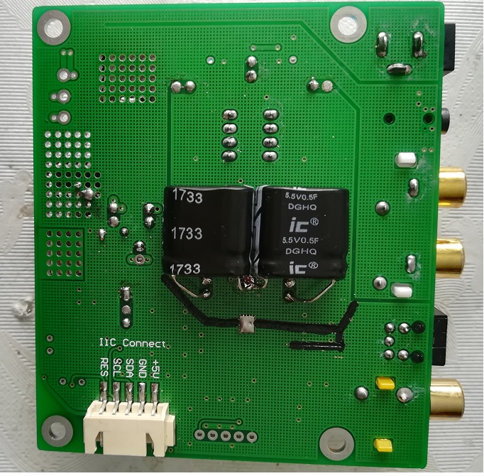

Newermind...i go on with work. I will first try my previous combo as i tried with orignal board and listen then go further if any promising result will be hearable. Supply wil be 12V ACCU this will now feed 5 regulators.
Avcc is powered direct from Accu trought boosted lt3042. I left 4r7 to isolate regulator form 2x0.5F low esr caps( after testing i will deceide if any smaller caps will be needed for bypas, now is 3,3uf MKT and 0.1 PPS. I avoid ceramics near dac on analog lines. 5v preregulator for digital part is tps7a4700. I quick measured lines with scope, excellent, can*t see difference if i put scope probe on gnd or supply line. Extremelly clean.

Ezitits... Thank you, i will measure what is startup current. Regulator is 1A. Any better idea, i will like to avoid direct connection to such a big capacitor?
Janos... fine that you also do in that way. So you bypassed pin 13 in the middle with 330uf
and you splitted 3,3v power lines. Now you power pin 27 with one regulator and pin 12 with another regulator. Yes you are right it is 5ohm between 2 pins?. Are regulator suitable for such paralel connection with just 5 ohm joined output?
I measured 1,2V voltage on 4r7resistor at startup and drops slowly..that is around 255ma...so arround 510ma on both channels.

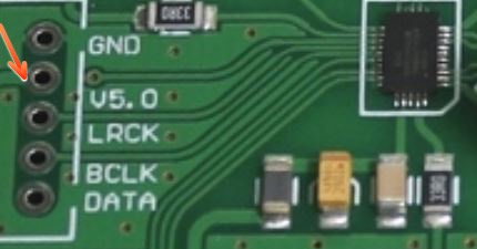

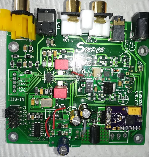

My es9038q2m board i2s input has a 5v input going into the dac chip. Right now I left it open, anyone knows what the is use of that input labelled v5.0?
Right now, I am modding my board to transformer output and will use a 10k:10K transformer connect directly to output pin with 680R direct across +/- output pin. The output is fairly low and I wonder if a higher value is better.

The 5v connection is the second from the top in the vertical column to the left. They didn't print the labels lined up very well. The 5v is a power output from the 5v regulator on the DAC board. It is there to provide power to an external I2S source device if it needs a power source. Otherwise it should be left disconnected.
If using a transformer output it is best to make the resistor as small as possible since DAC distortion is higher into a higher impedance load. The lowest distortion would be into an opamp IV stage.
When the DAC is operating into a higher impedance load such as one would get using a large resistor then the DAC would be operating in voltage mode which has rather poor distortion performance.
If using a current sense resistor such as is done when using transformer output, actually the transformer is not necessary for that to work. The voltage amplifier that connects to the transformer secondary could be connected directly to the sense resistor. The reasons for using a transformer rather than a direct connection include galvanic isolation and the addition of a little, possibly pleasant sounding transformer distortion. Some disadvantages of transformer output include relatively high cost and worse distortion performance than opamp IV output. One big attraction of transformer output is simplicity, it is easy to hook up.
