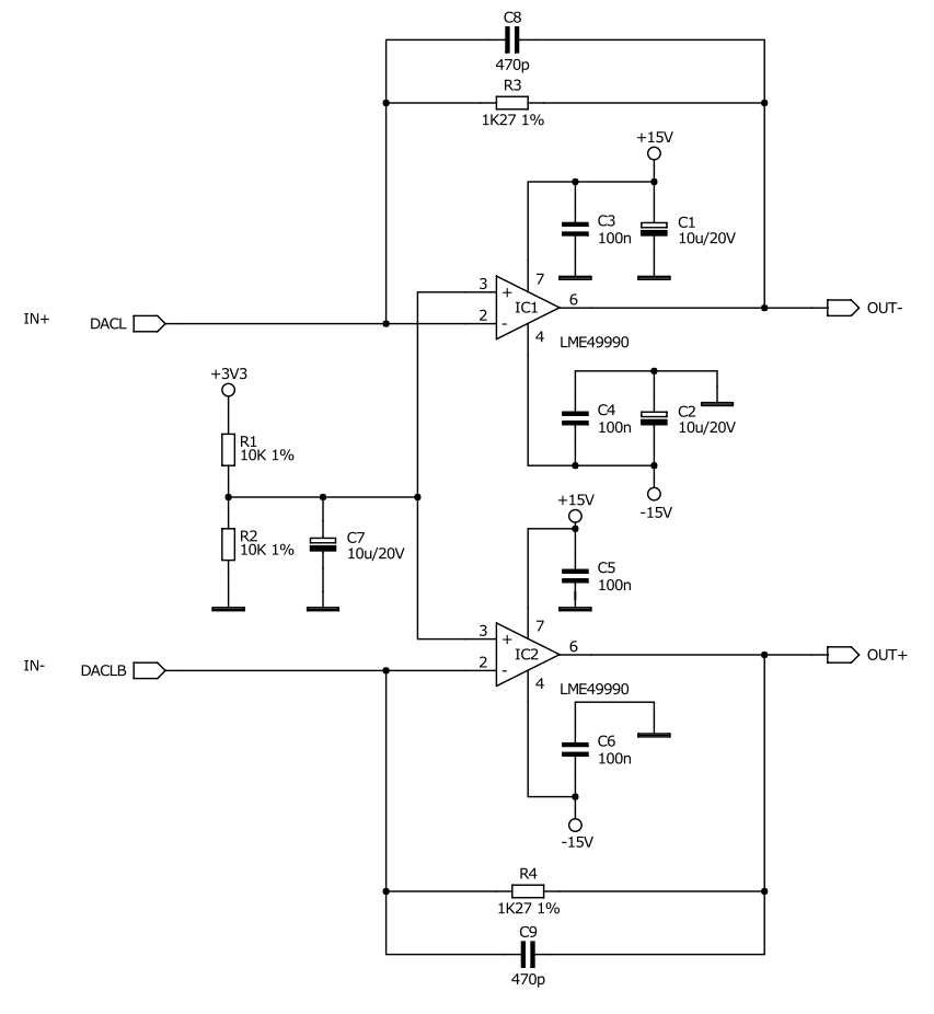

In current mode the output is held at a fixed voltage, typically provided by an op-amp with the inverting input directly connected to the output of the DAC (one op-amp for each polarity). The non-inverting input is connected to a reference voltage, in this case 1.65 V (half of the 3.3 V supply). The feedback will make sure that the DAC output is held at the same voltage as the reference voltage. The current through the DAC output will vary depending on the audio signal applied to the DAC.
In voltage mode a high impedance filter/buffer stage is connected to the output of the DAC. So the DAC output will have some voltage swing in this case.
Yes, I used two resistors and a tantalum capacitor to make a 1.65 V reference.

Can you show a schematic of your output stage in current mode?
Voltage mode was original like on board?
Thank you.
Pretty sure the I/V was just the classic inverting opamp with a Rf of 1.26 kOhm, not exactly sure the capacitor size needed for the lme49990. He's running it differential, so they're just two identical circuits for each leg.
And he said that the opamp for voltage mode was a straight opamp swap, so the as-provided circuit.
Yes, nothing special. See attached schematic.
And the voltage mode was with the original circuit and op-amp, except for the brief test with the LM4562 instead of the NJM5532.
