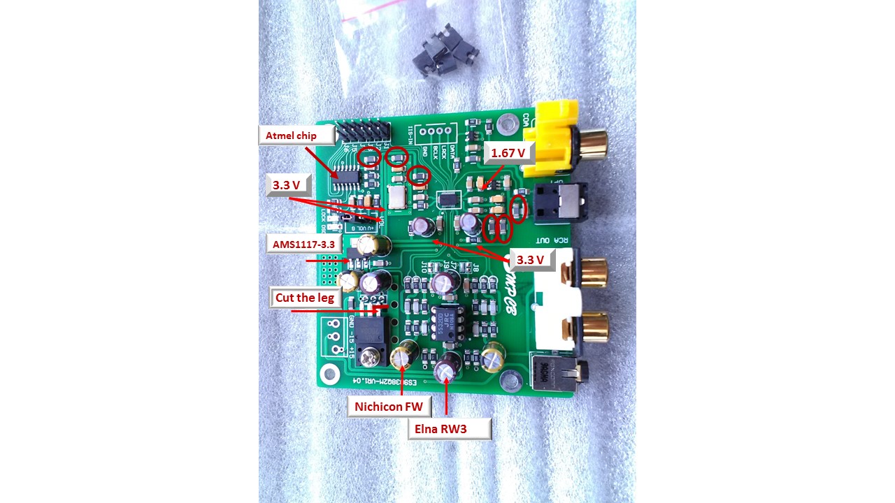

My board have just arrived 🙂! I was surprised, because of the fast shipment and the very good quality. It is so much better than the cheapo ES9018K2M board. There are good quality smd components, and the module comes with Nichicon FW (yellow/black) and Elna RW3 (brown) capacitors. The consumers of the DAC chip are isolated well (see red circles). There are plenty of upgrades available for DIY-ers! I installed a Superreg instead of the KA7808 reg, and +/- 15 V superregs for the opa. The sound with 3 superregs using coax is good, full with live, and detailed even with the stock JRC5532DD.

I also got my board (same as the one from janos_904) a view days ago. I am also quite happy with it. Locking via I2S from raspi + HBD+pro works fine and is indicated with a blue LED. Also S/PDIF works fine, but it has a strange programming as I wanted to use the Coax entry for room measurement, using the same DAC as for music. Left channel works fine, but right channel switches off after 20 sec, when no signal is detected on left channel... my logsweep for measurement takes 60s / channel. With a mono sweep it works, just connecting 1 output.
Regarding SQ I am also happy. I measured the different DAC filters Impulse Responses and they seem to work aswell as they should. I decided to use the "fast roll off linear" as it has a symmetrical pulse with lowest pre- and post ringing Amplitude and the widest linear high-range. I have to do a listening comparisson as well...
I removed the 2 nichicon DC blocking Elkos and the 47k ohm tie down resistor from signal Output path and installed an audiofeel descrete opamp with adjustable DC offset for each output. The Sound improvement was not as huge as on my AK4595 board with this descrete amp - even the 5532 already sounds great in this board.
@janos_904, regarding the PSU reg for 8V supply I am not sure if it makes sense to use the super reg here - why don´t you change the 3,3V reg instead which is following the 7808 reg? Which filter setting did you use for listening test? Did you apply seperate PSU for 8V supply (is a PSU it included in superreg?).
All in all it is a well built board, with reliable and solid function and some good possibilities for DIY improvements.
Yes, I do have 2 separated supply for ±15 V and 8 V (2 R-Core trafos). The superregs (±15 V) are just excellent, and one leftover superreg panel was used to provide 8 V to AMS1117. 8V superreg is doing the job well, but I am going to compare it to the low noise LT regs (LT3042, 3045) later, or do you reccomend some others? I recommend to replace two 47 uF/50V Elna RA3 to 47 uF Elna Silmic IIs (opa power supply) yielding to more air, and improved middle range.

That AMS1117 could stand to improve with a larger output capacitor, according to the data sheet. Might want to give it a chance before yanking it out.
There was also something in ther about bypassing the adjust pin as well.
I just looked a bit more and noticed that the entire board is supplied with 15-0-15, so I can see the merit of trying an independent supply for the other stuff...
