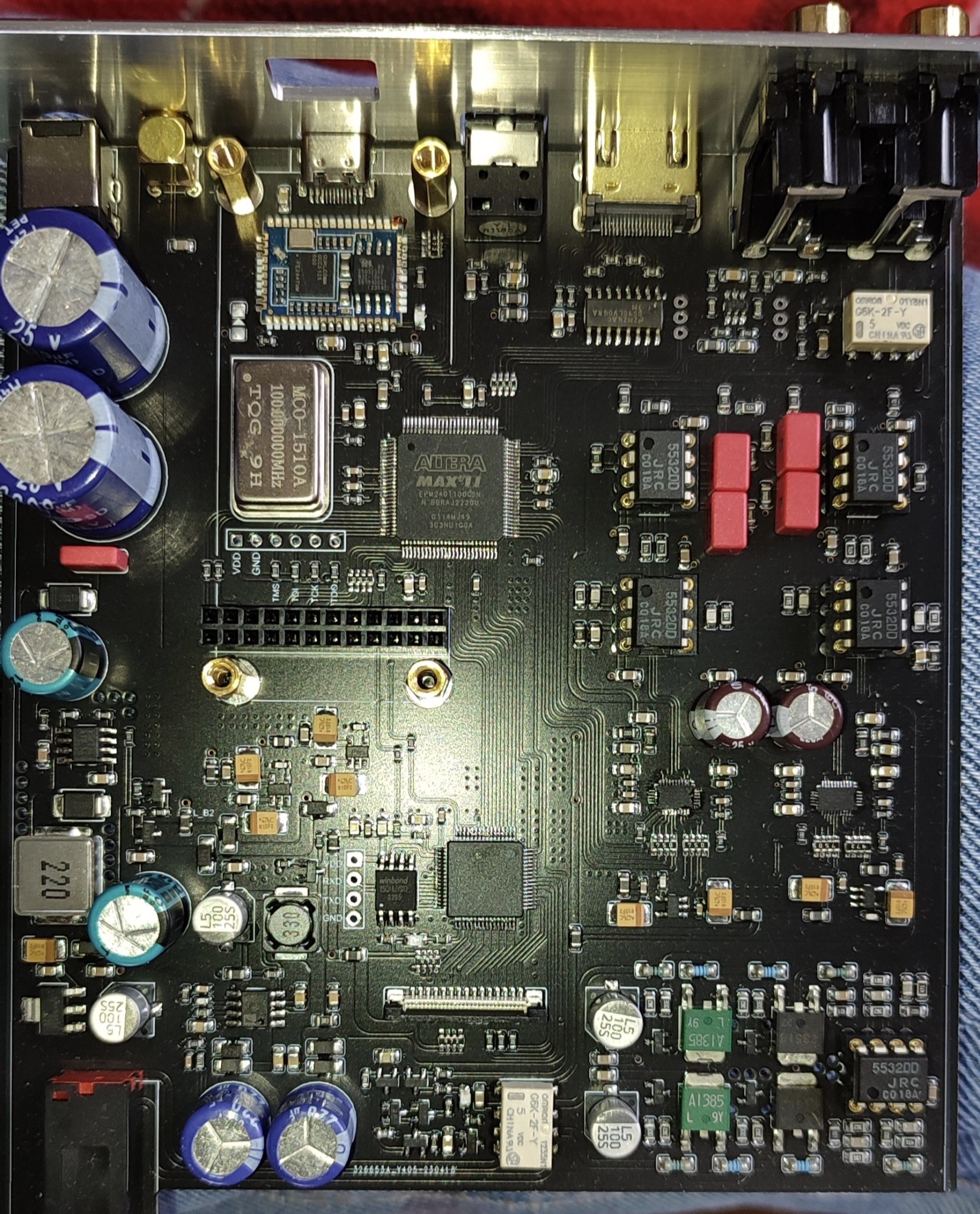

Got this Double SE9038q2m out of curiosity and it wasn't special until I put 4 LT3045 regs in it. Now It's on par with my AKM 4493 that has the same regs. Both units still have there stock output stage. My transformer out AKM 4493 and 4495 units have a bit more resolution and sound more analog like. Dynamics are better with SE9038q2m. Spacial
representation is also a tad better with SE9038q2m. Next step will be adding Walt Jung transimpedance AD811 stage. Courious where this will get me.

Photo of stock unit.
ESS hump is already addressed by the red Wima caps.
Oszillator respoded really well to clean power.

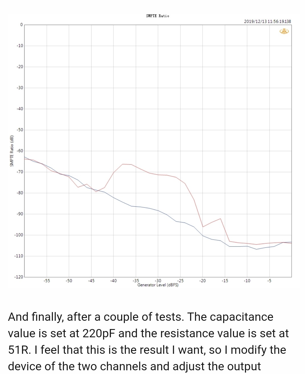

How would Wima caps help against ESS IMD hump?ESS hump is already addressed by the red Wima caps.
That was a remedy for Khadas Tone Board. Not universal and not necessarily appropriate for NE5532. Also it does not remove the ESS IMD hump but lowers it below noise floor in dacs that have elevated noise floor.

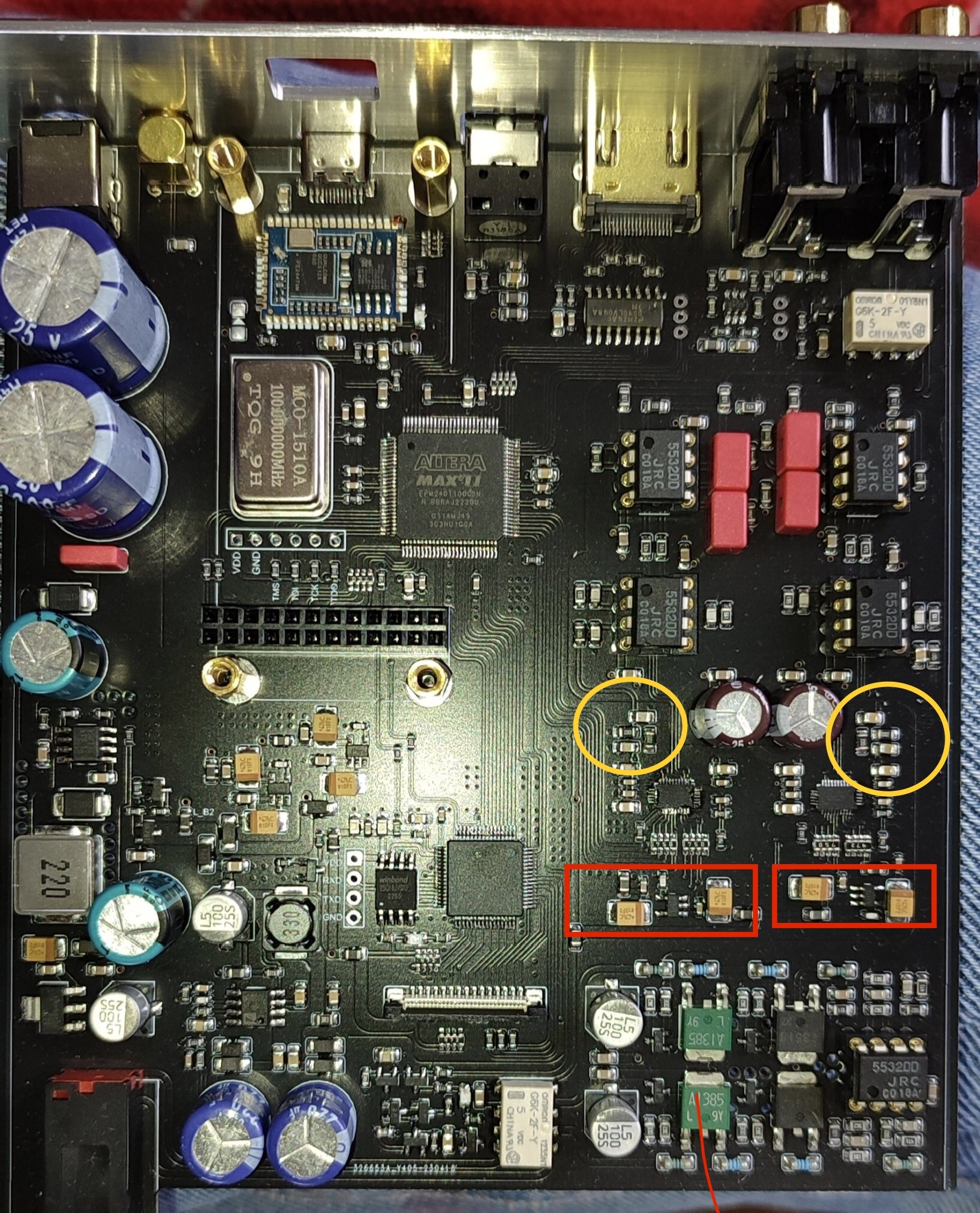

i didn't see voltage divider for VREF in this picGot this Double SE9038q2m out of curiosity and it wasn't special until I put 4 LT3045 regs in it. Now It's on par with my AKM 4493 that has the same regs. Both units still have there stock output stage. My transformer out AKM 4493 and 4495 units have a bit more resolution and sound more analog like. Dynamics are better with SE9038q2m. Spacial

Sorry, my memory of ASR "hump fixes" had faded. The fix you refer to was made for Soncoz dacs and the later totally different fix to Khadas Tone Board. Neither of the fixes removes the hump but makes it lower. Your board does not follow the Soncoz fix either so without measurements it is impossible to say if it has the hump.
I have not properly traced out the unit around the DACs. Stupid me because my hasty approach just seemed to have killed the DACs. When do I ever learn to be patient. Coming from exclusively modding AKM based units I thought I knew what I was doing.i didn't see voltage divider for VREF in this pic
Maybe someone can chime in and explain how vref is handled with ess double DACs.

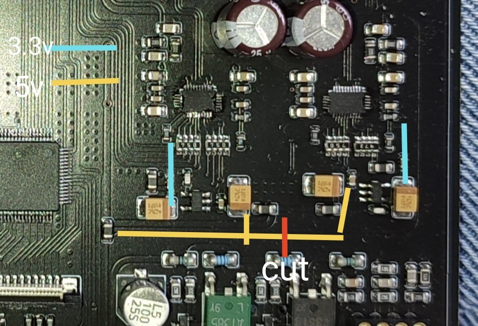

I was eager to give each channel it's own supply. I did the following:
Ok Radian, i found voltage divider (yellow circle) but this board has only 2 LDO 3.3v regulator for 2 9038s (red rec). Poor setup
Since left and right channels of one chip is summed I can't see why having only one reg would be of great concern.
At least we know now that poor design does not necessarily mean poor sound.
