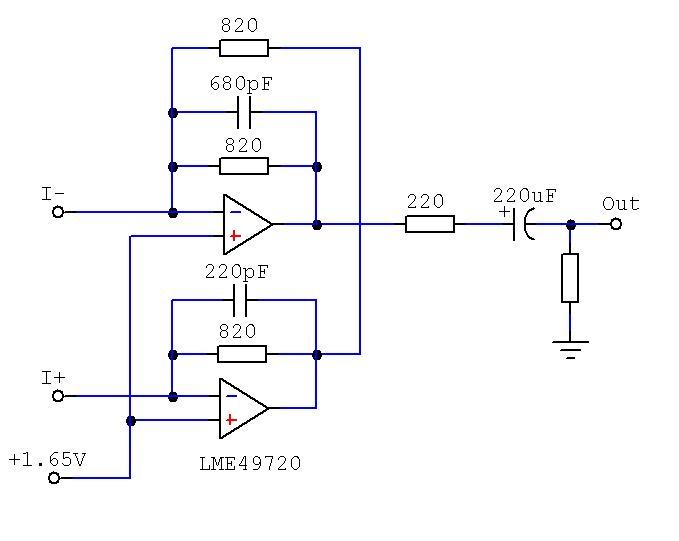

Then there is a simpler way to make some improvement posted by forum member Victor (aka vicnic ?) that used two opamps per channel to make an output stage:
However, LME49720 is probably not the best opamp for the above since it appears to sensitive to EMI/RFI present at the dac chip outputs. You might try OPA1612 instead.
Also IIRC, Victor attached three 1800uf caps in parallel on the bottom of the dac board per AVCC channel (from each AVCC pin to ground) to help stabilize and clean up AVCC without making a complete regulator.
Otherwise the opamp buffer AVCC supply in the ESS application note posted previously can work to power AVCC. A low noise reference can also be used for the opamp buffer reference inputs. The circuit can be mounted on the ground plane side of the dac board. The AVCC buffer opamps can be run from +12 or +15 volts, and with ground used for the negative opamp rail.

4.7uf DC block caps? I think bass range will goneSo I decided to replace the two caps at first (C17, C30) on Wima fkp 4.7uF. I started burn-in process. My dac have a DSD support, right? How can I check that in Win10 and macOS Big Sur? Without DoP and conversion of course!

No. There is a bass and quite dense. I listen with my Hifiman 560. Tomorrow I want listen trough my stereo setup. I also change fake 8920 on LM6172. I don't have other opamps (need to buy).4.7uf DC block caps? I think bass range will gone
Like the guys are trying to tell you. Its not just opamps, not just DC blocking caps. There are significant problems with this board. Like I told you, output stage and AVCC supplies help the most. OTOH, Wima FPKs in large values are a waste for something like this. Large size film caps may sound good in speaker crossovers, but not for DC blocking in a DAC. Doesn't work like that. Sorry.
Turns out its exactly 1/2 of +3.3v. Historically it was taken from each AVCC regulator output, then reduced to 1.65 using two 10k resistors in series to make a voltage divider to ground. The output of the voltage divider had an electrolytic filter cap to clean up that I/V opamp common mode voltage. Later it turned that the voltage didn't have to be half of AVCC, sometimes less voltage was used for two possible purposes: (1) to reduce hump distortion under the conditions it was being measured, and or (2) to remove the dac chip DC offset using the I/V opamps. Two things about that, (1) changing the measurement conditions can merely move the hump to a different frequency and or level. IOW, lowering I/V common mode voltage can hide the hump, but not necessarily completely eliminate the problem, and (2) reducing the I/V common mode voltage causes a DC current to flow out of the dac output and that current is supplied by the I/V opamp. If you want to try it you could use a 20k pot (instead of the two 10k fixed voltage divider resistors) and dial down the common mode voltage to reduce or eliminate the DC offset at the opamp outputs. However, you might need to change the filter cap and or change how the filtering is done since using other than two 10k resistors would reduce the time constant depending on the exact pot setting.where I can find on board +1.65V?
All resistors should be good quality metal film or metal thin film. The better quality Yageo resistors are what I would suggest to try.820 and 220 - smd type resistor?
Depends. If you remove the DC offset in the I/V opamps then maybe you don't need DC blocking caps. Otherwise you could try may Pansonic FC, or similar, maybe with a small Wima mkp cap in parallel. In that case the film cap is a lot smaller than most people think if you don't want the sound to be too bright. You may find .1uf to be too much, and maybe find 4.7nf to be too small. Have to try it and see what you think. Also, when electrolytics are used for DC blocking they should be large enough value so that the AC voltage across them at the lowest frequency of interest is very small. Less than 67mV is a number that comes to mind. In addition, it can take a week or three for sound of an electrolytic in the sound path to audibly stabilize. You may have to burn it in for awhile before deciding if you like a particular choice of cap.and what kind caps (220uF) I need?
They would be from the AVCC pins to ground (3x 1800uf per for each AVCC channel). That was as an alternative to using dedicated low noise regulators for each AVCC channel, such as, for example, opamp buffers.Caps (1800uf) where they should be on scheme?

That resistor after the 220uf cap is just to discharge the cap if the output of the dac is not connected to anything else. We probably want to keep the impedance high after the cap so as to keep any voltage drop more across the load, rather than across the cap. Otherwise we might try a bigger value cap so its impedance is low compared to the load impedance. The resistor value depends on how long a period of time we are willing to allow for the cap to discharge, and how much current we want to go through the resistor in normal operation. You might try making the resistor something like 100k as an initial estimate.
EDIT: Not sure what you mean by "tune the opamp from both side?"
