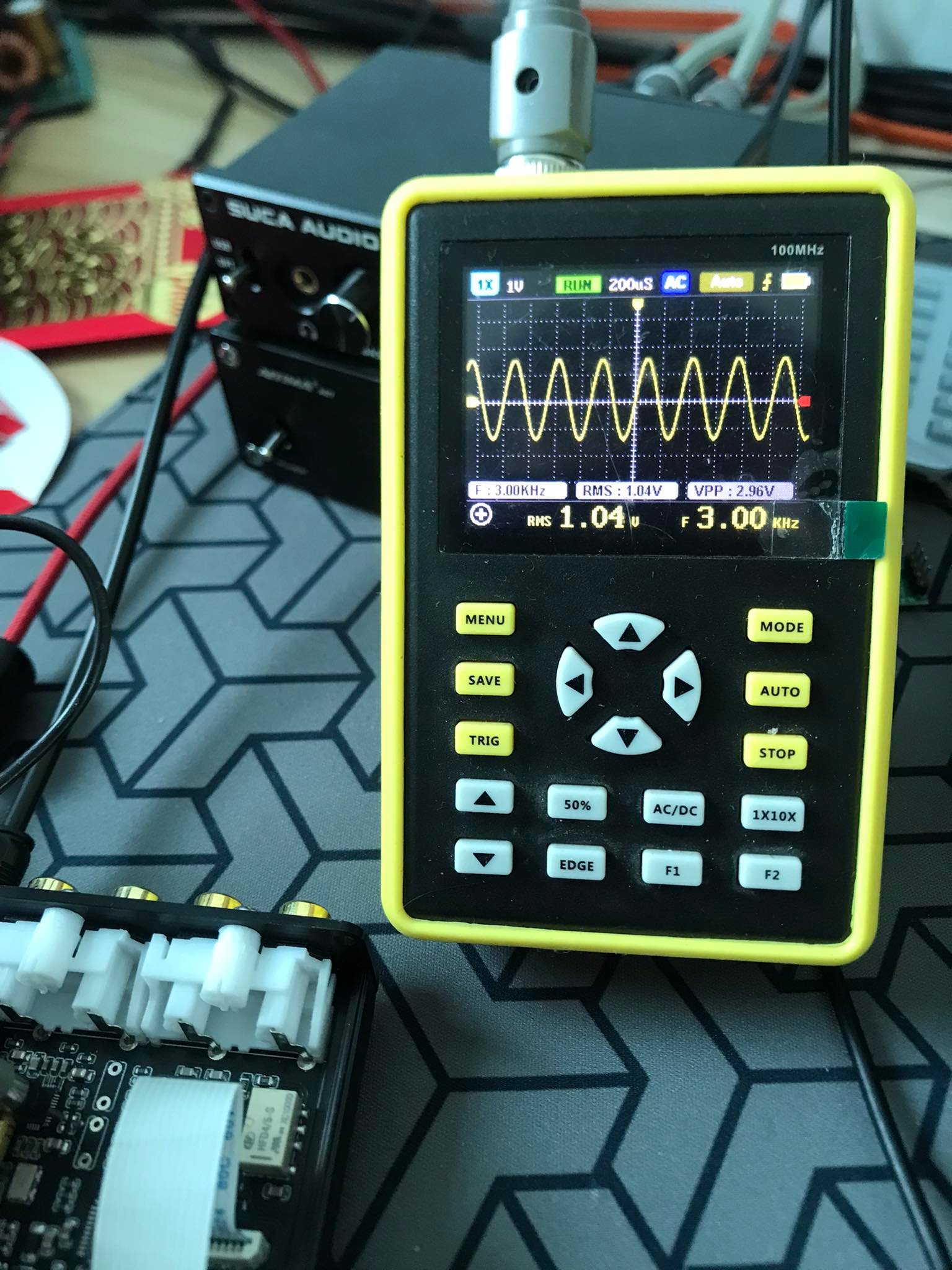

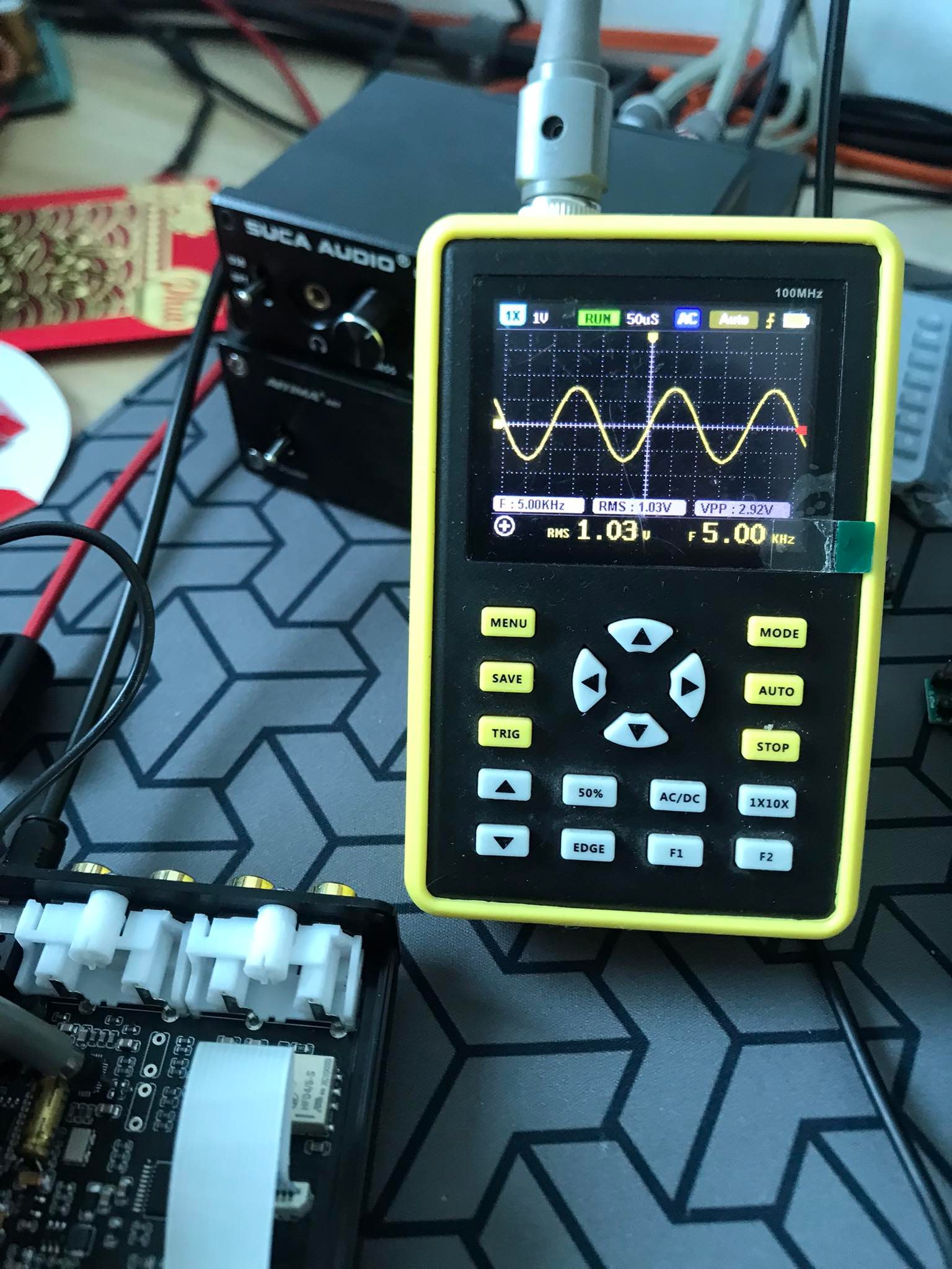

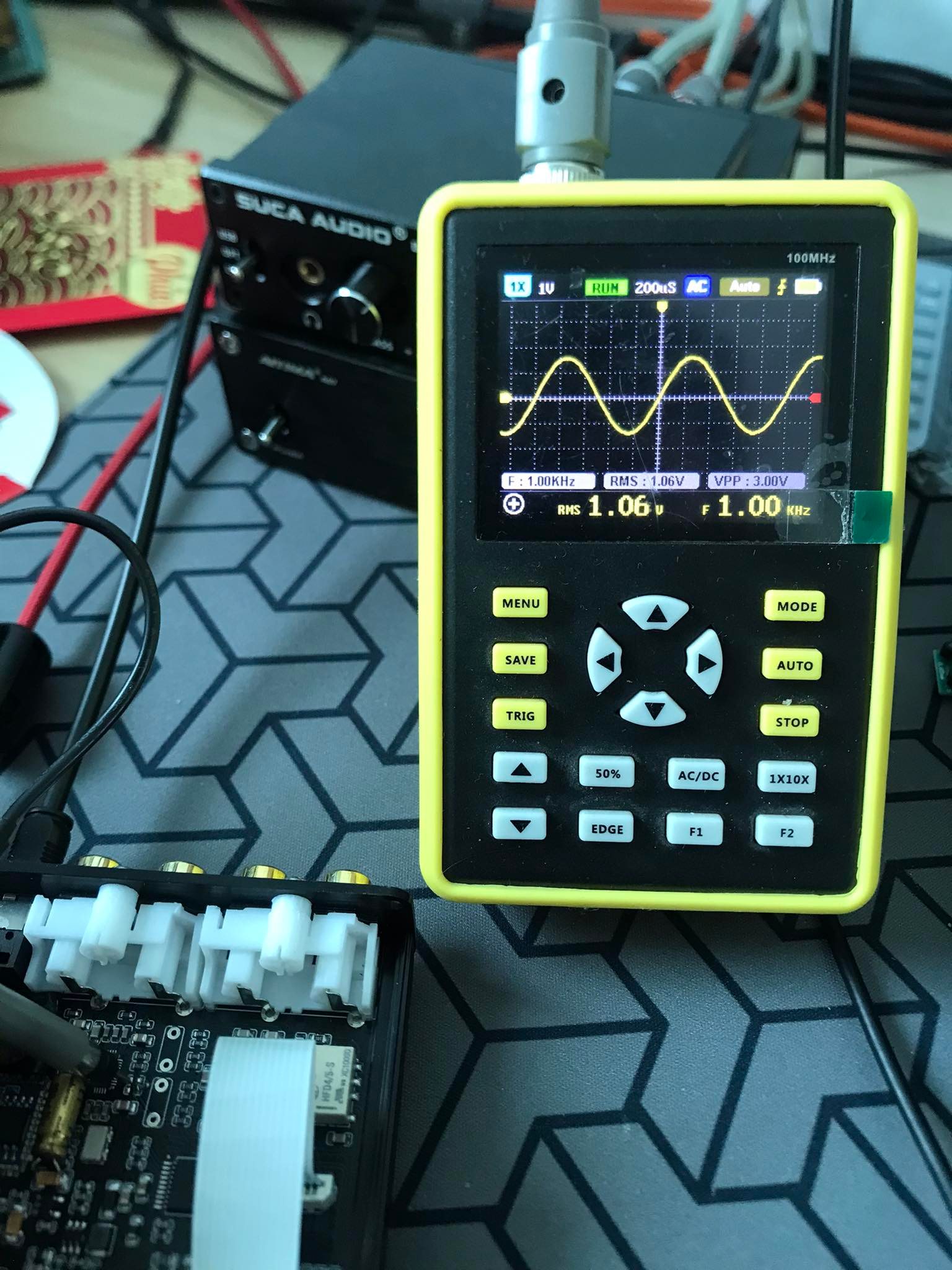

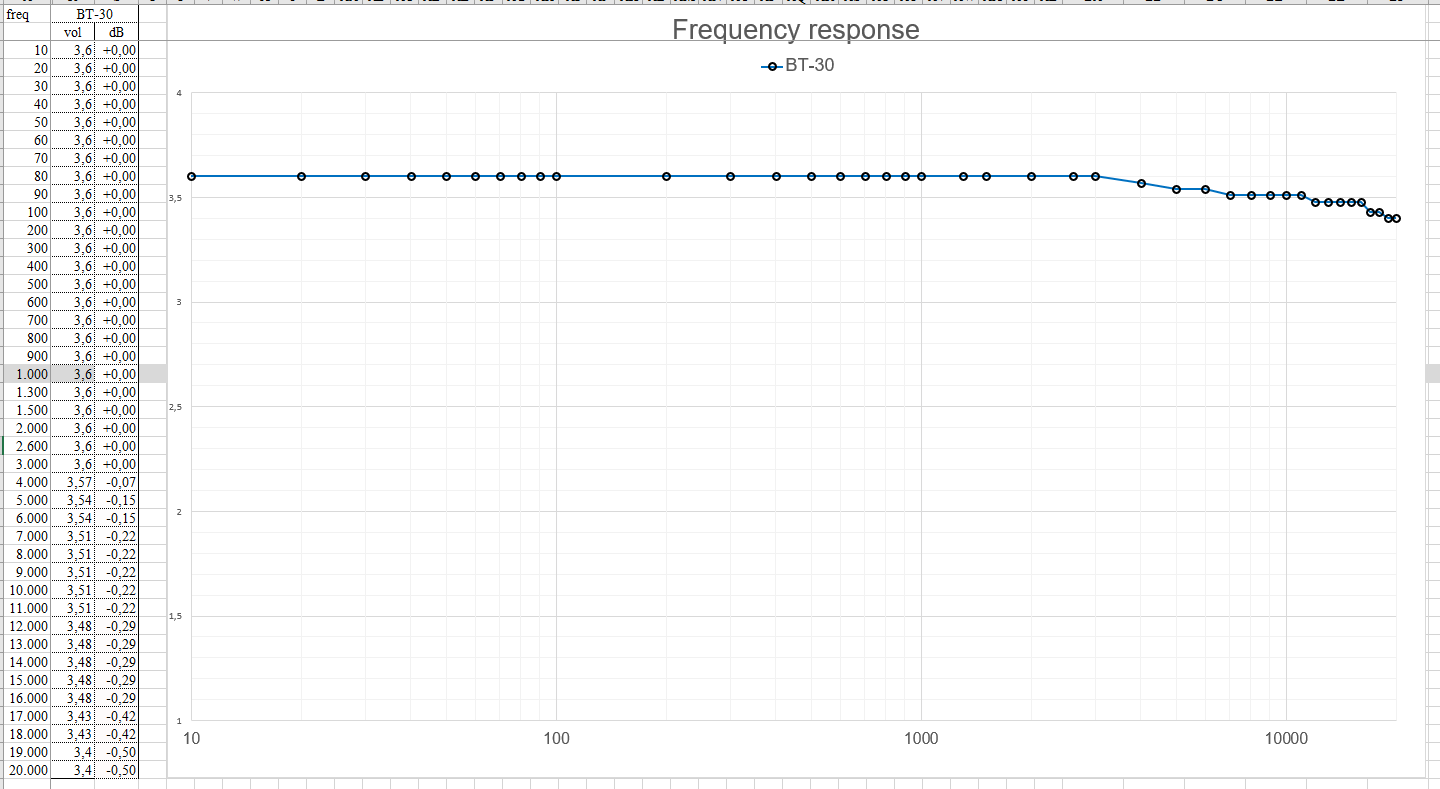

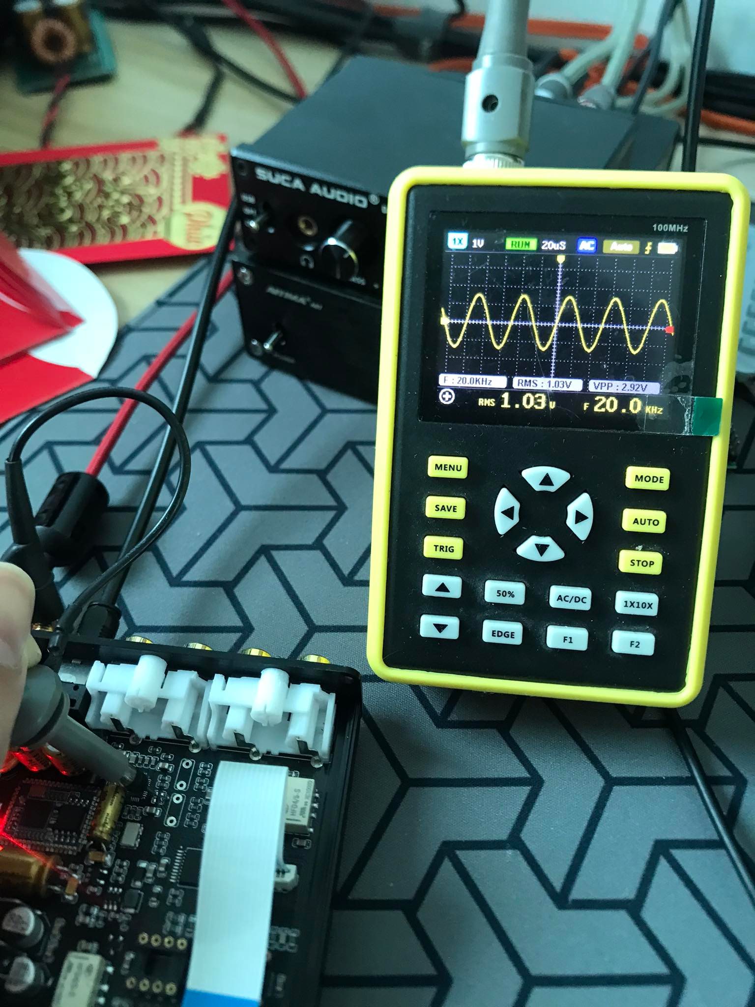

i take out 2 first resistors from chip output and measure right there, signal drop 0.03V RMS only (from 1.06V@1kHz to 1.03V@20kHz), so i think problem not came from internal filters
After that, i resolding and measure without 2 wima capacitors, the freq response still have little drop but not too much at 20kHz like before

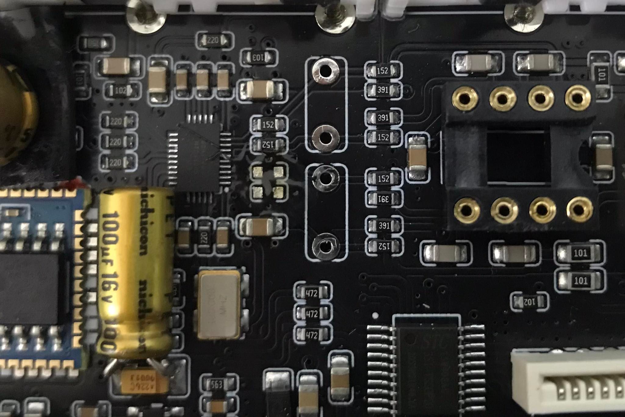

The output stage on your dac has clearly the same topology as in the schematic of the original board in this thread (voltage output). Same schematic you showed here:
https://www.diyaudio.com/community/threads/es9038q2m-board.314935/post-7240000
Only the resistor and capacitor values are different. Resistor values can be seen in the picture but have you measured the Wimas and the SMD C0G capacitors next to the opamp?
What the other 2 opamps are for is unclear.
-0,2 dB in output @ 20kHz it's good.
It remains to simulate the analog output circuit with SPICE as I had proposed above ;)
I think it is also necessary to take into account the details of bohrok2610 which we welcome and thank in passing (y)
It is possible that the 'additional' OPAMPS can form a high pass and a low pass before the audio output: the best would be to bypass them :rolleyes:
Less often equals better in audio...
2 wima are 220/100v. smd c0g are 10p, i also removed them on 1 channel and compare with second channel but nothing different
2 additional opamps, one i think preamplier with gain high, last opamp gain ratio is 1, i guest it for more stable. This DAC has 2 mode output, one direct to 1st opamp, one is through all opamps to get louder signal

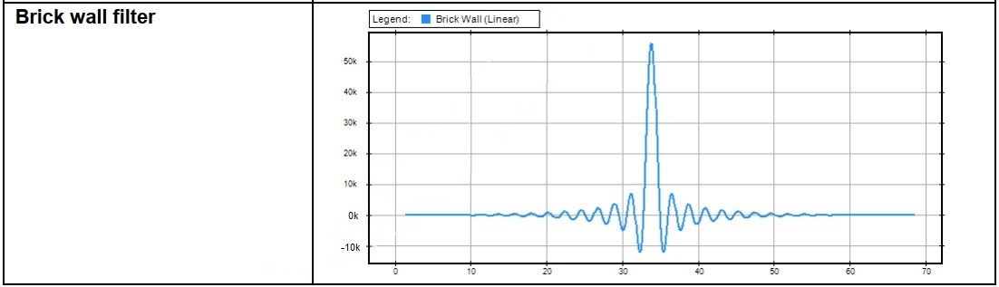

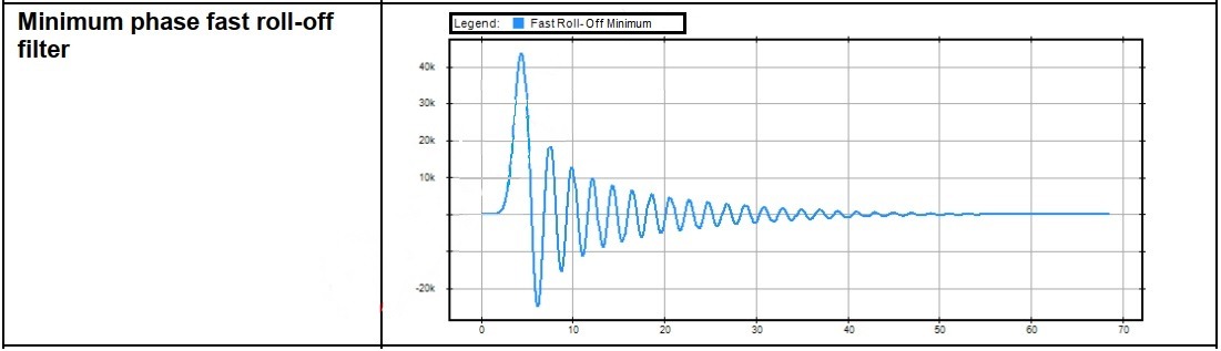

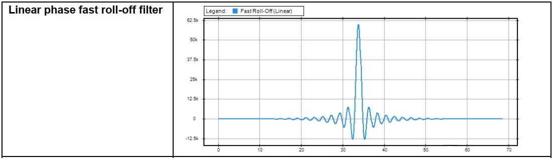

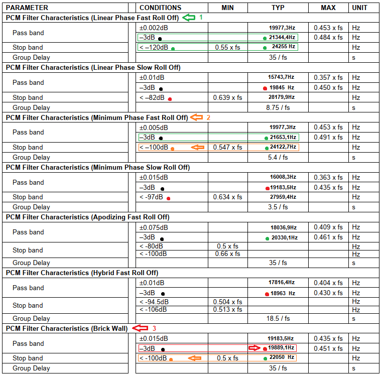

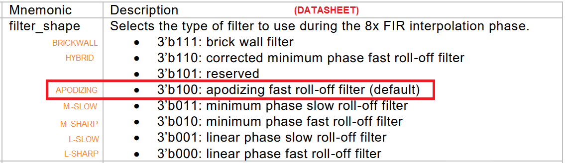

Let's go back to your table with some of my 'additions' ->

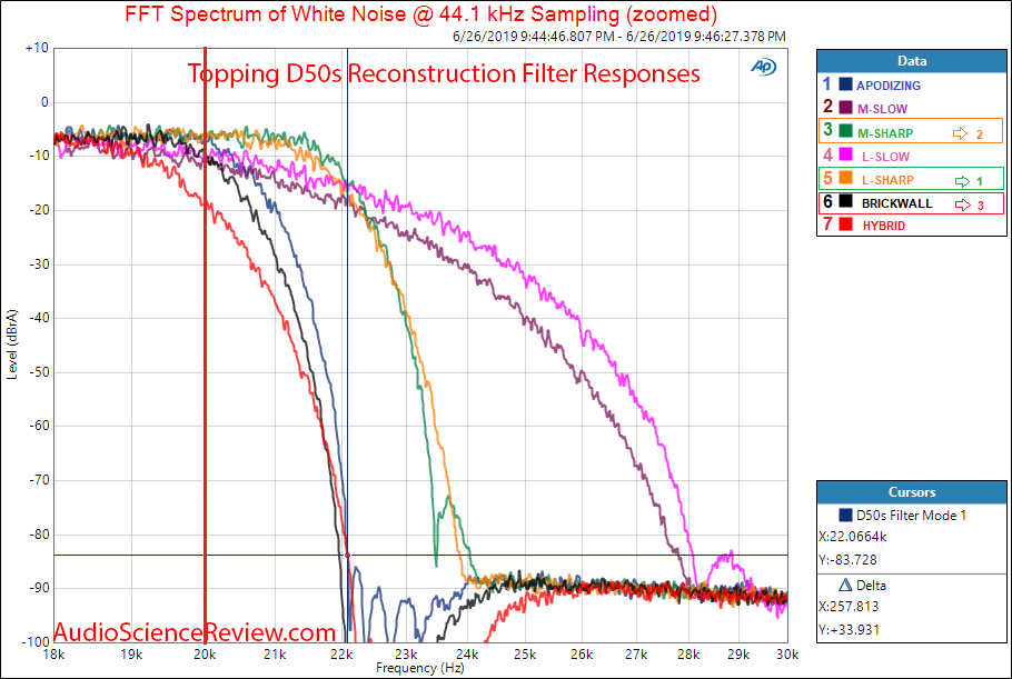

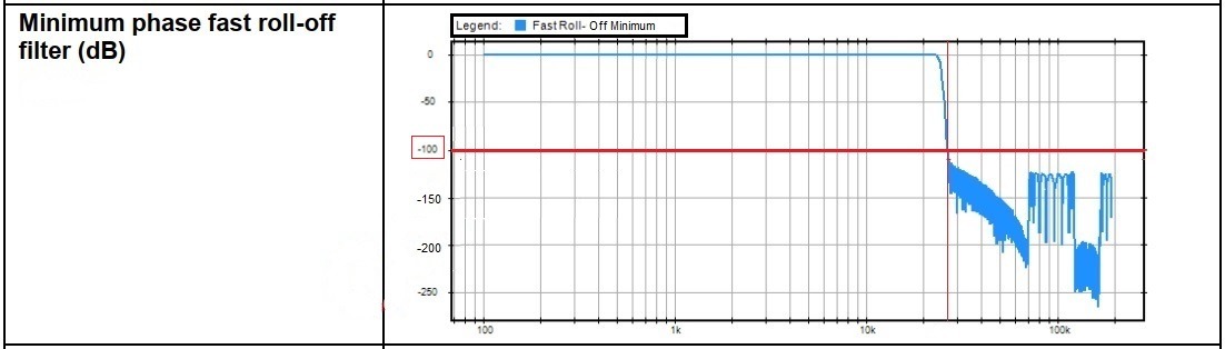

Shape of the graphs according to FIR used for the D50s TOPPING DAC (same ES9038Q2M chip) ->

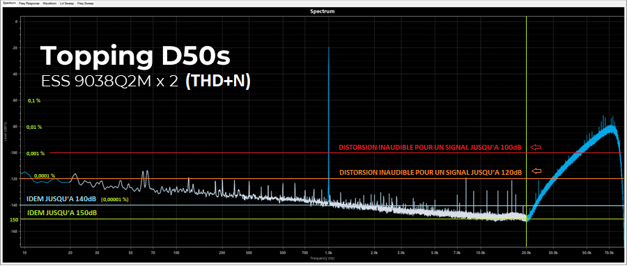

Short reminders on the 'notion' of THD ->
Even at -100dB, the distortion is inaudible to the human ear, it's a fact :)

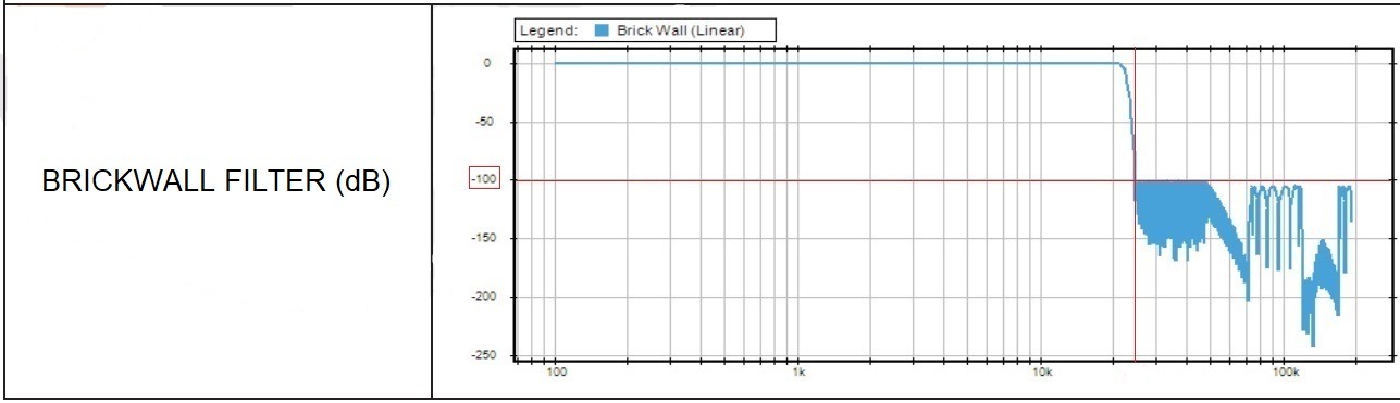

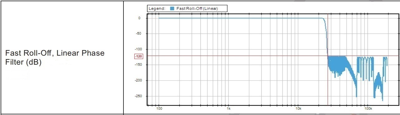

Now, if we focus on the values mentioned in your table, we can say in a way that only 3 FIRs (*) are in line with the 'hi-fi standard' (20Hz to 20kHz) ->
Now to reproduce the frequencies at the extreme bands (20Hz and 20kHz), I wish you to have speakers but also and above all a room capable of reproducing them correctly but that's another story...
Regards ;)
(*) = Linear phase/fast roll off, Minimum phase/fast roll off and Brickwall up to 19889,1Hz 'only')
PS: note that the Minimum phase / fast roll off will have a slight tendency to 'inflate' the low register while the Linear phase fast roll off will give a more 'punchy' sound reproduction.

As long as we use the FIR 'Linear phase / Fast roll off' THD @ -120dB at least we will be sure !
