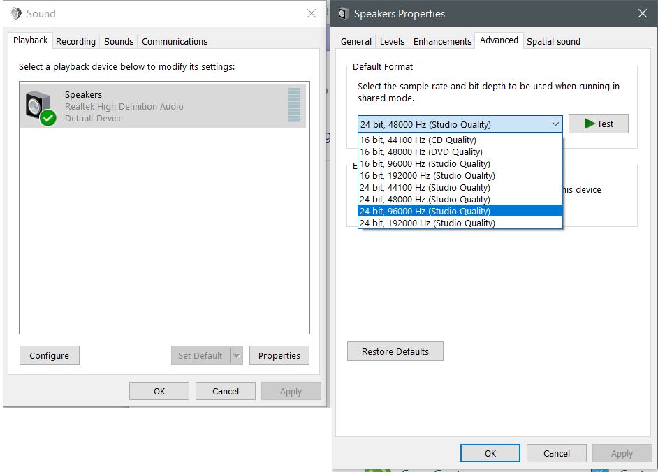

I put some short excerpts of a CD rip up at different bit-depths and sample rates for educational purposes. Even with my laptop soundcard, there is a noticeable difference which many people might be able to discern. But it doesn't matter all that much in terms of getting really accurate sound quality until the DAC itself is as high quality as possible. DBX
Please remember that Windows and other OSes will resample for you without warning. Please set appropriately for the desired file playback mode.
Once upgraded the Chinese DAC can be pretty nice but no matter what it won't get all the way up to Benchmark level.

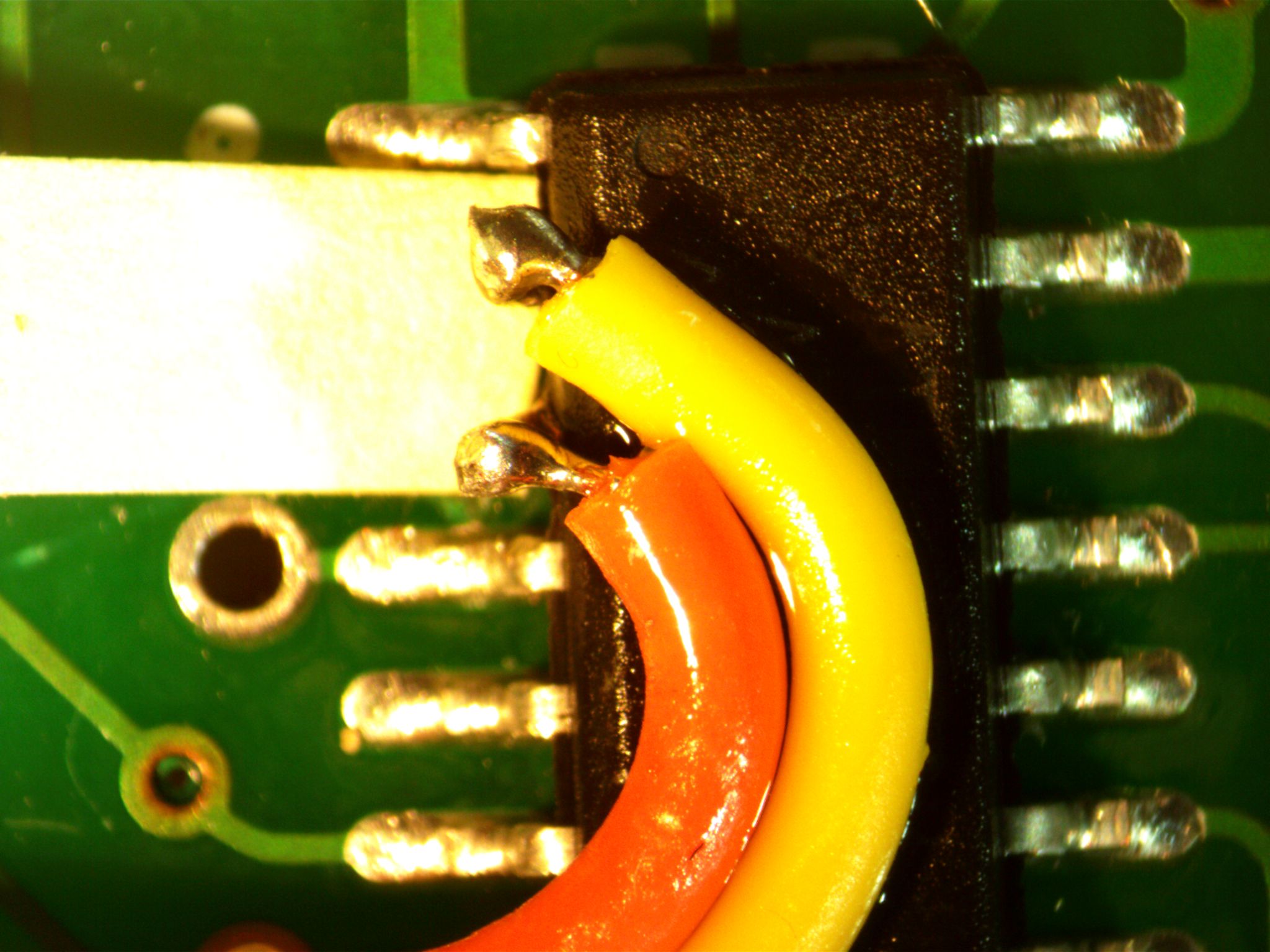

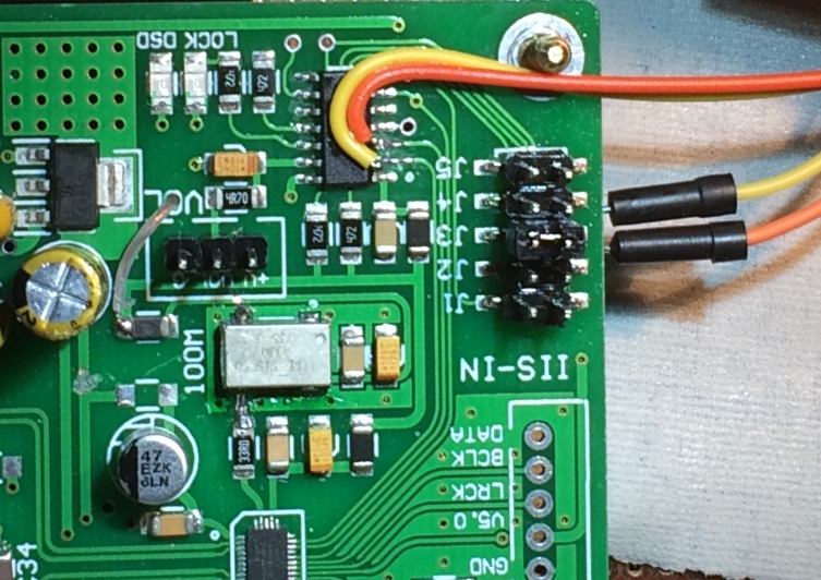

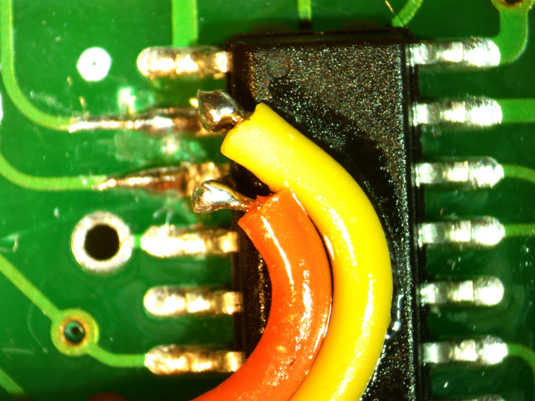

Now getting set up to start taking control over the DAC. Microcontroller I2C pins have been lifted and leads attached which can be patched back into an I2C bus socket on the underside of the board. The socket connects to the DAC I2C pins. Shiney stuff on wires is superglue to tack them down. Will unplug this microcontroller and substitute Arduino I2C leads with software real-time peek and poke serial monitor, at least to start with. From there can start coding and testing using the same app.
