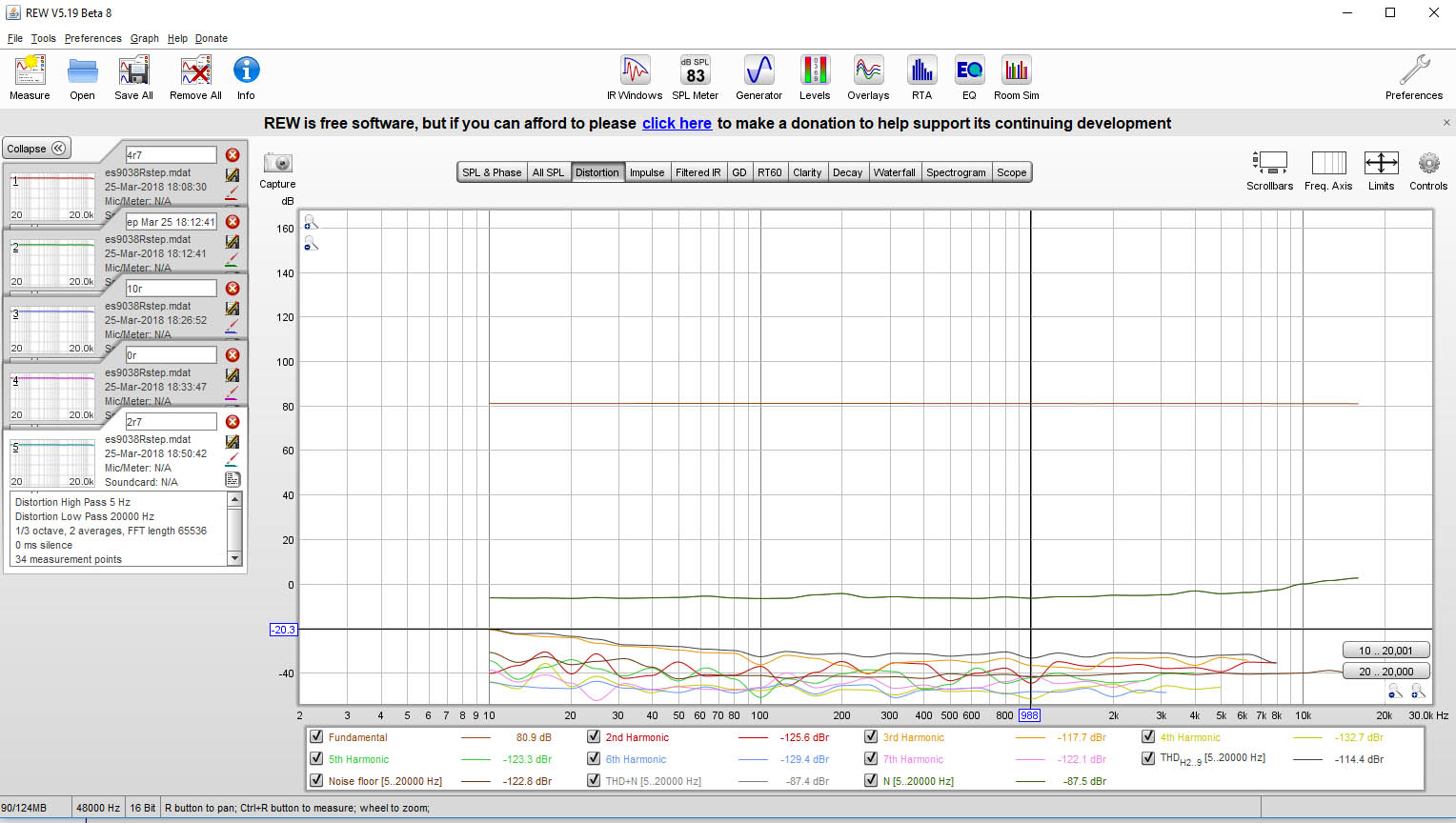

Measurements on AudioScienceReview
Measurements Of Generic ES9038Q2M DAC Board | Audio Science Review (ASR) Forum
Thanks for the link; as I suspected, cleaning up the power and putting a proper I/V on the back end (acknowledging Vacuphile's experiments) closes the loop tidily. Everything else points to tweaking things for the sake of.
ESS claims the Q2M can reach -120dB distortion. From the looks of it at this point it will take harmonic distortion correction to get down that far. With good hardware circuit design it should be able to get down below -110 it would seem, maybe a bit more. Don't think distortion correction is likely to give much more than right around what cdgames reported, which was about a 5dB improvement for each of the 2nd and 3rd partials. Maybe a little less than 5dB each.
