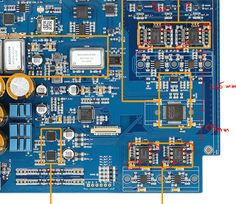

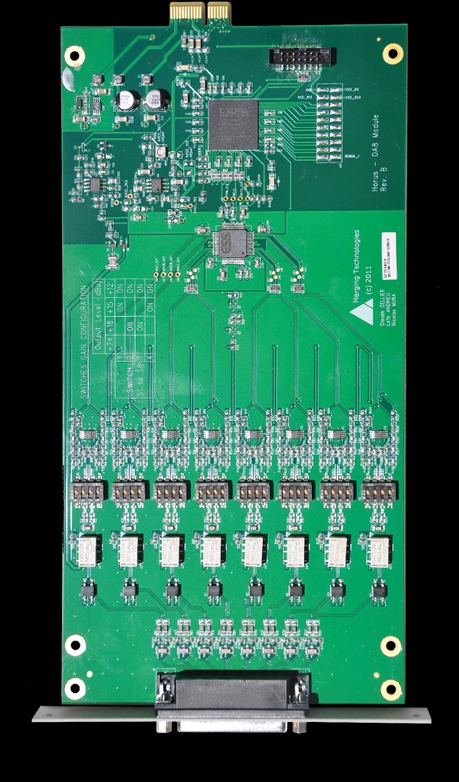

Pic below of an ESS based dac board that keeps the opamps well away from the digital stuff. Could conceivably be cleaner with that distance. A filter before the I/V might help some too. However MKHunt's dac board doesn't appear to be implemented like that. Is his dac implemented like yours?
Actually, have measured with an E-field probe and spectrum analyzer. RF is everywhere inside the dac box. However, conducted RF from the dac outputs can be attenuated with distance using some kind of distributed filter. Have done that too, and found it can help.
Then I suggest you spend some time studying how to mitigate EMI/RF issues. There are better ways to achieve that instead of increasing distance or using OPA1612. But of course hacking boards made by others instead of designing them yourself seriously limits the options.

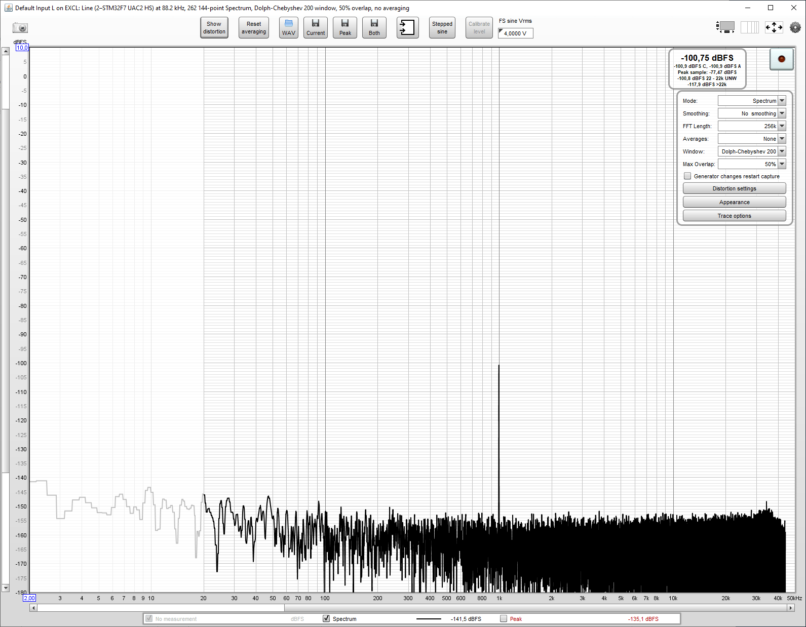

Here is my ES9038Q2M board powered with my LT30xx switching regulator board hanging directly above the dac and LM4562 with distance of less than 20mm (or 3/4 inch) component side to component side. Dac playing -100dBFS 1k signal. No averaging.
BTW no effort was made to shield the boards. All boards (DAC, ADC, PS, USB-I2S) were laying on my desktop directly in front of my LCD monitor.

Your previous argument was based on PMA's measurements. My measurements show no such issues and the soundstage is fine. But sorry to hear that your DAC is riddled with EMI/RFI.

Sorry, I have learned not to rely on your claims about sound. Not using XMOS or CPLD. E.g. I2S signals are clean without any clock edge harmonics. While your dac suffers from RFI/EMI does not mean that properly designed dacs do as well.
Okay, use that one then. For ES9038PRO the evaluation board uses OPA1611/1612.
DAC chips themselves directly emit radiated EMI/RFI of clock edge harmonics up into the hundreds of MHz if not higher. The emissions come right through the plastic QFP or whatever the case shape is. No way to stop it other than use a shield can or equivalent. Allo used shield cans over the clocks on Katana and Revolution dacs. Since they are measurement guys, they probably measured some benefit form doing that.
Just a little food for thought regarding the 9038Pro recommendation. 9038Q2M can output 4.XX mA per channel (2ch max) in current mode. 9038Pro can output 15mA per channel (8ch max) in current mode.
OPA1612 has over twice the current handling capability and is r2r out whereas LME is r2r none. Looking at another DAC I am intimately familiar with, the general topology is not that different. In fact, the ESS chip is even closer to the follower opamps than in the cheap DAC. There aren't even any metal electrolytic cans physically between the two.

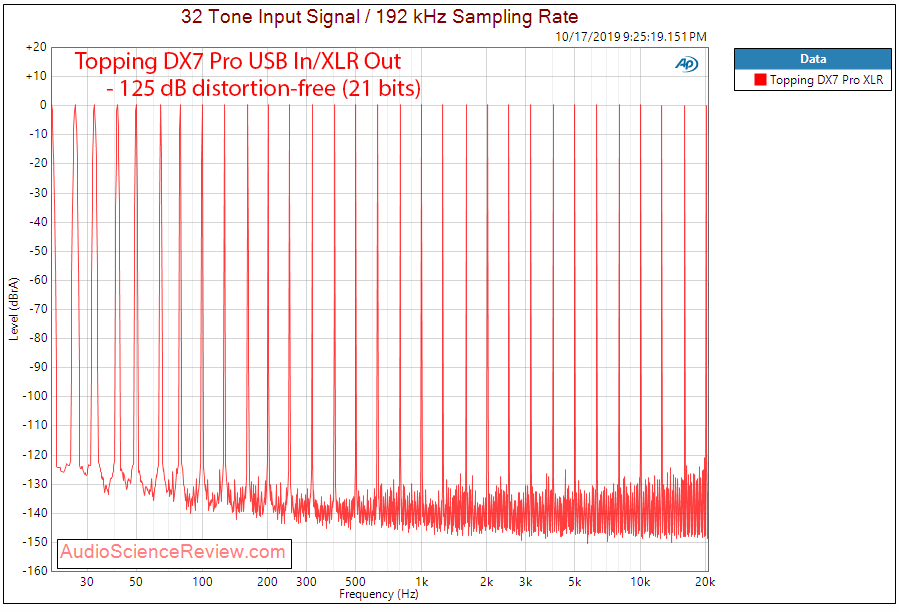

DX7 Pro. 47920 voltage followers:
Multitone:
If I lived in a soundproof chamber and had never set foot outside, been on an airplane, ridden a motorcycle, etc then maybe. I do believe that the 47920 picks up RF; of that I have no doubt. I just don't believe it would cause oscillation (in this application) nor in-band audio problems at a real-world audible level as a voltage follower.
Regarding soundstage.... my DX7 Pro with 47920's as followers feeds my P308 MK2's in my PC listening space and soundstage is spooky. I have been tricked by background in a well-recorded video having a door that sounds like my entryway. Granted, that is a 9038Pro board; and it even uses AD8397 which looks like some unholy noise machine by OPA standards. But it sounds awesome and measures well below audibility.

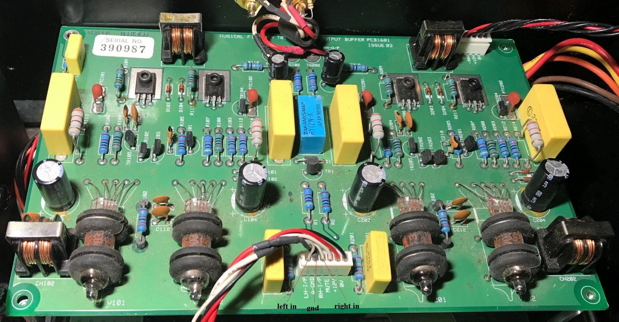

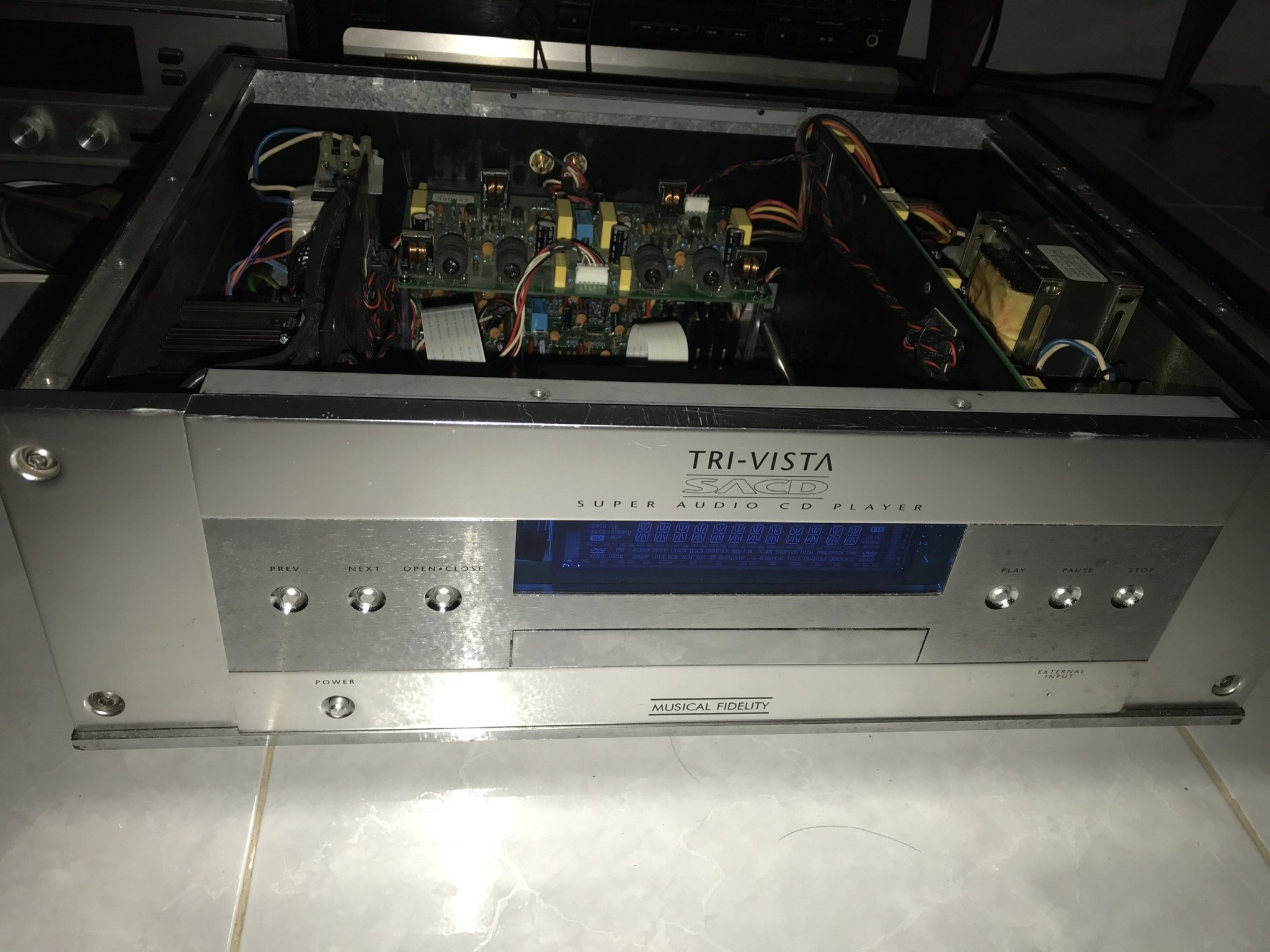

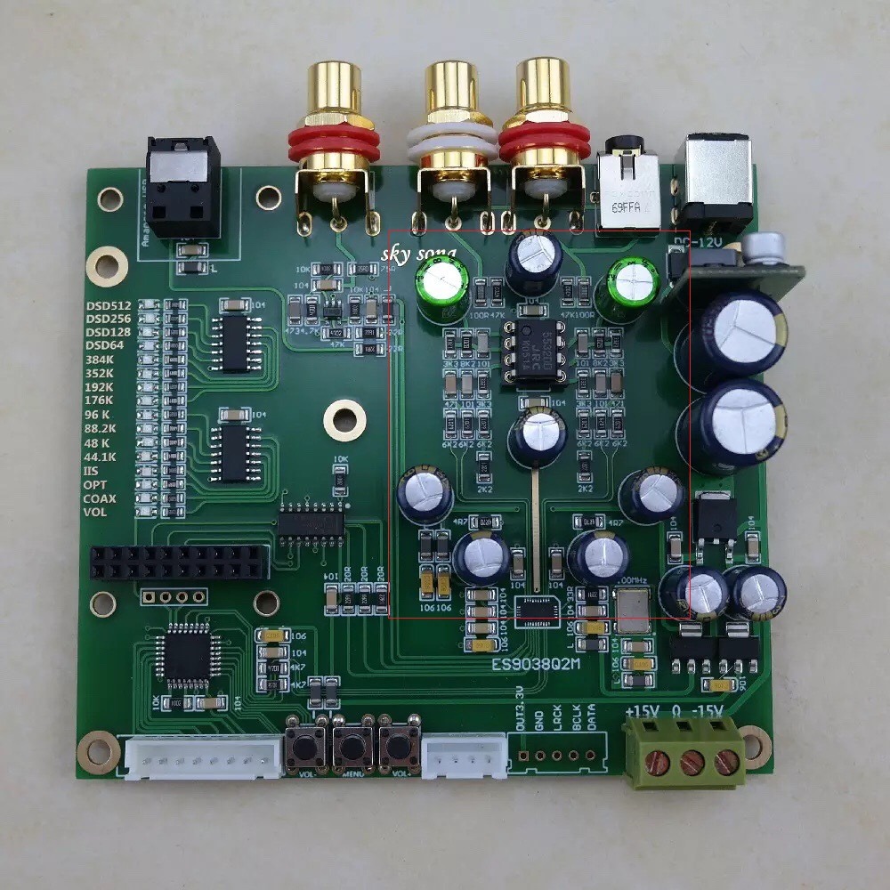

Dear Sirs,
I have a broken Musical Tri Vista SACD (bad DAC board & CD transport). Power board & tube buffer is good.
I bought DAC board ES9038q2m skysong from ebay.
I use Tri Vista's power source (+-15v) to connect the ES9038q2m
and ES9038q2m 's RCA output connected to tube buffer, sound is good but gain is small.
Please help me how to connect ES9038q2m -> buffer to increase gain or make the sound

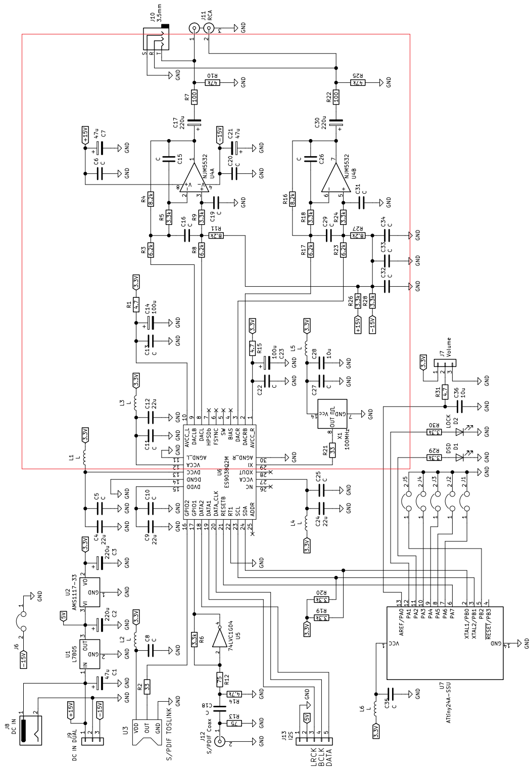

Dear Sirs,

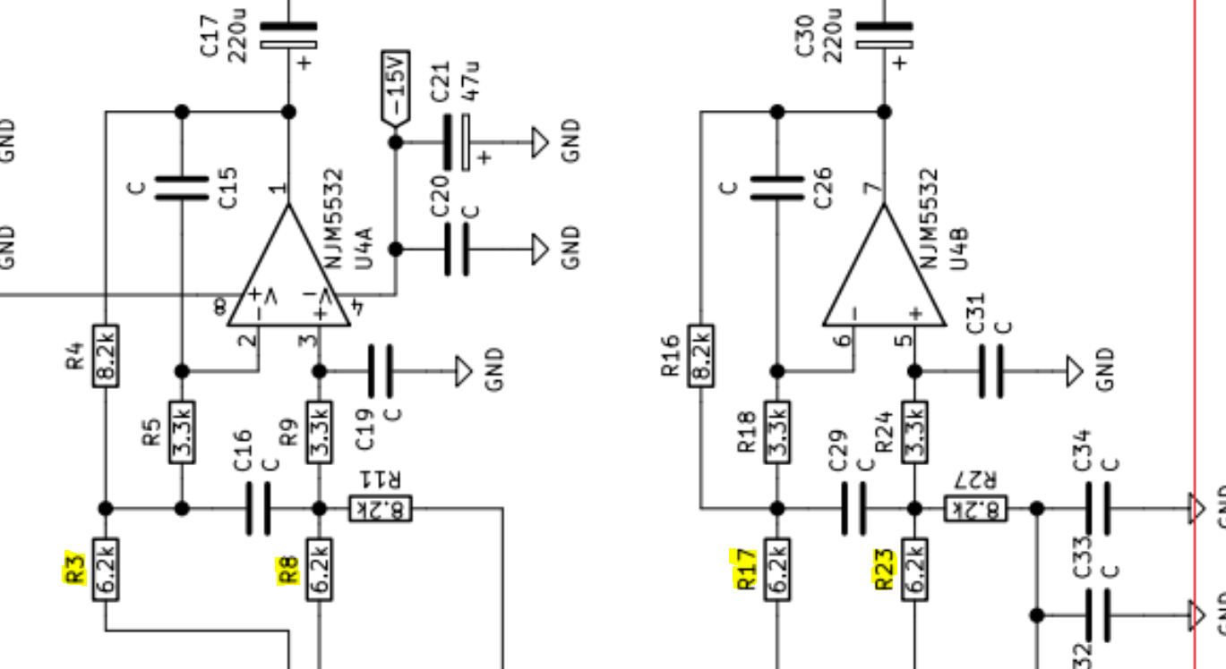

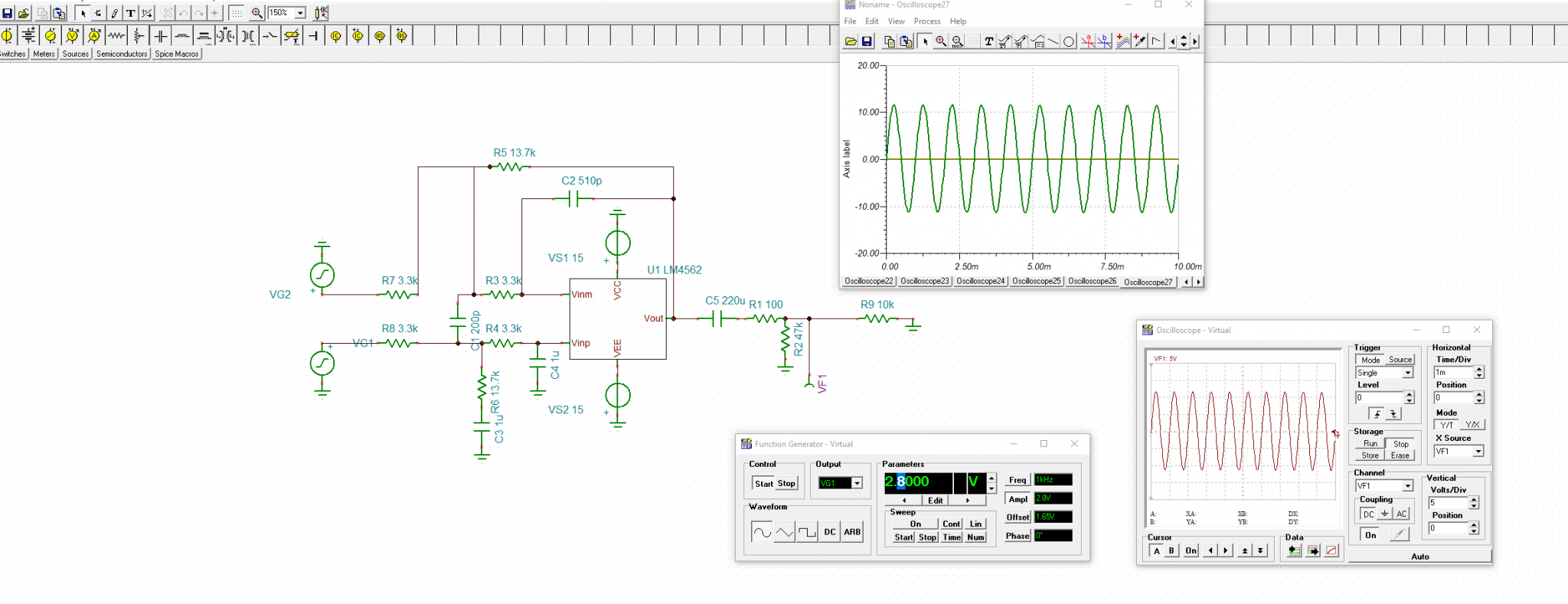

Swap these to 3.3k and you can get about 20-40% more output.
If that is not enough then you can also also swap the 8.2k resistors for 10k or 13.7k units. You will not get more out of a 15V bipolar supply.
But if you have an RMS multimeter, I would measure the present output because it is probably already a little spicy.
SIm output using max values on 9038Q2m datasheet.
