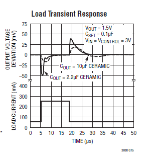

Like I said already the graphs are not comparable as the capacitor values are not the same.
In which case you have no basis for any claim of similarity based on those graphs.
Of course I have no 'proof' as science isn't concerned with proof, that's the domain of mathematics. But seeing as those graphs ostensibly show the LT1083's load transient response is of the order of 20dB better than LT317 I'd say @Markw4 has some objective basis for his claim it sounds better in that particular application.
Also your claim of "order of 20dB better" has no basis as the graphs are not comparable due to mismatching capacitors. Why do you think there would be 20dB difference with similar load regulation spec?

It seems reasonable to me that LT would wish to paint their parts in the best possible light in their DSs. So to me its a fair comparison to contrast the dotted lines in both instances.
Because that's what the graphs are showing. The load regulation spec omits details (what's the frequency?) so I'm going in favour of the graph with the more relevant details.
Another relevant observation here is the load regulation spec is at constant die temperature. But that's not a real-world situation - the LT1083 has better thermal conductivity die to case (which is shown in the DS).

@lasercut - that might indeed have something to do with it. So for LT317 to be similar to LT1083 in transient behaviour we'd need to see how it does with 10uF output cap - does anyone have that data?

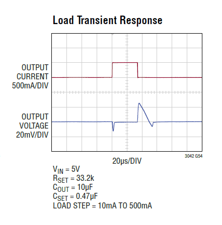

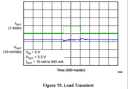

Edit: here is one modern LDO.
Just go with the context that the DS gives for now.What context might that be? Markw4's comment did not specify any.
Is there a typo? 500mS/div? If not, that's showing appalling thermal tails.Edit: here is one modern LDO.
Clearly worse than LT1083 - 22mV deviation on the negative going transient vs less than 100mV for LT1083 with 15X the current step size. To be fair that's not quite apples to apples as the initial current is 100mA for LT1083 as against 10mA here. Output caps are the same.

Same output cap though probably lower ESR as its ceramic. Current step size 200mA and 15-20mV deviation. Clearly poorer than LT1083 but pre-load current 50mA vs 100mA.

You're free to trust them as you wish. But your arguments seem to me to be very hand-wavy rather than rooted in the physics. With 500mS/div on the first one I can't see how that's particularly 'wide bandwidth'.
