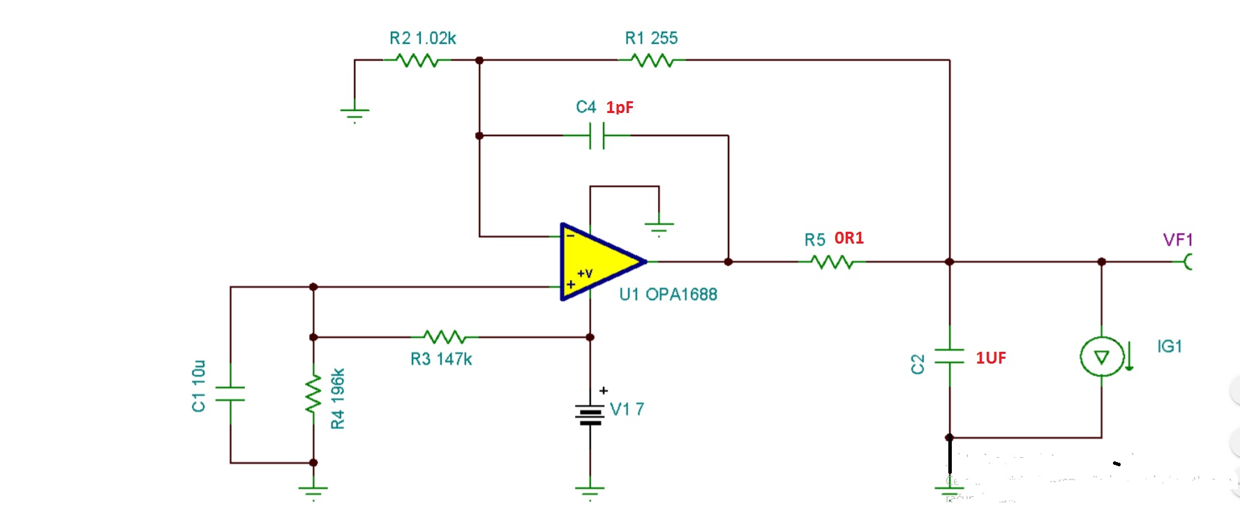

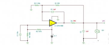

JensH...do you think that Ti had made schematic drawing mistake
Can you simulate this one ?
Very slow ramp up time.
All LT3042's, you think?
I thought you had already crossed those off the list, at least for the Sabre.
So, the question might be 'what does the 797 based VREF do that the LT3042 doesn't'?
Here are some specs to contemplate:
