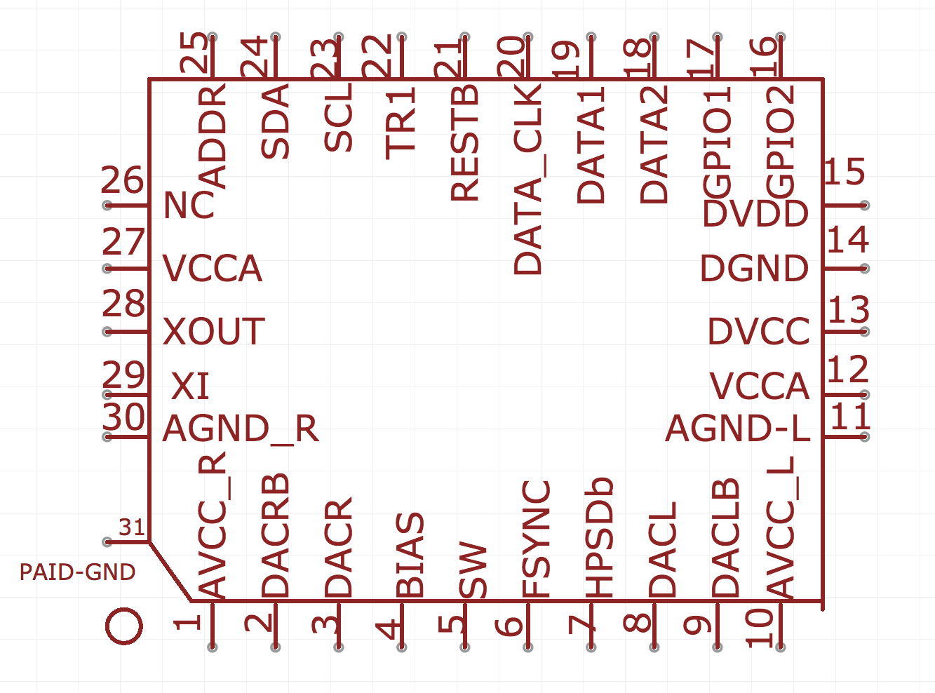

2. Which DAC outpins pins connect to the Vref R&L input on the Output Stage Board, is it AGND L&R?
If you look at the pinout diagram for the dac chip you can see there are two outputs for each channel. One of each has a letter 'B' suffix or other indication that it is the inverted phase output. In the output stage, all the I/V opamp circuits are inverting, so both dac outputs will be inverted there. In the next opamp, the differential summing amp, the output from one I/V is inverted again, and the other one isn't. That subtracts the two signals to take the difference. The signal that gets inverted there will have been inverted twice in the output stage, thus they cancel out and it will be un-inverted at the output. That signal should in theory come from the non-inverting dac chip output. In the schematic that MrSlim drew, he labeled the I/V inputs correctly to show which inputs should come from which dac chip outputs. Also the dac chip is arranged with outputs symmetrical about the center axis. The way I built my output stage, the outputs are also symmetrical about the center axis of the dac board. So, if the outer dac outputs are connected to the outer (or inner) I/V opamps, it all works out okay. That is to say, if the phase of the left channel is reversed, it will not hurt the sound so long as the phase of the right channel is also reversed. The most important thing is that both channels are in the same phase. I will attach the pinout diagram of the dac chip below for reference.

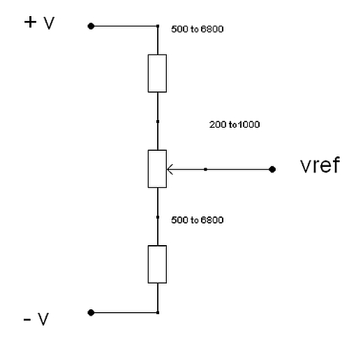

hi, there,
the vref is not related to the avcc but the opamp power supply, if that's +5v supply the +v to 5v, the -v to gnd, if that's +,- 15 v supply the +v to +15v, -v to -15v. pls see the schematic attached.

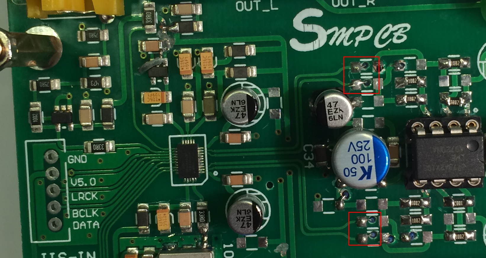

Hi Paul,
If you haven't modified the original AVCC circuit at all, you can pick up 3.3v from the bottom of the board where the existing through-hole AVCC electrolytic filter cap leads are soldered on. There is one cap for each channel. One lead of each existing cap goes to ground, and the other lead that is closer to the dac chip should be the one you want.
EDIT: While you are working in that area, you might be able to temporarily improve sound quality somewhat by tacking on some more electrolytic caps in parallel with the caps where you attach the AVCC wires. One fellow by the name of victor used three 1800uf electrolytics in parallel for each AVCC channel. He said it helped reduce harmonic distortion a lot.
Regarding where to pick up the dac chip output signals, you will need to unsolder and remove two existing SMD resistors or cut the traces leading to them from the dac chip and attach there. Probably easiest just to remove the resistors and solder your leads onto the existing solder pads (you can replace the resistors later if you really decide you want to). I drill a tiny hole between the two resistor solder pads and run a piece of #28 or #30 wire wrap wire though each hole, then solder one to each pad going to the dac chip. On the bottom of the board, twist the wires together and route them to the I/V inputs (keeping track of which wire goes to which dac output).
A pic below shows the dac output connections outlined in red.

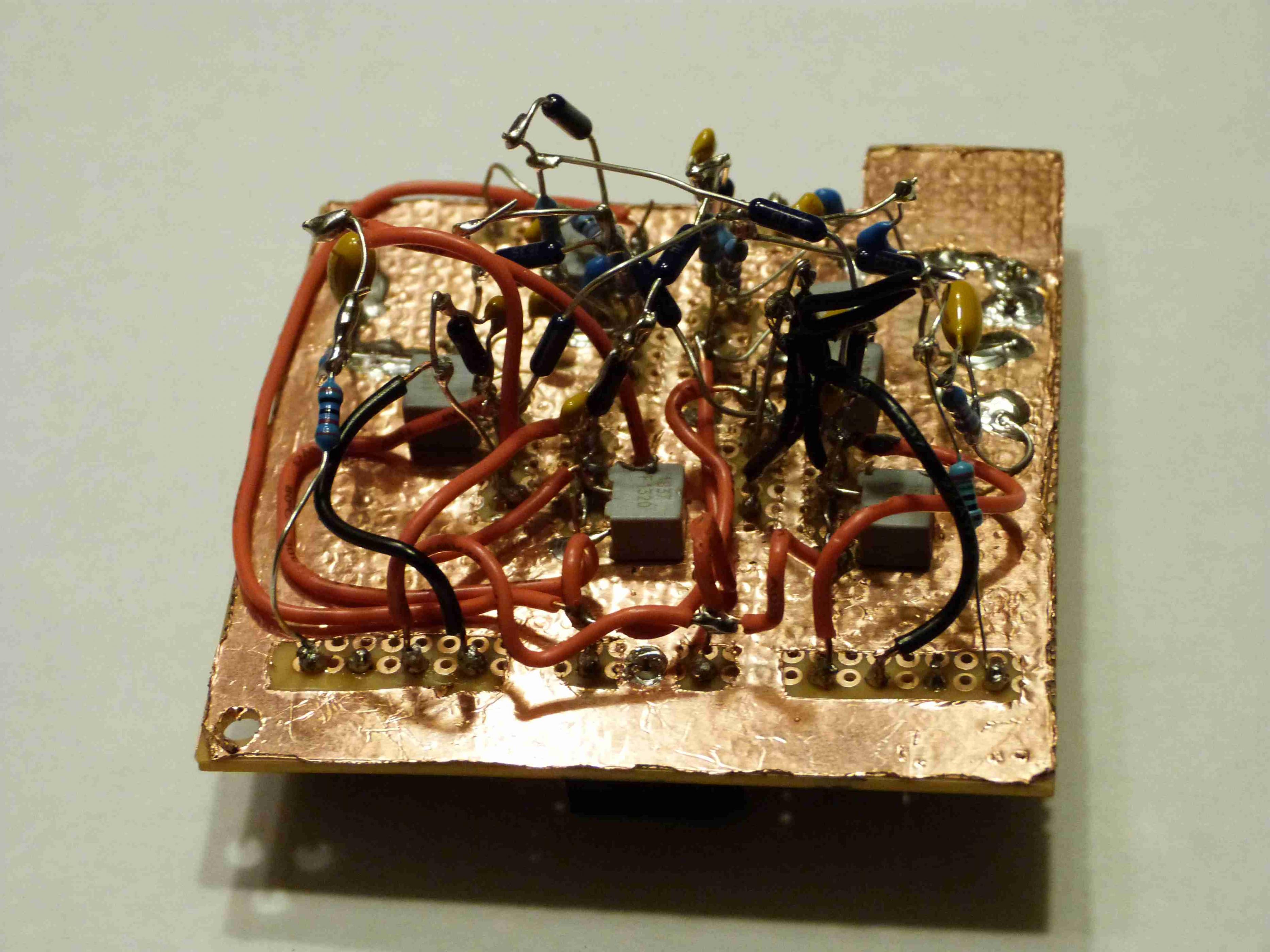

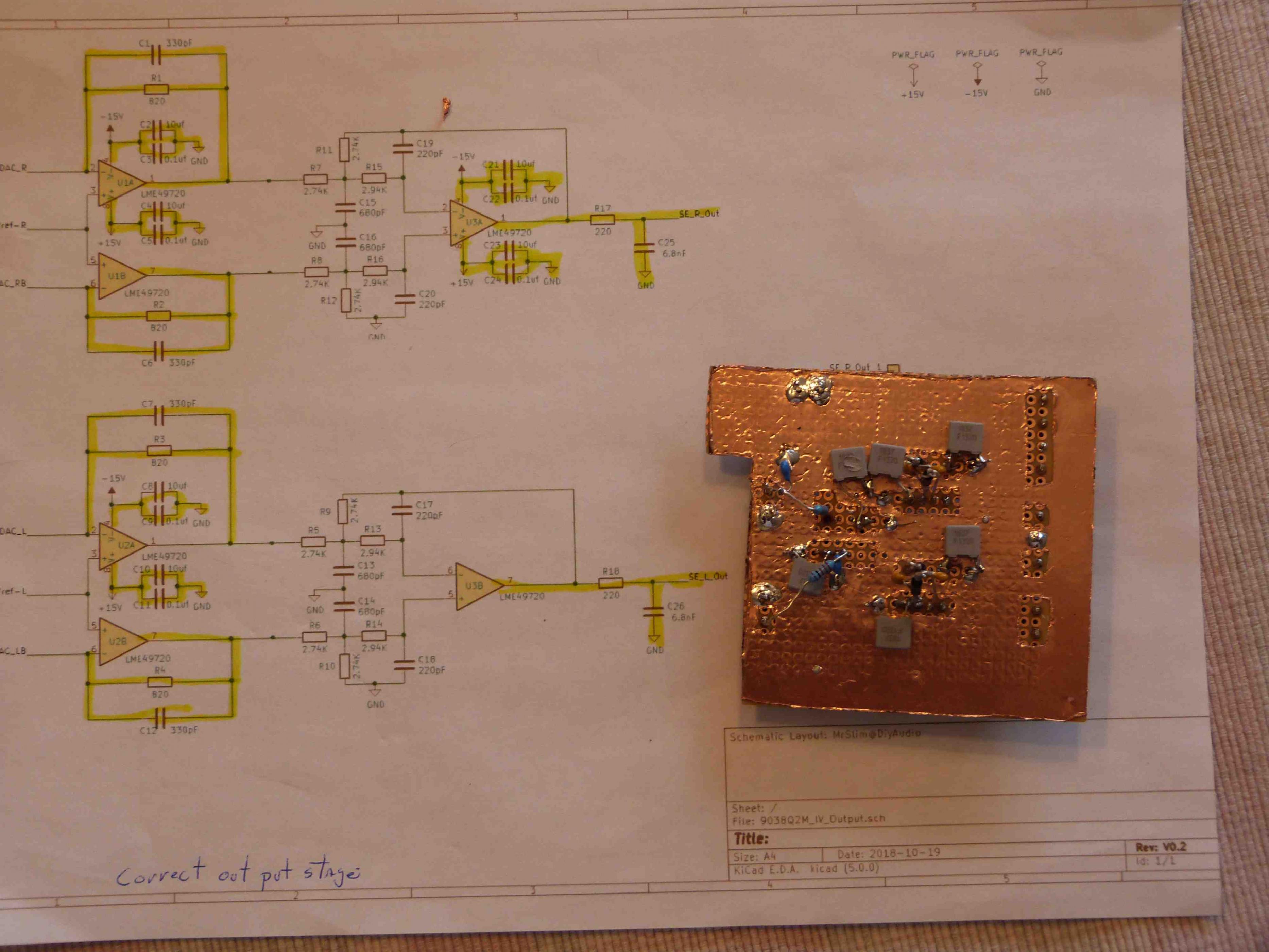

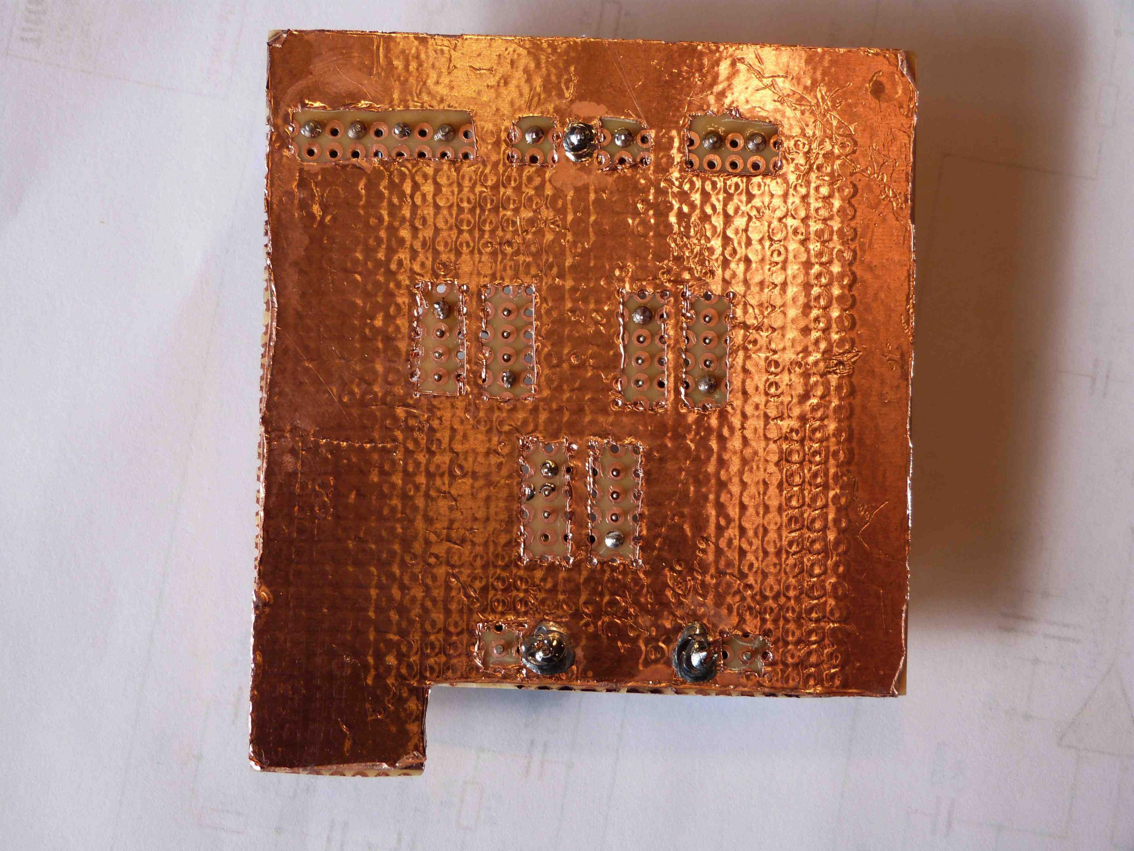

Hi Mark,
Finally done the output stage. This was my first attempt at point to point soldering and was a real challenge for me. It looks a real mess, had I known how tough it was going to be for me I would have opted to buy an output stage from Twisted Pear. But all in all it was an educational experience. I haven't tested it yet but here are some picks of the build, sure hope it doesn't go up in a puff of smoke. Because of the case I have the dac in I need to mount it directly above the dac, no room to do it any other way. I'll test it out later this week. Thanks for all of your help Mark.
Paul

Hi Paul,
Thank you for posting pictures. I wonder if there is anyone you know who could trace out and double check all the connections to make sure wiring is okay before applying power?
Other thing is, the output stage ground plane is supposed to be part of the dac board ground plane, all in one continuous plane. From your description, you won't be able to mount it that way, but anything you can do to keep inductance low between the two ground planes would probably be a good idea. A wide flat piece of braid taken from a shielded cable might make a some kind of ground strap which would have less inductance and resistance than wire. Or maybe copper foil could be attached to cloth tape backing to make a wide ground strap. Maybe see if you can think of anything like that.
From the pictures, looks like you decided not to take my advice and do most of the wiring with very thin gauge wire wrap wire. Any reason for that? (I only suggested using larger gauge wire to the opamp power pins.)
Also, I see some resistors in the picture that don't look like .1% metal film. Are they?
If you at least have a DVM that can beep to do continuity testing, that can help to trace from the opamp socket pins back to wherever they connect to. Resistance readings can also be checked between nodes to see if they make sense.
It is good to read that despite the difficulty, you found some value in going through the experience of doing it. Most likely, you would plan things out differently if you ever did something like that again, I guessing. 🙂
In worst case, I presume you have some back up plan, like fix it if you can, else buy a TP version? I would hate to see you or any of the guys feel like giving up. I have blown stuff up before and almost always been able to fix the damage, even if it took me a couple of days. Always learn lessons to remember when something like that happens to me.
If you do have any trouble getting it to work, by all means ask before getting in too far over your head. We will try our best to help however we can.
Last of all, to all the guys who have a lot of difficulty with this through hole version, I promise that will only a little practice beforehand, SMD would be a lot easier. I know it looks scary, it scared me too before I decided to try it the first time. After the fear factor goes away, its not hard except for the super tiny things, and we either don't use any, or we have special tricks for the ones we do use.

Hi Mark,
I didn't decide not to take your advice on the wire, I forgot about it and used wire that I already had on hand. It was pretty easy to work with. All the parts were ordered from mouser using the bom listed with the schematic. The resistors on the AVCC - Vref dividers I had in my parts bin, they all measured very close with my DMM. That is a good idea to test continuity before powering up, I'll do that. I have a Twisted Pear dual mono Opus DAC that I was planning to upgrade with better power supplies (Salas) and try their discrete I/V stage (Legato). That will leave me with an extra I/V (IVYIII) so if this doesn't work I'll have a back up plan. They make nice stuff.
Also I'll dig around for some caps to put on the AVCC section of the board to see if it makes any difference. I guess I can try using some copper braid solder wick to tie the two grounds together. There are three connectors on the board that are tied to ground, I can use all three to tie to the dac ground plane. You are right about doing things differently, had I to do it again I would have made the foot print bigger, most of the problem came from trying to cram everything in such a small space. I always wanted to try a point to point build and this was an education for me.

Hi Paul,
Regarding grounds, if you make a nice, rather wide, low impedance ground strap, then no need to run ground wires too. If you do run multiple grounds, keep them all close together to avoid ground loops. The area of a loop is what makes it good at picking up stray magnetic fields, so area as small as possible is better. Also, by wide, I mean like 2" or 3" inches wide if possible. Really wide, that is. The wider the better. Run your signal wires flat against it. 1/4" wide flattened braid won't buy all that much, but is at least a little better than #24 wire or something like that. Maybe you could stick some adhesive backed copper foil to a stiff piece of paper or some cloth to make it a little less fragile, then solder it down flat at the ground planes on your boards. Seriously, whatever you can think of. We are trying to return some HF/RF junk back to the dac board and even for things like I/V signals, a ohm of ground return resistance in wire is as bad or worse than an ohm in the signal wire, since multiple ground currents will be flowing in the ground wire, something you can't prevent, and they will all cause voltage drops which may get into your amplifiers and your audio output. However, I understand you may not see things being done some of the ways I recommend here in the TP system you have. Maybe I could say this: I think the ways I recommend should be used for the projects you find here. Projects from other places are not things I want to (or should) get involved with unless invited. (OTOH, Allo Katana is an exception and something different since I agreed to be a reviewer.)

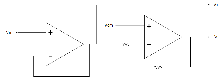

By the way, has anybody has done the output stage with balanced outputs? If the schematic is there, I'd like to try one in the future since my amp has balanced input.

For balanced outputs, the best and most correct way is use the normal single-ended outputs as shown on our output stage schematic, then balance that signal using two dual-opamps, one per channel. Or you could use a transformer instead, one per channel. Thing about transformers is they will add some distortion.
Typical opamp balancing circuit schematic attached below. You would use one dual opamp for each channel. As always, the opamps should have decoupling caps at their power pins. If you want to use this method, just leave some extra room on your output stage perfboard to add the two extra opamps. The exact resistor values for the inverting opamp are not critical just so long as they are the same. Around 5k ohms might be reasonable. (Vcm on the schematic in this case would be ground.)
