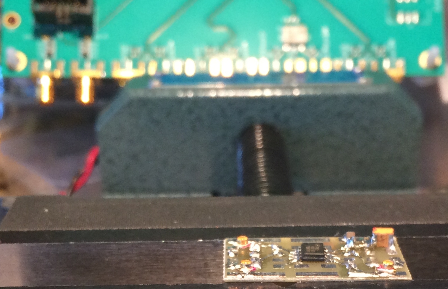

Today working on design layout for a DS90LV018A one-channel differential line receiver to single-ended LVCMOS output to drive the clock input on one of the AK4137 boards. The receiver will be mounted on a small Surfboard attached to the underside of the AK board, and it will get power from the 3.3v LDO on top that previously provided power to the 22.5MHz (or 25MHz recently tested) clock that has been removed. u.fl connectors will be attached to the receiver Surfboard for inputs and output. u.fl to SMA adapter cables will bring differential clock output signals from the clock divider board to the receiver. Clock input to divider board will come from a copy of the dac chip MCLK signal routed out through a GPIO pin. Lots of work to test an idea that may or may not work, but what else can one do? Too many things unspecified in AK and Q2M data sheets to know exactly what they need to work in a ultra-low jitter compatible configuration. Pictures will be posted later as construction progresses enough to show something.
A little ongoing progress preparing for some testing in the near future. A pic is attached below showing the LVDS to LVCMOS adapter board. In the background, and unfortunately rather out of focus, is the clock divider chip evaluation board. The adapter board has .002uf, .1uf ceramics, and 10uf tantalum polymer decoupling caps in the back right corner. Need to see if I can get a .01uf ceramic in there somehow too. On the left are two u.fl connectors and some SMD 50 ohm SMD resistors for the LVDS differential inputs. Two 50 ohm resistors are in series to terminate the LVDS signals with 100 ohms. On the right is the single LVCMOS compatible output and its u.fl. connector.
Just have to keep doing a bit each day so this keeps moving along. Sure would be nice if it works, but we'll just have to see if I get lucky or not.
