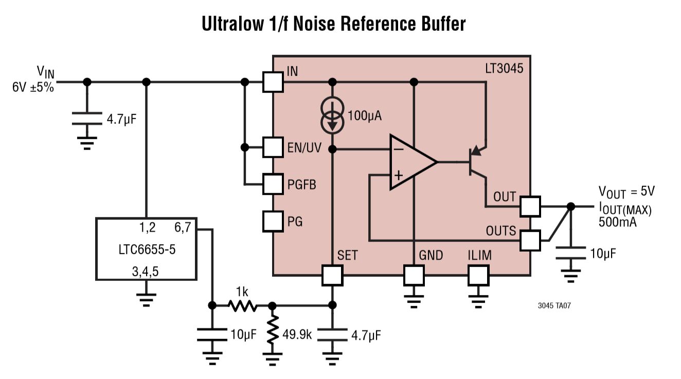

Has anyone done listening tests between an LT3042/45 and an LT1763/1963 powering the clock? Which is decidedly superior?
Probably using LT304x as a buffer for the LTC6655 3.3v reference on the AVCC board would be best for clock and VCCA. One shared regulator might enough, don't know. The schematic for that is shown below.
It might be good for AVCC too, maybe for an ES9038PRO board. The voltage divider would have to change, have to check the data sheet.
