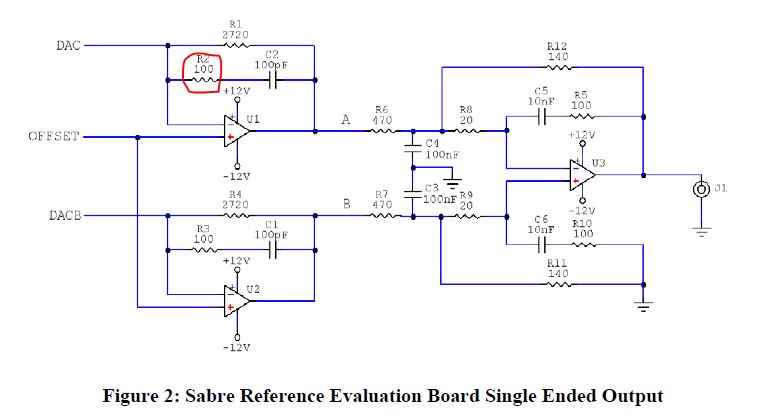

You could put the AVCC divider to make Vref on the output stage board, but I haven't seen any evidence of problems from putting it on the AVCC board. The distance the wires run is not very far, it does not risk contaminating AVCC itself that way, and I put the dac in a shielded steel case for normal operation (which would definitely be recommended for multiple reasons). One could leave the Vref divider on the AVCC board, and just add another RC filter at the output stage board, which I think would make more sense if you want to try something like that. Still don't think it should be necessary though.
Putting a small resistor in series with the 330pf I/V feedback cap would not necessarily improve RF filtering, and I don't see such a resistor in the ESS schematics I use. What a resistor like that would be for would be to change the frequency and phase response of the feedback network at very high frequencies to keep the opamp stable and free of oscillations and ringing. What is needed there would depend on the opamp, the behavior of the feedback network components at very high frequencies, and whatever else is connected to the opamp input terminals, which in this case would be the high frequency impedance of the dac outputs and wiring that goes to them. When I check the opamp operation with a scope, I am not seeing any evidence that we have a problem of that nature to ameliorate. We could try to model the circuit with spice as best as we can and see what that shows, but we don't have a spice model of the dac. In addition, in case there is some non-critical gain peaking in the I/V at very high frequencies, we have an RC filter to ground that should take care of any left over RF leakage from the dac outputs. We do it again after the differential summing stage and so at this point I feel pretty confident the output stage is doing what it needs to do.

Hi Freezebox,
Opamps are not running hot on my new output stage board, in fact they aren't even warm.
EDIT: I do however have the ground return for the external 5v supply down at the digital end of the dac board. That helps keep HF/RF ground currents away from the analog audio end of the board. Also, that is the only ground connection of the 5v supply to dac board, there is no other ground connection between external power supplies, so no 5v ground loops.
Also, the schematic you show was from long ago and for an earlier Sabre dac. It came from an old application note, not a data sheet. The latest evaluation boards use zero ohms in that position.
In addition, the dac output stage schematic that I used as a model for the new output stage did not have a resistor there.
However, you can put 100 ohms there if you want. It would start affecting the frequency response up around 5MHz or so. It might actually reduce RF filtering above that, but like I said, there is an RC filter to ground right after that opamp which should help fix any worsening you might cause.
If we really wanted to investigate this more, we could inject an big enough RF current (to see something at the opamp output with a scope) into the opamp summing junction and sweep the frequency to see what happens. Probably not worth the effort, especially since we have provided sockets so people could swap output stage opamps if they want to try that (not recommended though). In that case, all fine adjustment of RF frequency and phase would be out the window anyway.

Hi Markw4
just ordered a 2nd es9038q2m board (green version) to modify as I am a little afraid of changing something on my current modded board and killing it with no back-up. I also see an option using this 2nd DAC board as DAC when doing digital XO filtering for my 2 way speakers in future (currently its analog active filtered).
Further I would like to have a comparison board to my current board to see if I can further improve SQ by different mods.
I want to do the smd output stage again, using modified onboard circuit as symmetry stage again.
I will use crystek clock this time (instead of NDK Sda), LTC6655 as ref for AVCC and 22uF MKP film caps for AVCC.
Clock, VCCA and DAC power will be filtered with LP5907 LDO, while I feed 5V to the orig. 3,3V powerlines (MCU line keeps orig. 3.3V reg). The 3,3V LDO will be placed where ferrite filters are applied at the moment.
So what I would like to know about your new smd version is, if you will do same circuit as for through hole or any other mods like rasmussen filter or other values for resistors or mlcc? Will you use AD797 this time? Do you have a part list already?

As I progress a couple things, I wanted to have a simpler DAC for video, so I came across this and gave it a try.
NEW HiFi PCM1794 DAC Decoder Module 192k 24bit | eBay
I don't need DSD for video etc. So with the SRC4392 being able to output IIS, I thought I would use it for that and see.
The other thing is that I wanted to make sure that any steps forward on my 9028pro DAC would be a positive because as we've seen, though on paper some thing might be better or so we think, it sometimes is not.
Initially that inexpensive DAC sounded not so good. But I performed some very simple additions by decoupling each PS pin on the op amp with 0.1 and added some bulk caps on the rails. This was done by grinding off some masking on the ground plane and soldering. That was ll the mods performed.
Without the decoupling the sound was very undynamic and thick. No imaging and no depth. This was running with the 5532/34 op amps. Changing to the LME49720/10 op amps immediately made a very noticeable change. Yes, it now sounded brighter as was commented before. It sounded more articulate but it lacked the lower midrange body and there did not appear to have as much energy in the midbass. However it did sound clearer.
Then I changed the differential amp to a AD797. That changed a lot of things, the bottom gained some weight and the sound did indeed smooth out a bit. It did not sound as bright.
Having some dual dip adapters, I hurredly soldered them up and put in an all AD797 system. Then it started to come together. The brightness was now gone, I could listen to this now....and I am not running hot metal domes or ribbons but an older soft dome.
Then as is shown in the pics, it is now running a Jung Sulzer type PS replacing the 317/337 PS I was previously using. This indeed made a large difference. Possibly because the "AVCC" of the 1794 DAC is powered by the same power rails for the op amp. The better regulation possibly helps the LT1761-5 that powers the DAC analog lines.
As it is now, it no more mods except for a possibly better Super Reg for the analog. No need for more as it is destined for video.
So using this, I was able to parallel the same sound characteristics I had found on my 9028pro dac, tells me it is most likely the op amp sound characteristic itself. I have not tested the OPA1612/11 combo as yet. What I do have is a couple OPA1611 op amps on a board running a class A transistor stage output. I might try that this weekend time permitting.
At some point, you get to a stage where if you are happy with it, you need to call it a stop.
Here's my thinking, about the op amps. You can get into a conundrum. Is the OPA1611/12 more accurate? we don't know. So we measure it but what does that tell us? Are we measuring the right parameter? I'm not sure. If mark thinks he prefers the LME49720 in HIS system, then it is more accurate to him IN THAT SCENARIO. It could change with another set of headphones.
BTW Mark, the SRC4392 HF distortion is a lot reduced with the PCM1794. It is running at 192KHz. Maybe the ESS DAC clash for some reason with it. But in this scenario, it is more listenable.
However on second thought, I never hooked up the SRC4392 via IIS to the 9028Pro.
So many combos to play with.
