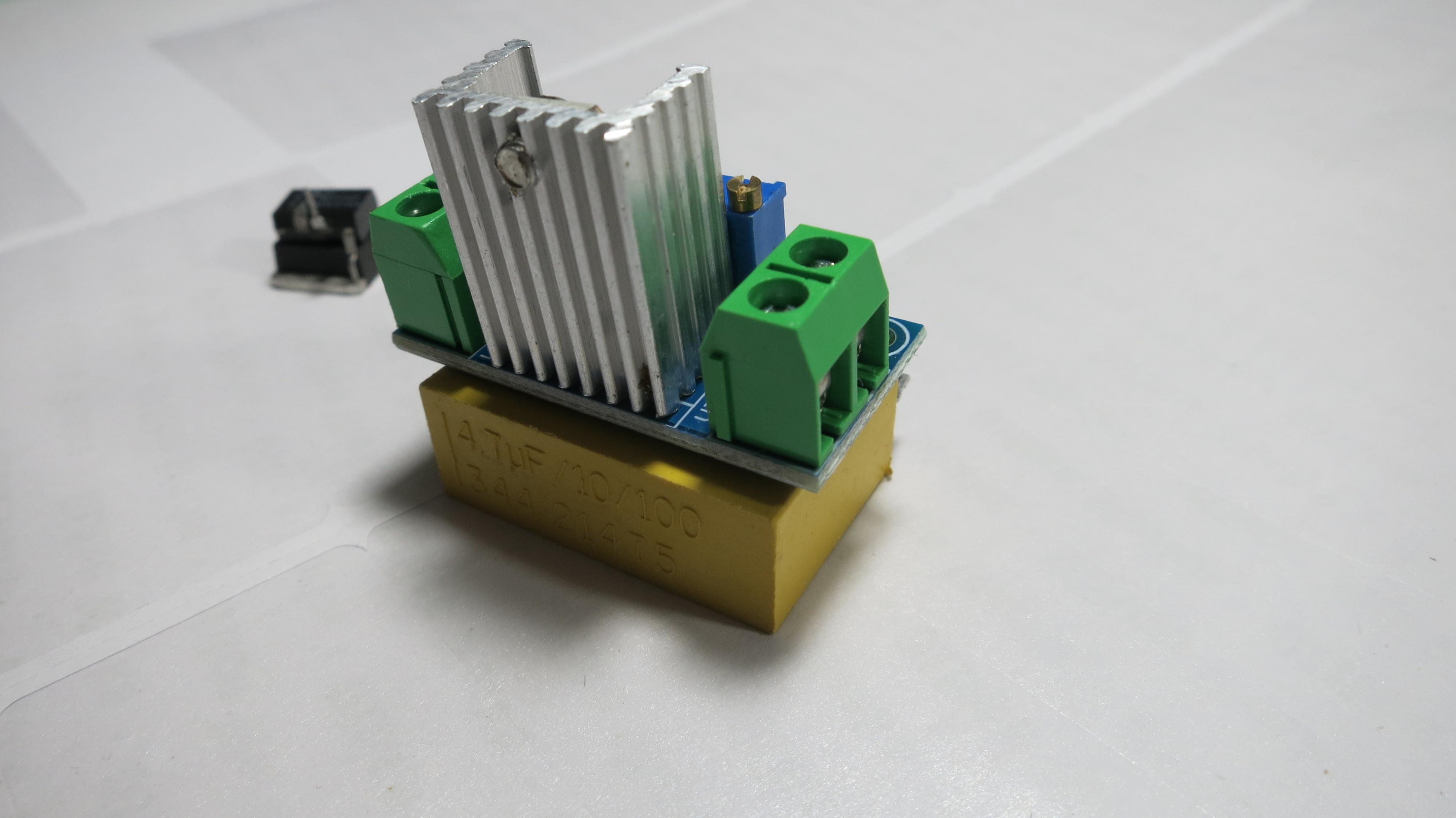

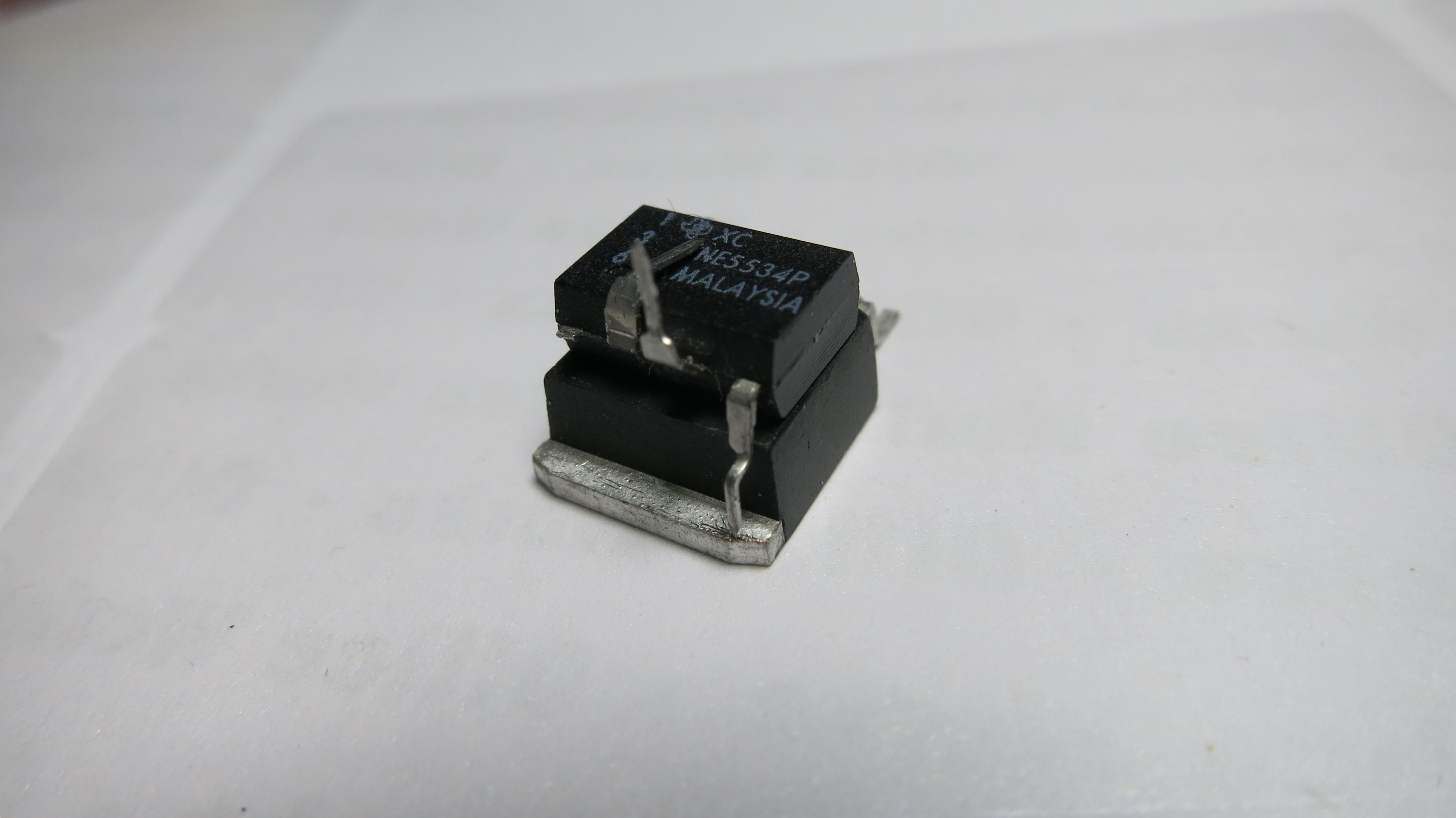

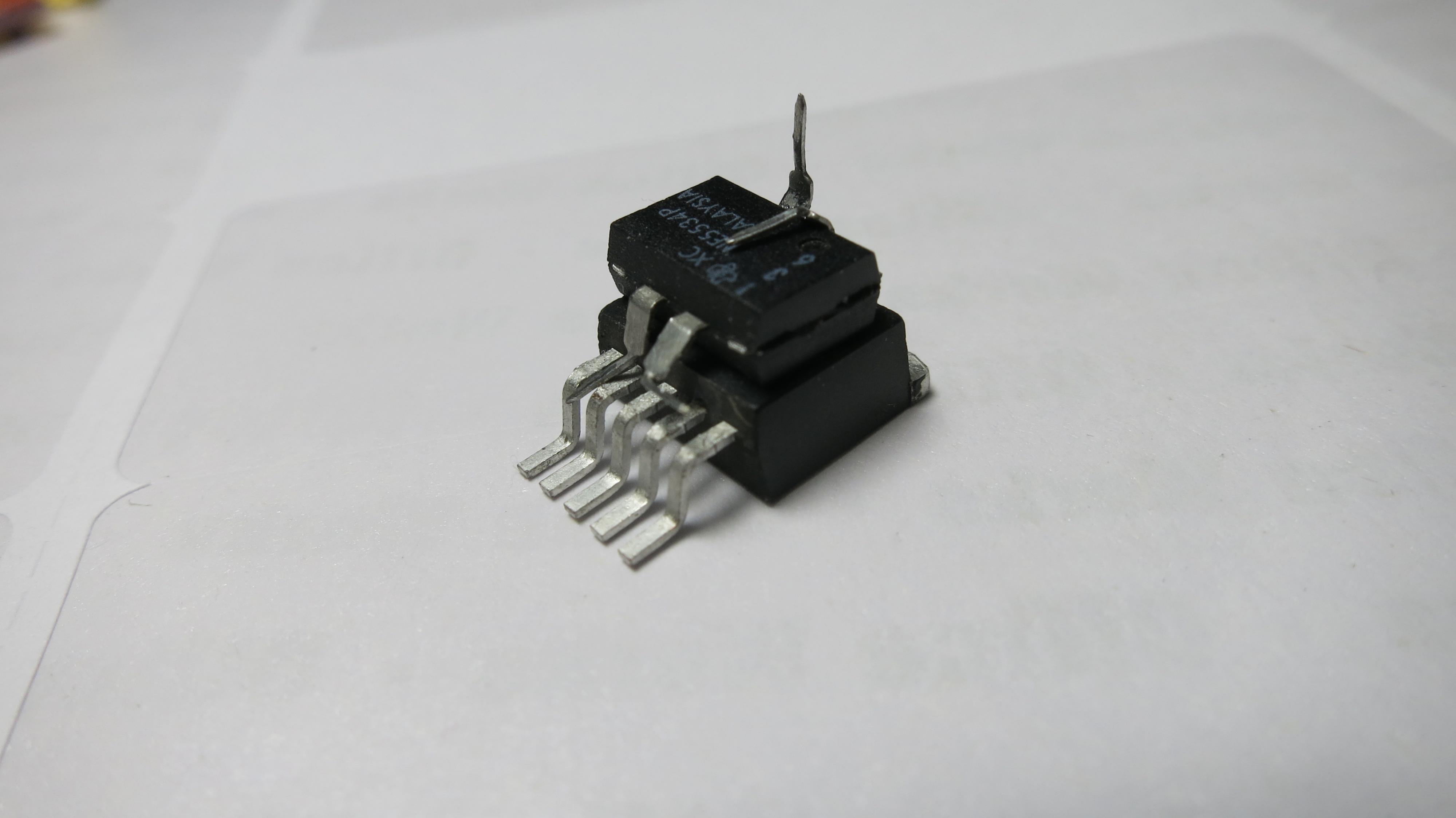

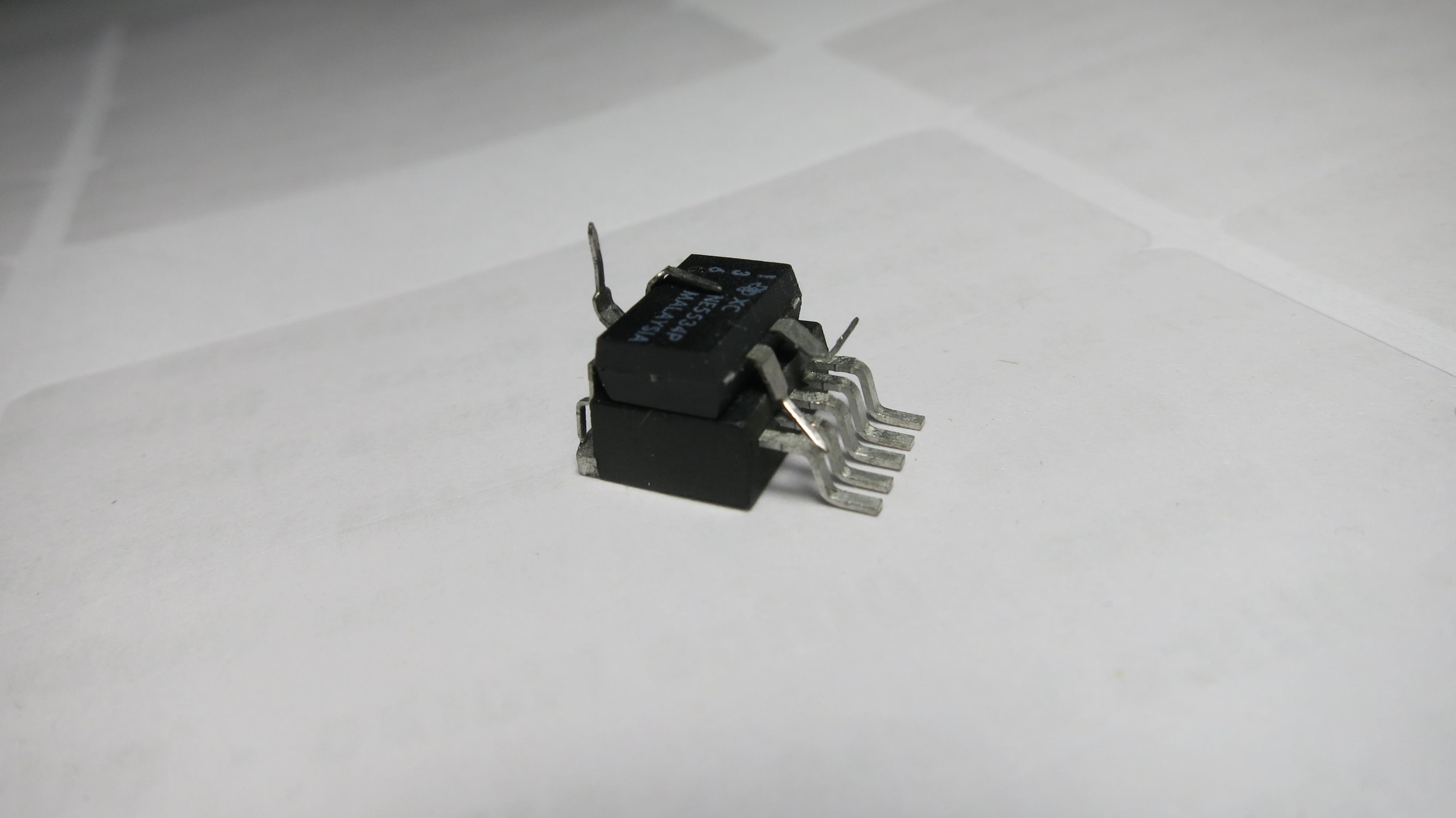

Started mocking up physical assembly of a hugh current op amp AVCC using a DIP and LME49600 as well as an LTC6655 module
Practicing bending pins and removing pins on an old disposable NE5534 that sits on top of the LME49600. Two or three leads need to be removed from the LME49600.
The assembly on top of the film cap is a regulated power supply using a 317. This cost a couple bucks and is smaller than I could make myself. The LTC6655 module is on the side of the film cap, I have a 10uF version of the cap but the 4.7 is used just for showing.

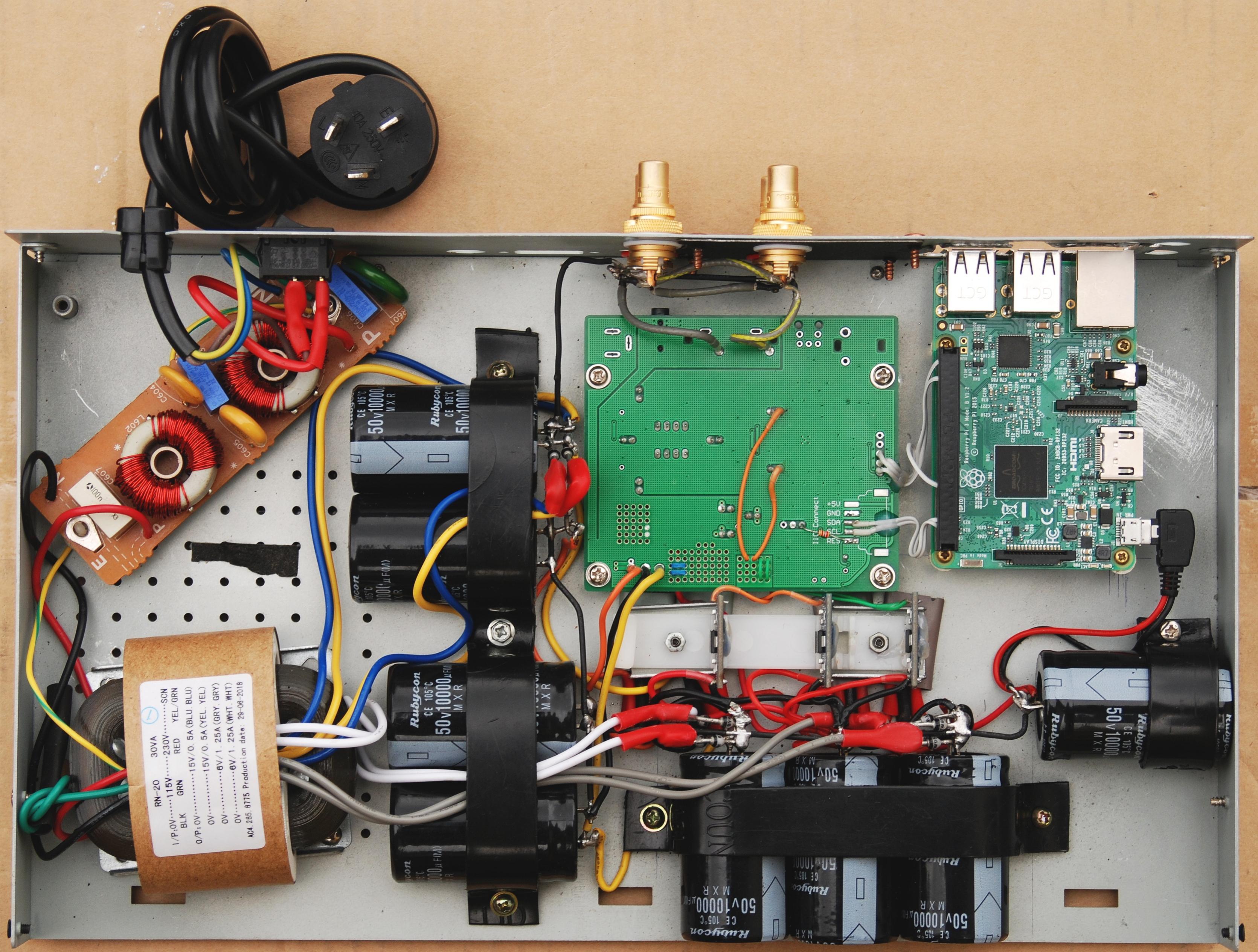

Can I seek help from the group?
I have ver 1.04 of the DAC board, with xmos u8 usb to I2S connected to it. However, been using spdif input as I find it SQ better than usb - jumper J3 is shorted per instruction. I ported the DAC board to another enclusure, WITHOUT the xmos us decoder. Now there is no sound coming from it.
Is my understanding correct that the DAC board using spdif input will work even without the usb decoder board? Anyone tried it before? Any clues as to why no sound is coming from it?
Thanks and I appreciate any input.
