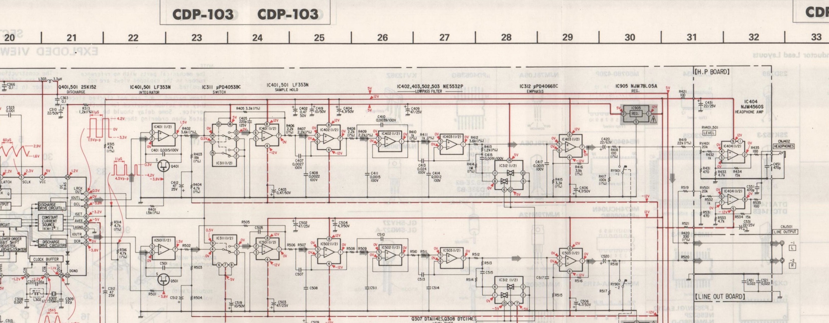

I want to use the board in an old CDP-103:
With the help of the forum, I got experience in profiding SPDIF-Out in old
2nd generation Sony chipsets:
How to get your beloved CD-player from the eighties into the Digital Domain
So I could use the original output stage:
Give it it´s own supply, disconnect it´s ground, bypass Emphasis and Mute etc. It "only" has to be adapted to the ES9038Q2M output...
All the best and thanks,
Salar
Salar

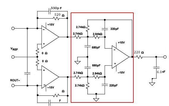

EDIT: I will post the output stage schematic. It is for one channel only and doesn't show decoupling. Vref comes from the AVCC board. Opamps are LME49720.

Thanks! As output stages looked almost the same in the good old times with R2R Dacs,
I thought this idea would be a nice try.
Questions about your output stage:
Rout- is connected, VRef is 3.3V, where is the positive differential output?
The unnamed connection on the upper left side..?
I assume the red-squared area is your additional board, whreas the left side is
the modified circuitry of the original board? Which opamp did you use?

If you go to the page you already found before there is a pinout of the dac chip. It has two differential outputs per channel. https://www.diyaudio.com/forums/digital-line-level/314935-es9038q2m-board-240.html#post5526080
They are DACR and DACL for right and left. The inverted differential outputs are labeled the same, but with a B suffix.
Vref is approximately +1.65v =AVCC/2 and it should be derived from AVCC for each channel.
An AVCC schematic is listed in the post list I already gave you: https://www.diyaudio.com/forums/digital-line-level/314935-es9038q2m-board-271.html#post5546958
Another version is attached below.

So I assume that in your schematics in post #2948 Rout+(DACR) was not labeled and it is the connection on the upper left, correct?
The red squared area ist the additional board, correct?
As far as I understand, the output stage mod can be done without an additional board using SMD components (which I can handle) -correct?
Is the AVCC board also needed with a clean, low noise power source?

There are two dac outputs per channel and two inputs per channel for the output stage. So long as both channels are wired consistently, it isn't critical which one is the inverted and non-inverted outputs. The important thing is that both channels are in phase with each other. The output stage board ground plane needs to be part of the dac board ground plane.
The area circled in red is the part that is a multi-feedback filter architecture, that's all.
The AVCC board opamps run on the same +-15v power as the output stage opamps. The LTC6655 runs on clean 5v. There is no substitute for the AVCC board, it is critical and it is required. It is also critical that the output pins of the AVCC board be located right at the input pins of the dac chip, and that the its ground plane be part of the dac board ground plane.
