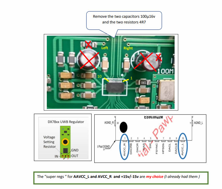

May I ask if anyone looked at the prototype instructions I posted a link to? If so, you may notice the picture quality is poor. That happens when trying to embed a hi-res image into a text type of format as .rtf is. Therefore, I have concerns about using pdf files of instructions. Maybe it would be better to have a list of instructions with the names of the picture files to refer to? That way you could use the hi-res pictures to better see how the build should be. What do you think?

I already provide the schematic. I provided a layout diagram for the output stage. I made a list of instructions, and where there are bigger spaces between some of the instructions, I have pictures to go in there to show what I mean by the instructions. Okay?
The problem is my pictures are hi-res, and some of Serge's pictures and schematics are very low-res. I can't put my pictures on the same paper as the instructions and schematic. Or, let's put it this way, I don't know if I could, but right now I can't. So, can you live with a schematic on one paper, instructions on another paper, and pictures on separate papers or look at them on the computer? I am not making these things with plans to sell thousands of kits. I need to make it good enough beginners can get by and feel they can do it, but I don't need better than that. So, given my constraints above, is what I am able to offer going to be good enough, or are there small changes I can make to help?

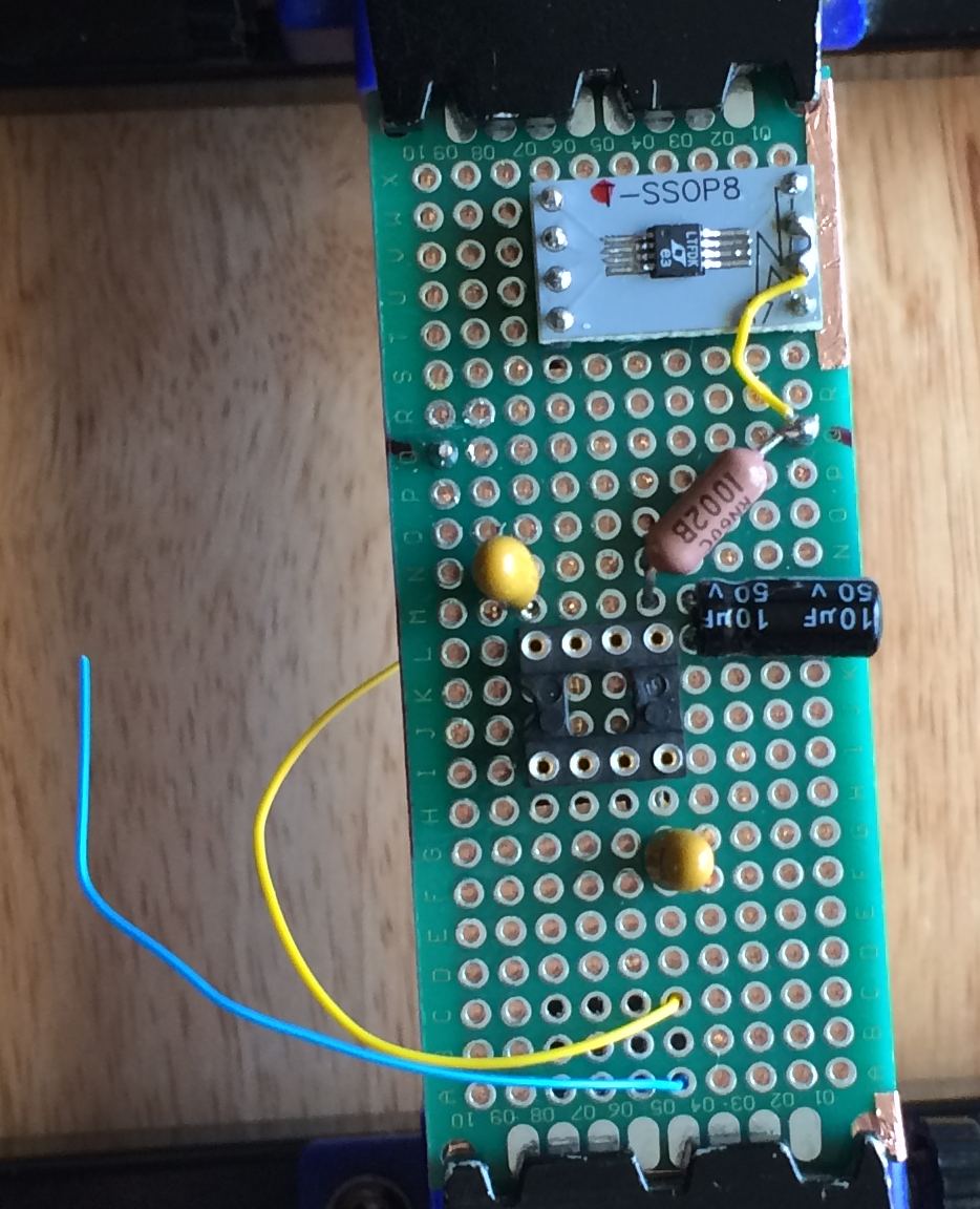

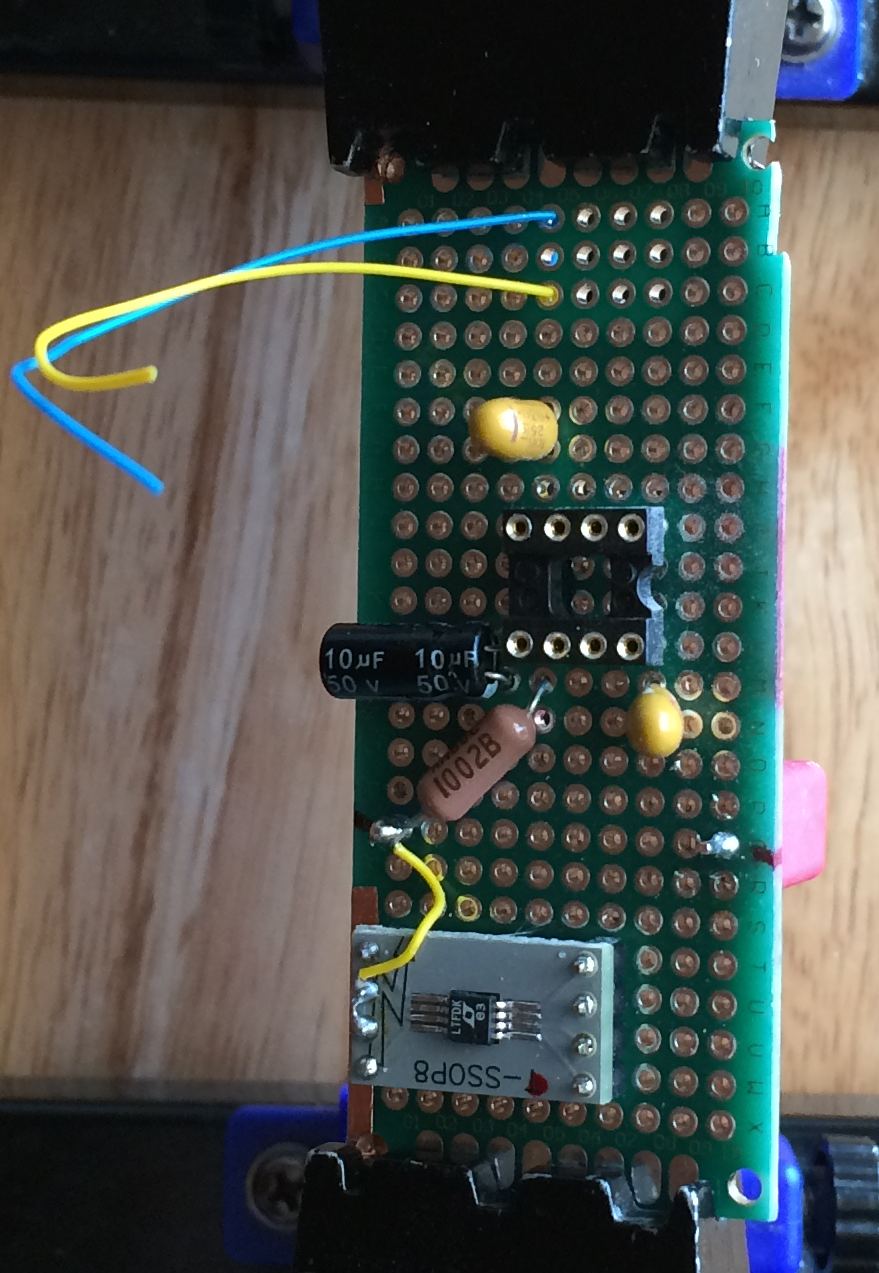

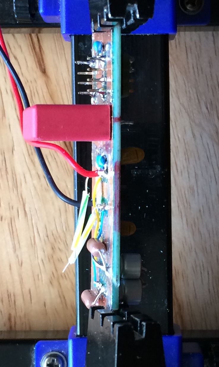

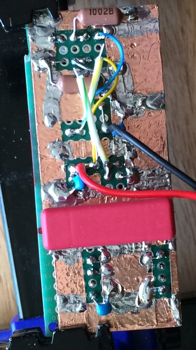

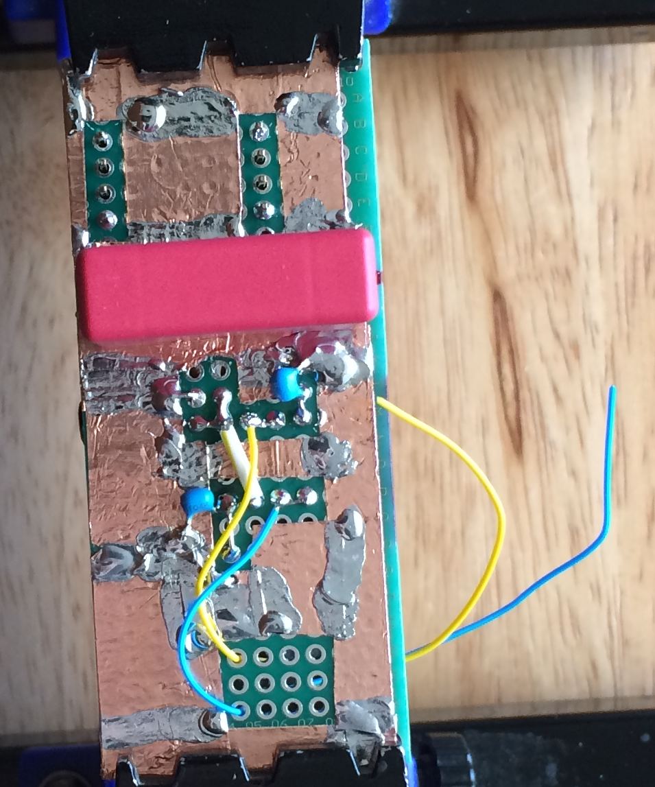

Hoping to get the AVCC board finished up over the weekend. My next task after that can be to work on assembly instructions and work with bih on the BOM.
For today, I have a few more pics showing continued progress on the AVCC board. I did find that I needed to notch out a little clearance in one corner of the AVCC board where it might contact the TOSLINK connector pins on the dac board. Also clipped off some excess length of TOSLINK connector pins.
The loose ends of the yellow and blue wires will go to the Vref dividers, right around those holes in the board where the wires are sticking out.

Suppose I make zip files containing instructions (including lo-res pics), BOM, schematic, hi-res pics, and layout diagram (if available) for the through hole component mods. The file size is going to much, much larger than what I can attach to a diyaudio post. (I can't even post one really hi-res pic.) Where would be a good place to host it so people can get it?
Hi Mark,
Dropbox works, or you could post the Hi-res to a photo hosting site like 'Flickr' or '500pix' or similar with free hosting then link here...and attach here the bom, layout, and schematic ...should fit fine..
cheers...bob

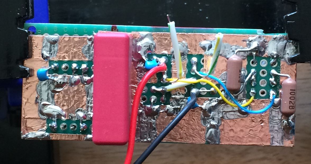

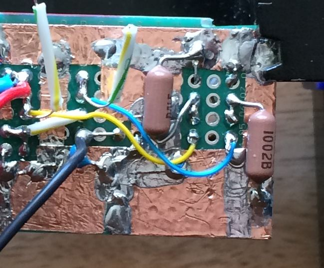

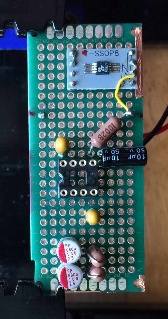

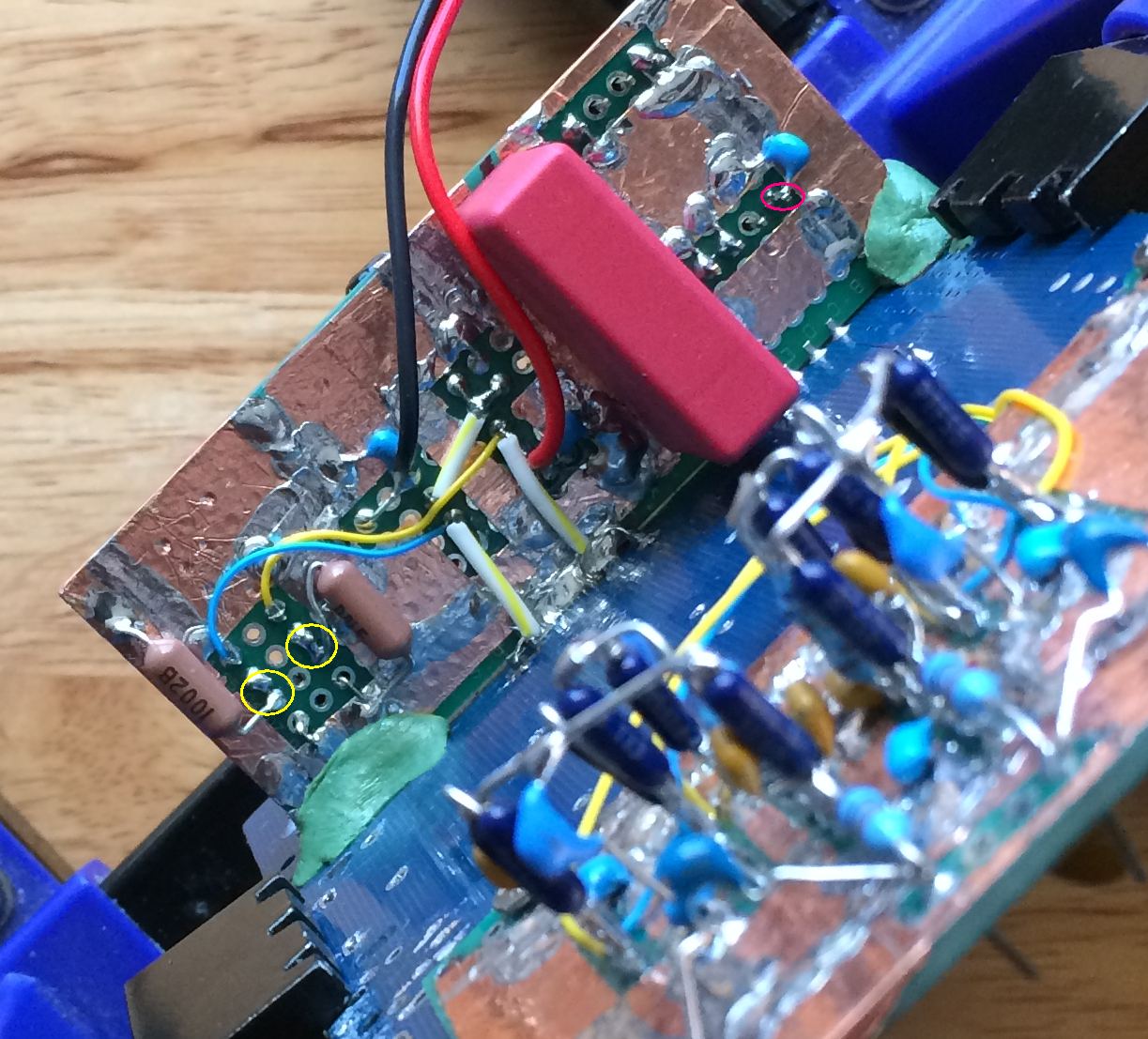

Again, more pictures of the AVCC board coming together. Some of it is getting harder to see especially around the opamp socket where there are more wires now. I soldered on some leads to go the 47uf AVCC caps on the dac board and slipped wt/gn/yel sleeving over them for now. Big red and black wires are for +-15v. Decided to go ahead and use the 10k MF resistors I have in stock even though they are kind of big. It was either that or SMD and I decided to stick with the program. Thus, Vref dividers/filters are soldered in place. The opamp input filter is soldered in place. Getting pretty close to the end of the AVCC board.
Pictures below.
For tomorrow: No pictures of it yet, but right now working on attaching the AVCC board to the dac board. That may be hardest part of this whole thing, but it was all I could think of to use through hole components and put the AVCC board close to where AVCC voltages are needed. More on that later.

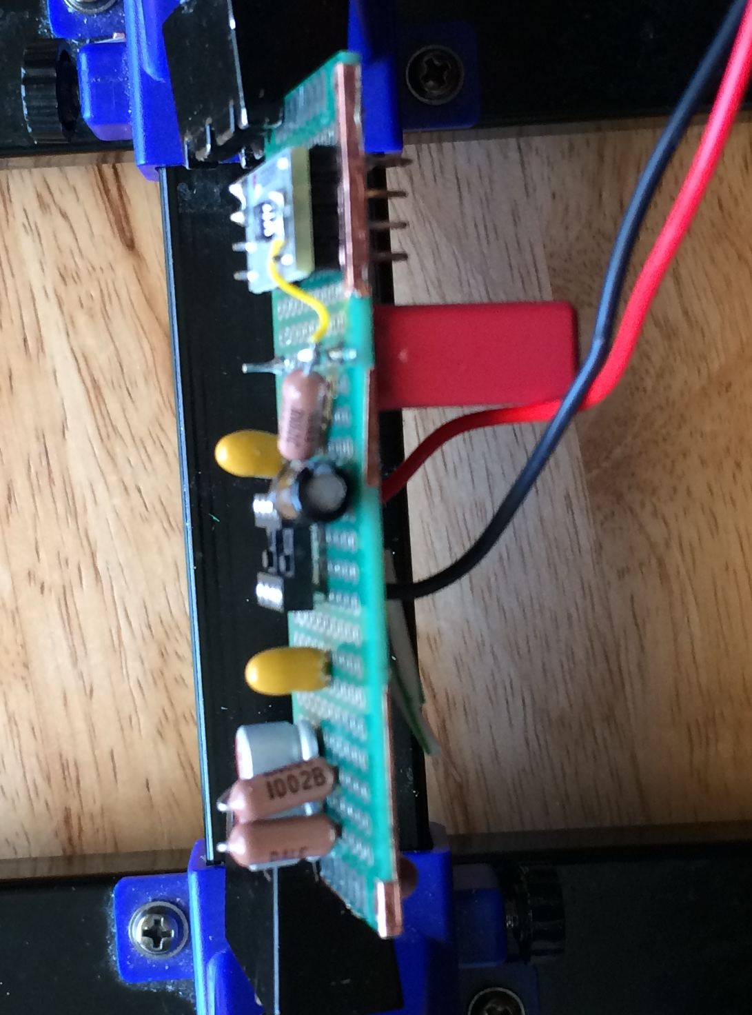

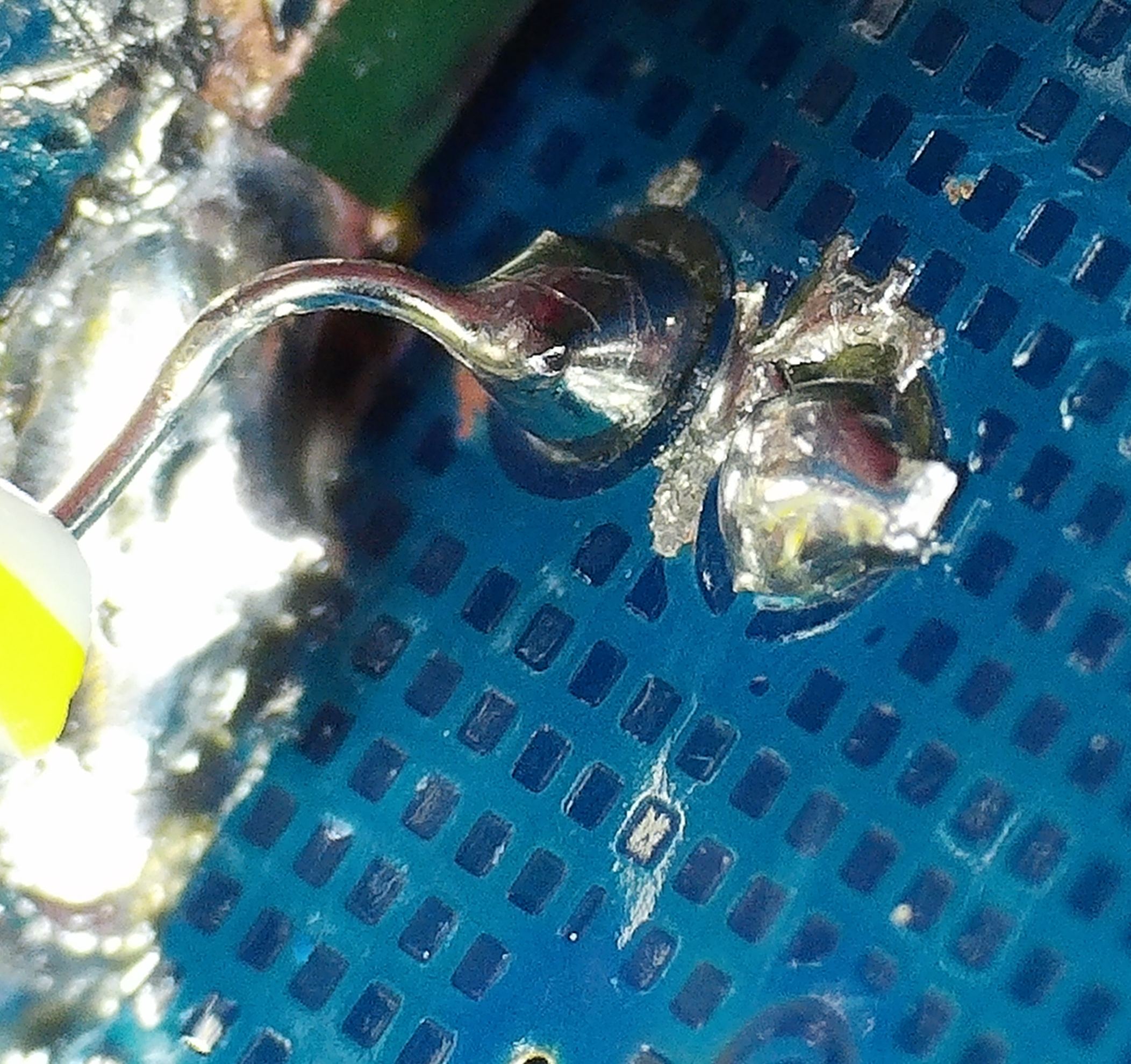

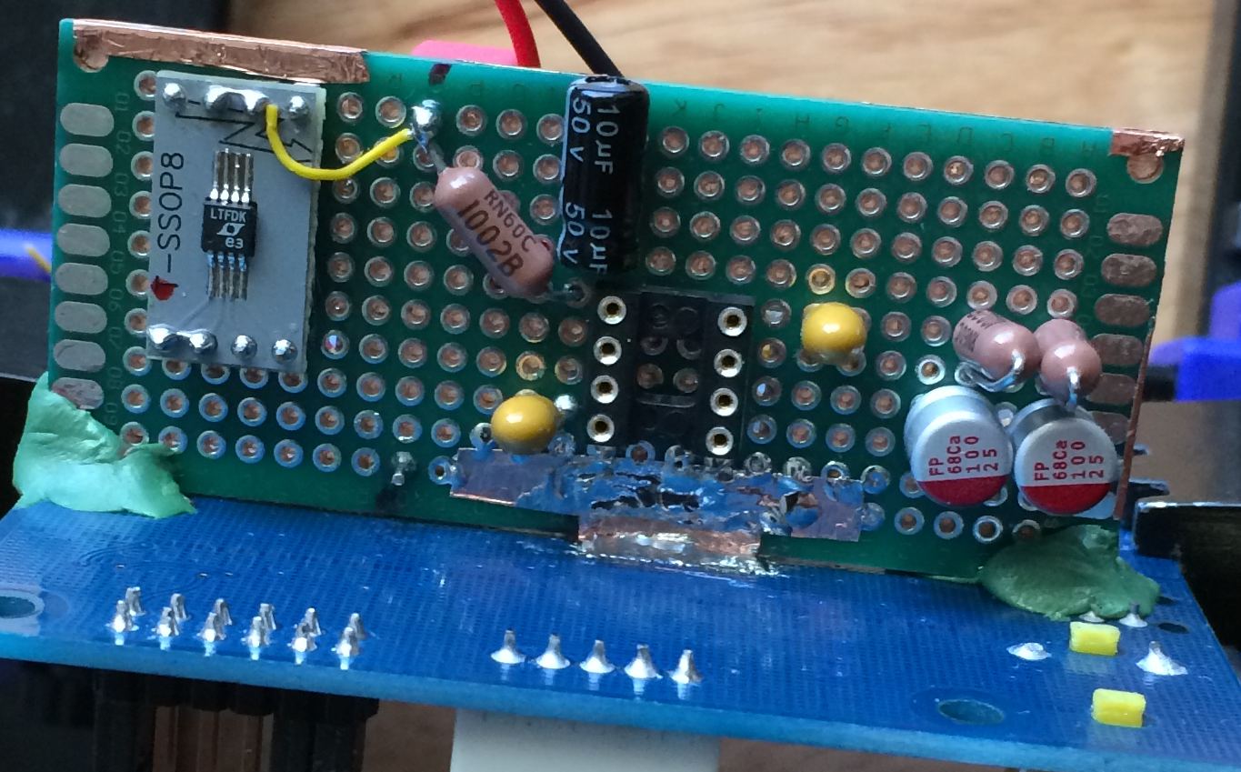

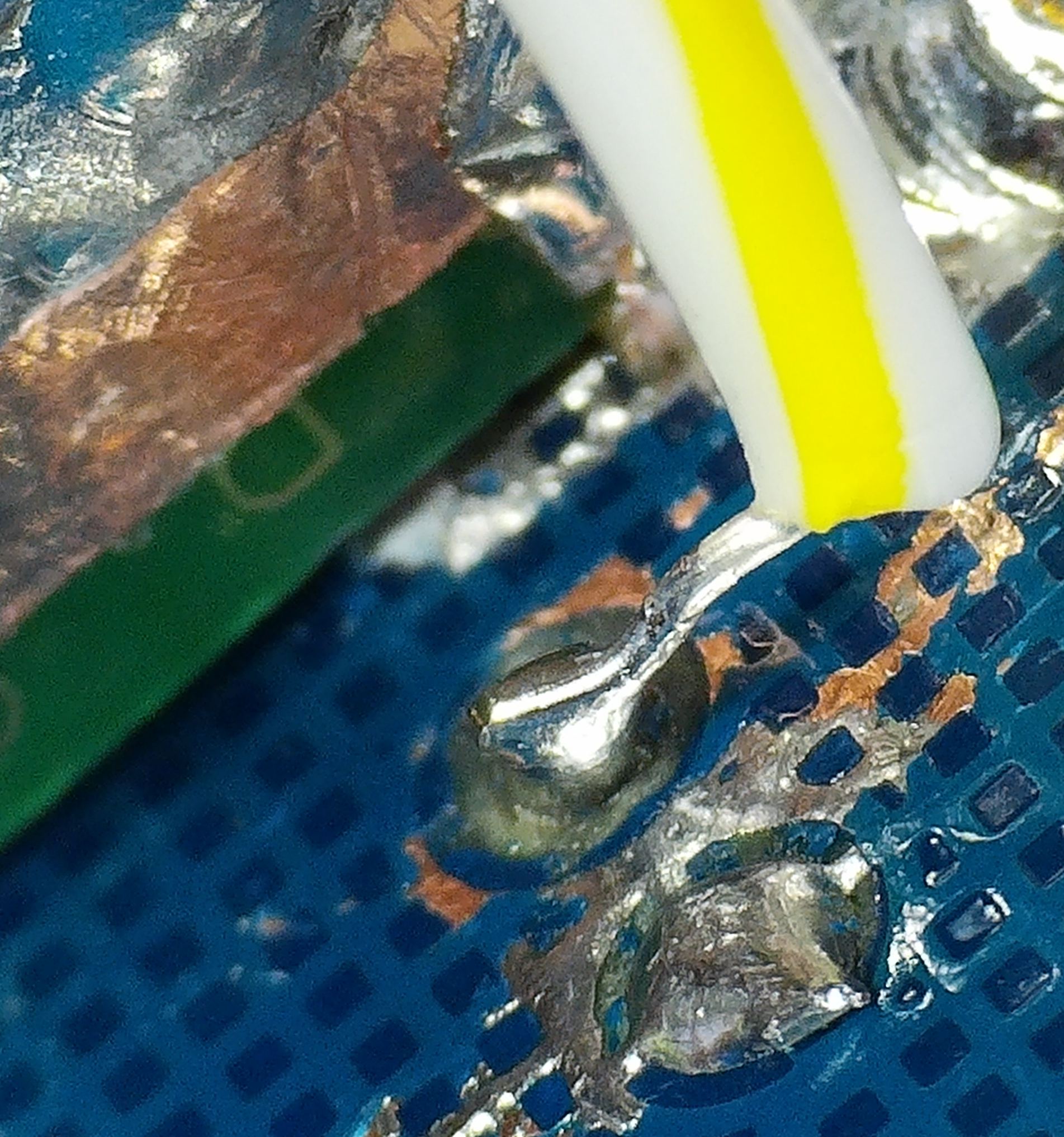

Whew! No kidding, that last bit of AVCC board work was a bit nerve-racking, but it's done.
Pictures below. Green blobs at the outside corners of the AVCC board are classic green epoxy putty. AVCC board ground plane is soldered to dac board on both sides of AVCC board. I used SMD 47uf caps on the dac board, took off the plastic spacer on the bottom, and stuck the short, flat leads through the holes in dac board. One can see that where the ground lead is soldered to the dac board it is flat. Would have been fine if it was round too.
In one of the AVCC board pics, Vref attachment points are outlined in yellow, and the where +5v will connect to LTC6655 is outlined in red.
Some closeups are included of where AVCC power wires are soldered to the 47uf cap pins on the bottom of the dac board. Probably would have been easier if I had used caps with longer leads which could have been sticking out more for easy access, but it worked out okay. The AVCC power wires were stripped of insulation, and a bit of sleeving slipped over them to help keep them from shorting to anything they shouldn't. Thought that might be easier that trying to strip short pieces of small wire which can bring its own problems.
I'm sure there are other ways to do this and many variations that would be similar. The big film cap was hard to figure out what to do with and I'm not sure if I were to do this again if I would arrange the components exactly the way I did. I don't know if there is a best way in this case. It was thinking about ending up with something like this that convinced me I would prefer doing SMD AVCC power for the first board, which of course is what I did.
I also still think the AVCC board could have been done pretty much just as well from the side as I had originally planned. Only building both ways, from the side, and here in the middle, and comparing results would convince me one way might be better than the other.
On the other hand, the output stage for this version seems fine from a location perspective. It would be an easy place to do SMD or through hole. No real compelling reason to do the first board output stage the way I did except to keep all the mods compact and on a single piece of PCB material.
There is some more work to do to finish wiring up power and finding some place to put RCA analog output connectors since I already removed the original ones.
Also, at some point this board needs a clock upgrade and I2C bus connectivity mods. One thing at a time.
