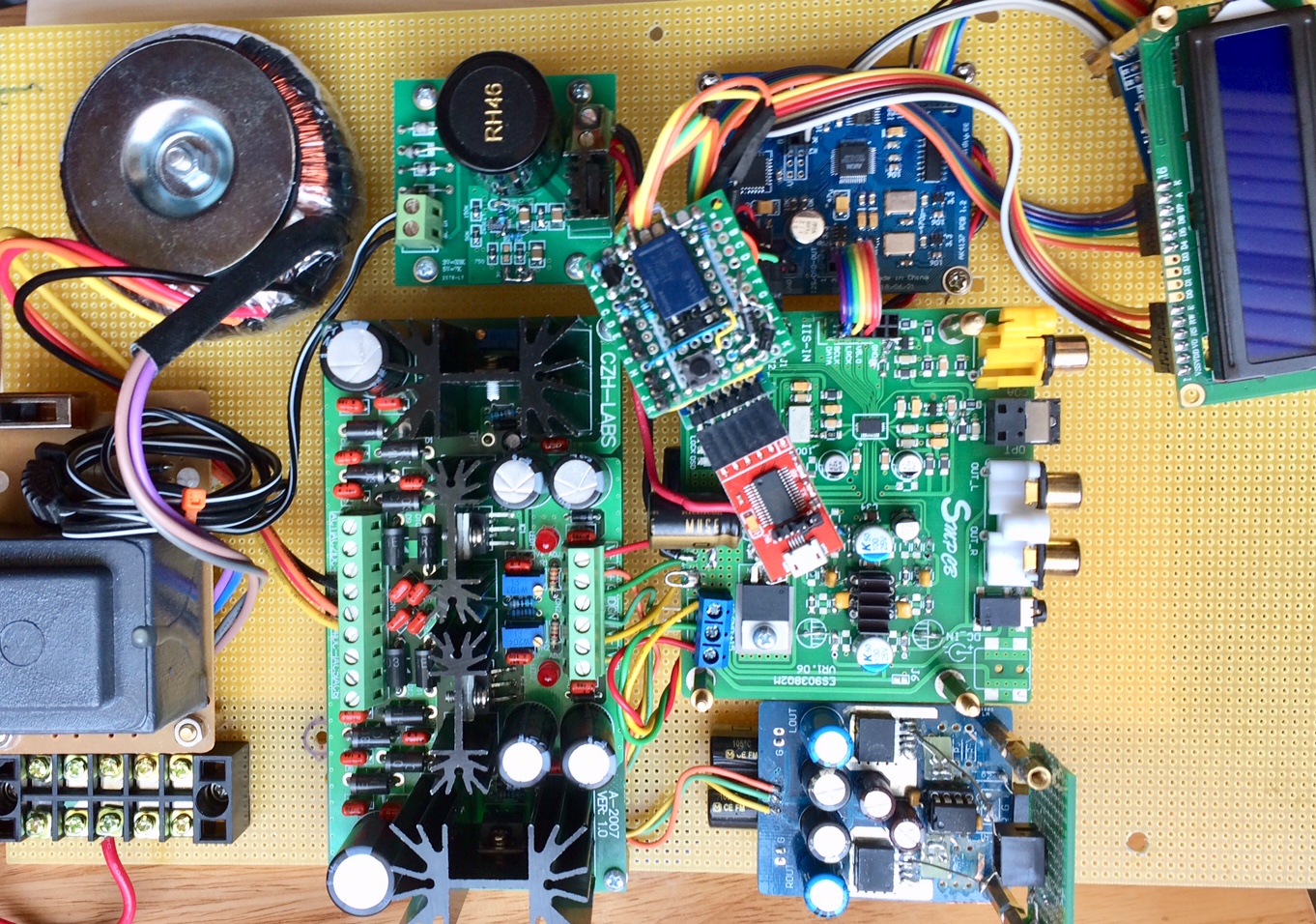

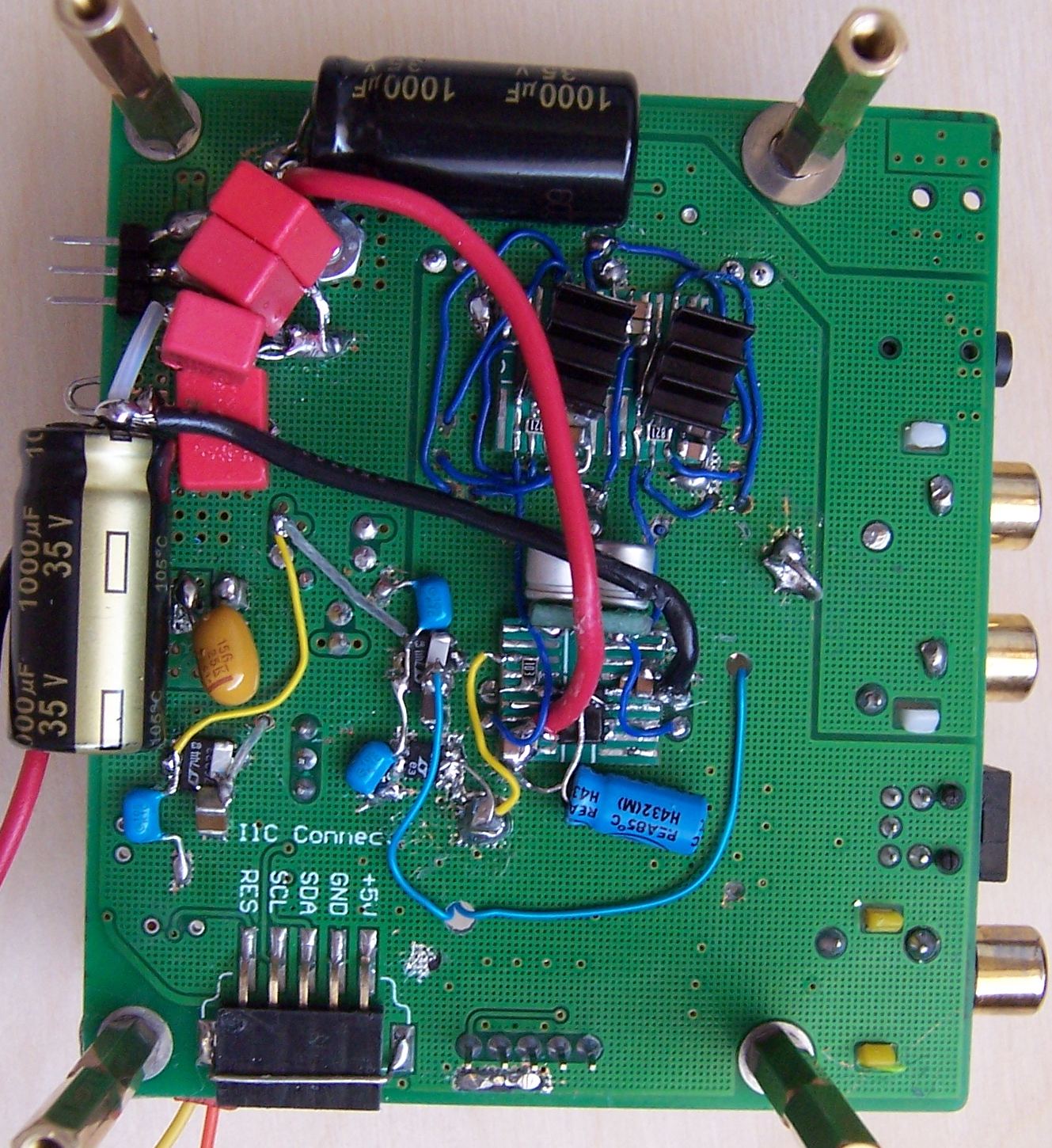

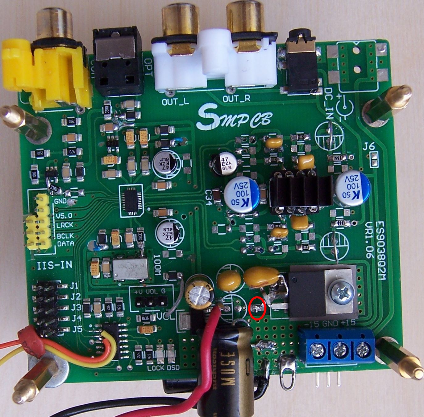

Decided to see if I could get a little more sound quality improvement for my modded Chinese DAC. I think it has helped get it a little closer to DAC-3. Probably will have a little more to say about that after I have a chance to listen to it for a few more days.
What I did was change the way power is routed to AVCC supply opamp. It was the last opamp from the incoming power connection, at the far end of the power distribution traces. While I was rerouting power to it, I also changed the AVCC 3.3v opamp input source voltage from a dedicated 3.3v regulator to a high performance 3.3v LTC6655 reference. That left me with an unused 3.3v regulator so I decided to use it for dedicated VCCA power.
Pictures available below showing current status of mods to the dac and the present test setup. Please note that the dac board is actually getting 5v power from a an external supply rather than the on-board 5v regulator. The output pin of the on-board regulator has been lifted. The lifted pin is indicated in one of the pictures with a red circle.

SPDIF still works, although the resistor has been moved and there is a jumper soldered across the pads where it was located before. Reason is the SPDIF input connects through one of the two ES9038Q2M GPIO pins. The GPIO pins among other things can be set to output the MCLK signal, the internal master clock derived from the 100MHz hardware clock on the dac board.
One reason to output MCLK would be to use it as the master clock for an external I2S device. That way the I2S bus could be run in master mode with the Q2M supplying all the clock signals and the external device only supplying the DATA signal.
I was thinking about letting Q2M clock an SRC4392 board with Q2M as master and SRC4392 as slave, just as an experiment in trying master mode. Never got around to doing everything I would need to make it work, but in principle it could be done.
Since an SRC4392 has a maximum master clock frequency of 30MHz, I would need to use the internal Q2M MCLK divider to reduce its external 100MHz Xi clock to an internal MCLK clock frequency of 25MHz. Then both Q2M and SRC4392 would be clocked at 25MHz which would be fast enough to try it out, although would it would not support some of the highest sample rates that way.
It also would have been possible to use the GPIO pin normally used for TOSLINK input to output MCLK instead of using the SPDIF pin, but there were nice pads there where the resistor was mounted which could be used for soldering on a MCLK terminal to send off to SRC4392.
