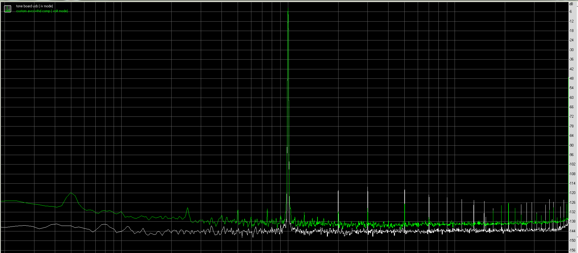

Hello,
I've received a tone board (usb xmos + es9038q2m+ with i/v stage all integrated ). I've done a small comparison with my custom board ( avcc mod , 0 15v supply and thd compensation, stock buffer).
As you can see, the noise level is very good , not too bad for a usb device . Thd is higher than expected given it uses the i/v stage, I wonder if the thd compensation is activated. Not shown here, but the tone board has better channel separation.

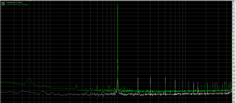

Hello,
@occip: Do you have a link where we can take a look at 'tone board?'
Also, don't know if you have separate left and right AVCC supplies? If so, and channel separation isn't that good, maybe worth trying adding a whole lot of power supply filter capacitance for the AVCC supply and for the voltage output opamp. I have seen channel separation issues before that turned out to be a hint that PSRR wasn't quite as good as I was expecting. I used some big electrolytics and a few 0.1uf and 1uf film caps to remedy the situation I had like that.

regarding my avcc supply i'm using one aop plus 1 1500uf on each channel (-86db channel separation)
How about your +-15v power? That's what I found needed more capacitance.
I've added 6800uf but the 50 hz peak is still visible, maybe a good buck converter will help to remove the peak (and move it at higher frequency 🙂 )

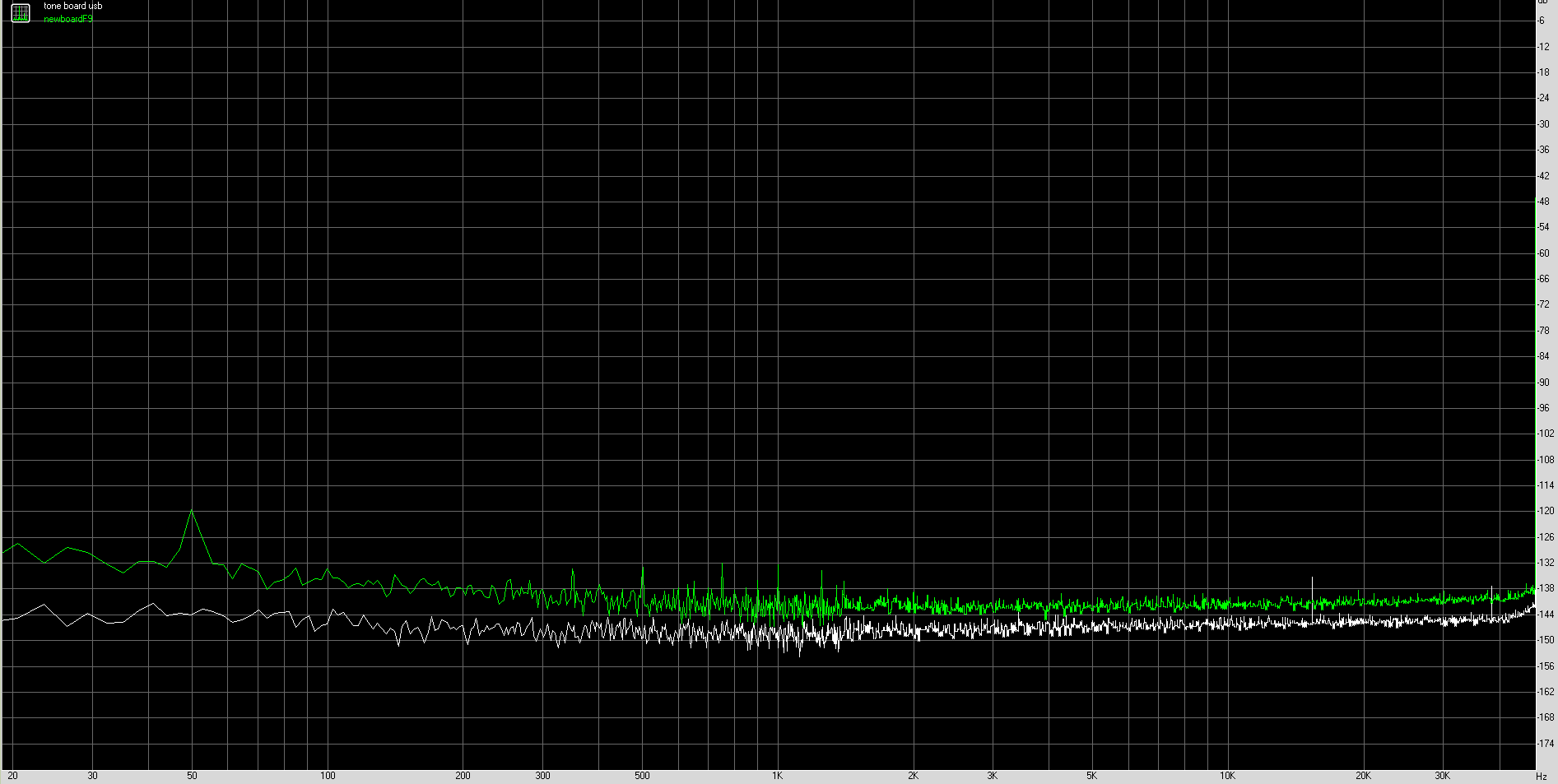

The noise is possibly a USB noise issue. I wonder if one can patch in a clean 5V into a USB cable and not use the 5V from say the laptop.

As bonus the noise plot of the tone board connected to my laptop versus my es9038q2m modded board. Not too bad ( but not completly realistic given the soundcard i use (asus xonar).
