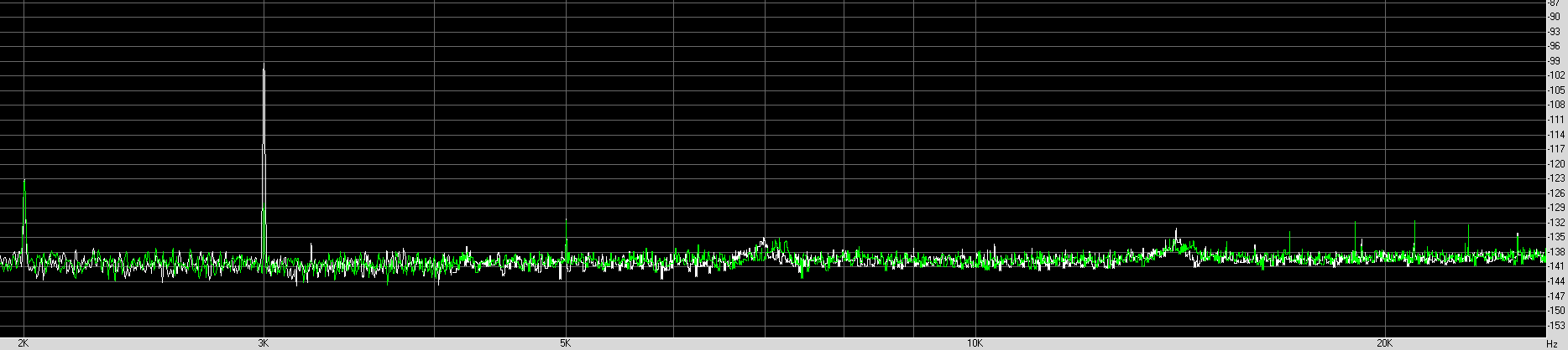

I've done the thd compensation on my other board( with dip switch), without i2c pin lifting ( like i2c multimaster mode) data pushed from my esp32 board to the es9038q2m ) , same results on the thd plot (-3dbfs) in green without compensation , in white with compensation ( f800 value in register).
As you can see, upper harmonics are little bit higher but still very low.
