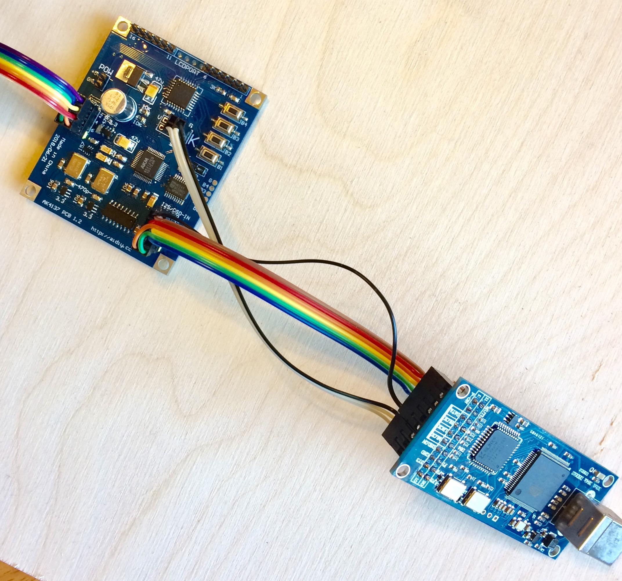

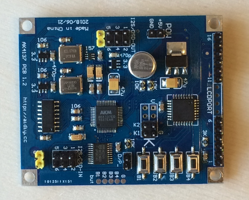

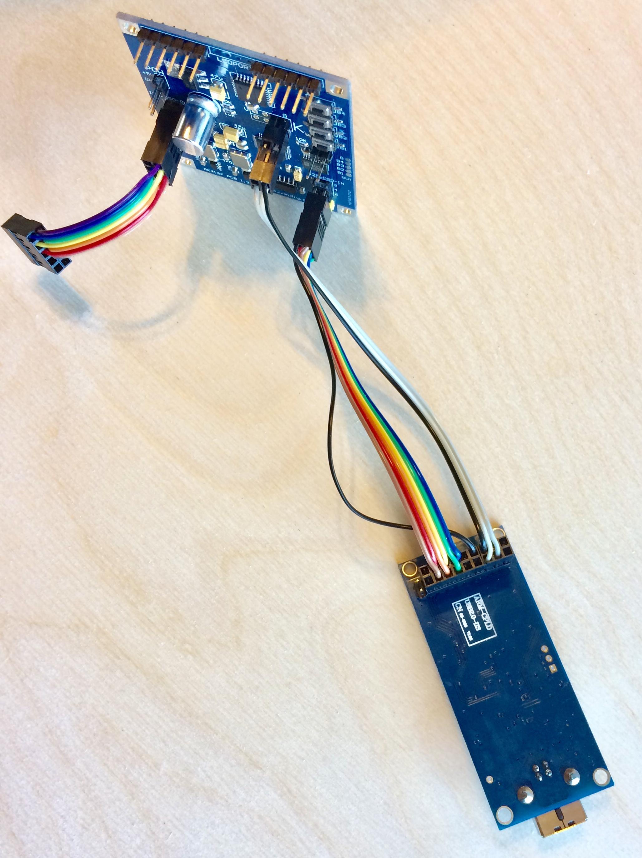

Spent most of the morning making up cables to try out the new, low-cost AK4137 upsampler. This one, as some may recall, only has I2S/PCM/DSD inputs. No SPDIF, TOSLINK, or AES.
Another thing about this board is they didn't lay out the connectors very sensibly for what it is supposed to interconnect with. The other, more expensive AK4137 is much better in that respect. Pics below (display not shown).
EDIT: Added pic showing extra ground pins I added for I2C/PCM/DSD interconnects. The added ground pins are yellow color.
