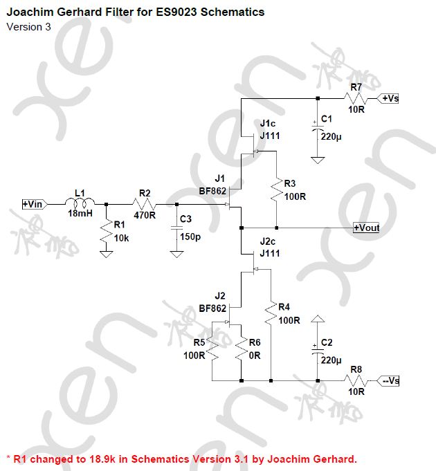

Plus I am getting JG Filter buffer, has anyone tried it with 9023 and directly into amp via pot or something similar, bypassing passive or active amp all together..?
I asked myself the same thing. I assume the 9023 can drive a 20k to 100k pot, so it would probably make sense to put the JG-buffer behind the pot. It will present a low impedance source to the poweramp then.
AFAIK the buffer has been calculated considering the low o/p impedance of the DAC (240ohm) and the influence of the lo pass filter created by the 4.7nF cap suggested in the application note. Are U sure that putting a pot in between you will keep the same conditions?

It wouldn't be that hard to do. Here's what I suggest. I've attached a schematic for the JG filter. In the schematic, you see R1 = 18.9K in the latest version. One could use a 20K volume control and put a 340K resistor in parallel with the pot, which gives ~18.9K resistance. Then hook up R2 to the wiper of the volume control and you have now integrated a volume control into the filter/buffer.I asked myself the same thing. I assume the 9023 can drive a 20k to 100k pot, so it would probably make sense to put the JG-buffer behind the pot. It will present a low impedance source to the poweramp then.

I´m not sure that is that easy. At the time I wrote about the pot before the buffer, I thought "buffer" = "high input impedance/low output impedance" without looking at the schematic. But here the LC input filter seems indeed to be tailored for a specific application.
Replacing R1 with a pot+parallel R, will change the shunt R/series R in the schematic a lot, depending on the pot position.
I think it actually does work. The suggestion I made loads the pot with the high impedance node of the buffer part of the circuit, so the filter works just fine. The pot becomes the load for the L-R filter and it's value doesn't change because the impedance of the buffer is high. Putting the volume pot on the other side of the inductor, i.e. between the DAC and filter/buffer board would not work.
