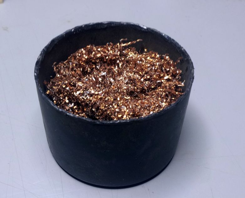

Just need to make sure the tip is clean and well tinned - I use a damp sponge and that course wire wool stuff.

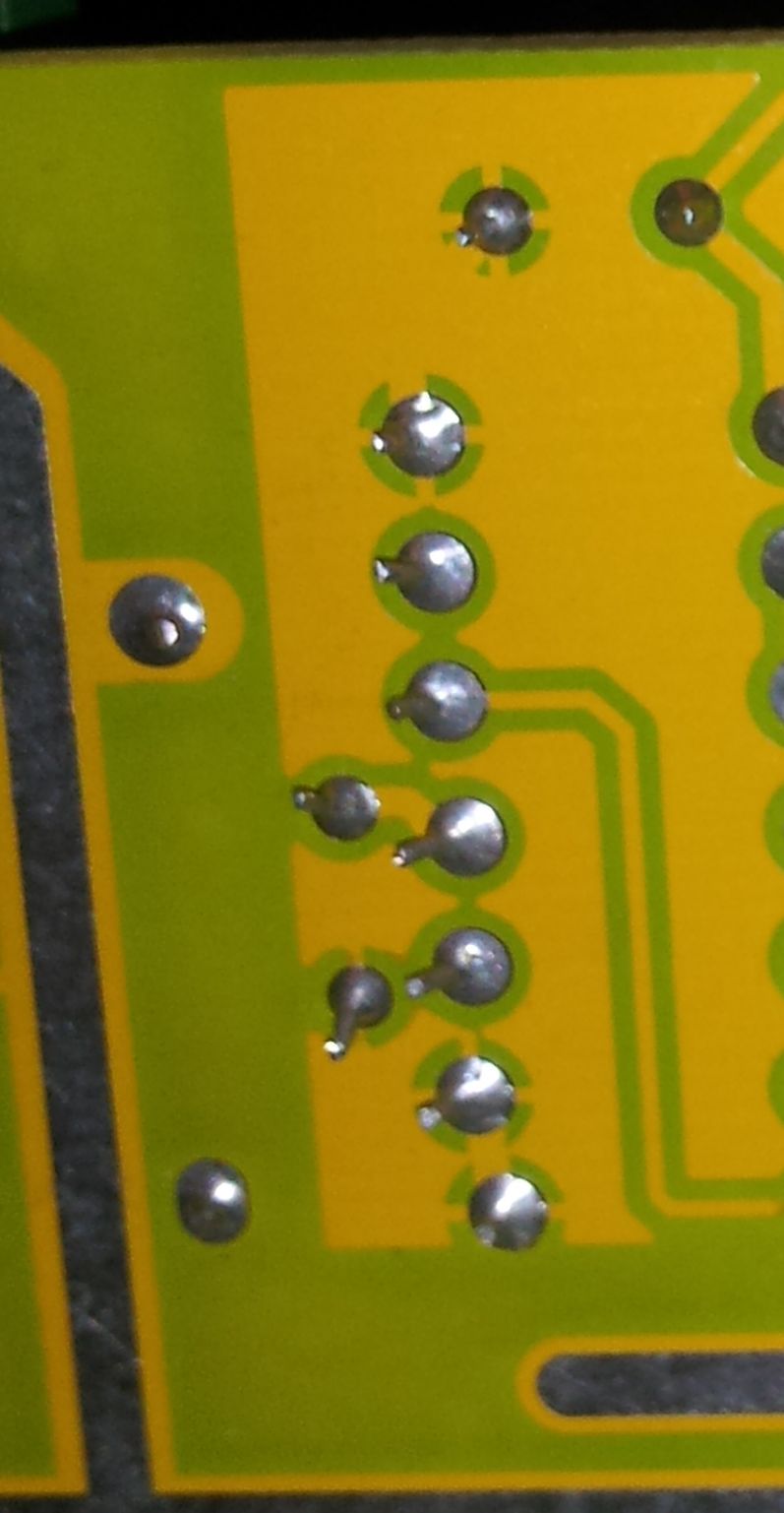

Off topic: been de soldering trimming pot , and somehow ring on pcb around wiper is not visible any more.
I have checked continuity between wiper and adjacent pole and it is there (as on the rest of pots) and not sure is pcb damaged or continuity is there for a reason 🙂
Any ideas ?

Hi Ivan, Bit of a problem there - Is the PCB double sided? And which pad has lifted - Solder side or component side? If it's the component side pad thats lifted, you should be OK assuming the through plating is good. If it's the solder side, you will need to scrape and tin the trace and piece out with a short bit of wire.
Hope that makes sense.
Ken

It is Uriah's Lighter note. It is the solder side. No pads were lifted its just the black ring surrounding wiper got missing.
I ll try to scrap , otherwise order replacement pcb. Only few components been soldered so damage is not that big... the learning curve !

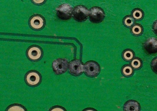

That's hard to see exactly what's happening there, but the darkness/dullness of the other solder points suggests you may not be using the best solder. Are you using liquid or paste flux in your work? Is there still copper under the grey on those open pads?

There is a thick copper pad in place , sort of copper bridge from wiper to the right pad.
I should listen to advise and buy good solder right away 🙁

You can use rubbing alcohol or fingernail polish remover with an old toothbrush to clean things up before your next attempt. The investment in a good liquid flux used in addition to the flux that may be in the solder is well worth the cost. It cleans up easily as suggested above.
Mine aren't perfect but the end result should be closer to shiny bright.
I like this shape for scraping pads when necessary.
Radio Shack has a 62/36/2 silver solder that is decent and doesn't cost much.
