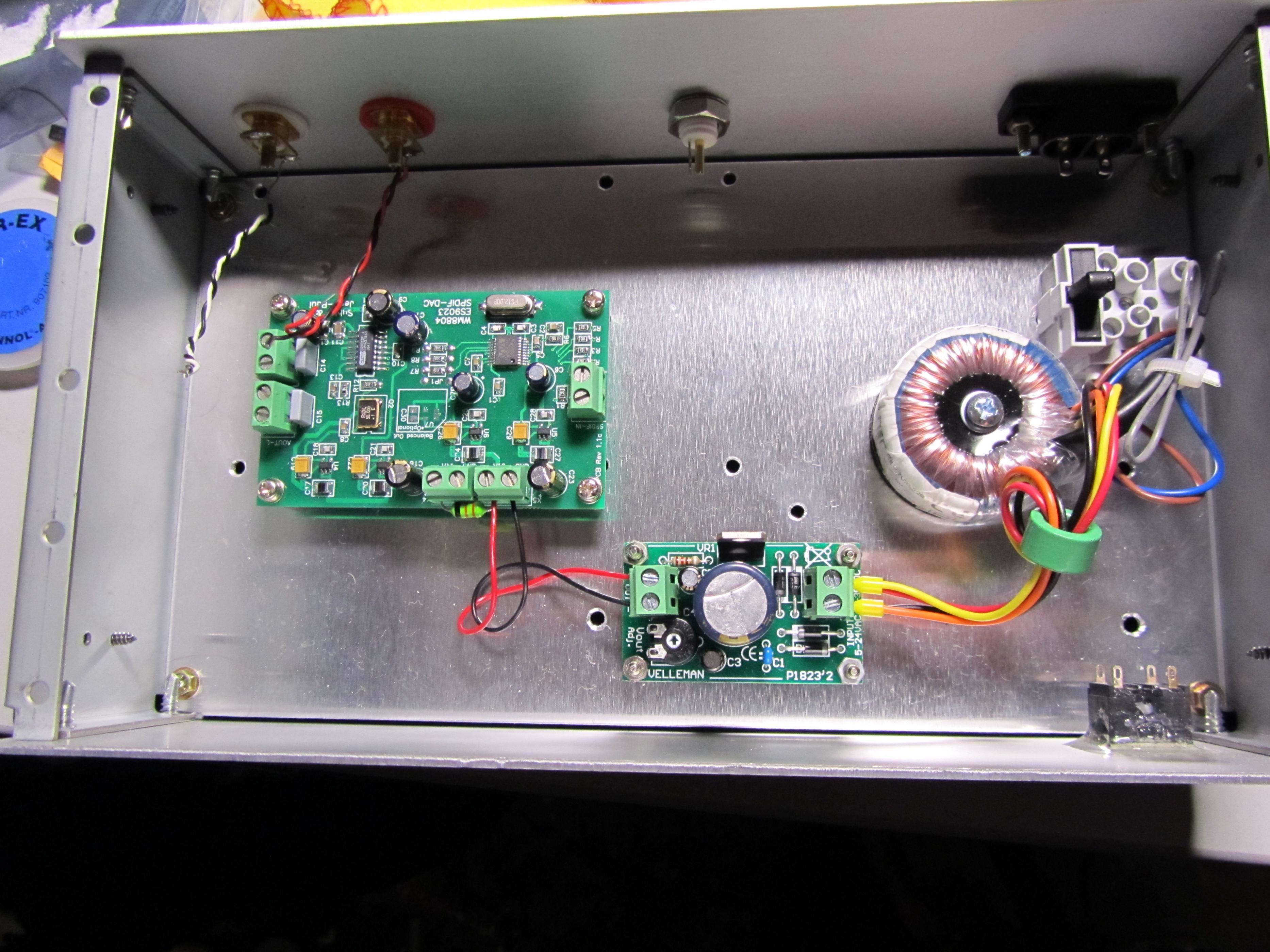

BTW I was busy encasing one of the prototypes and maybe it gives some impression how things can be done regarding the power supply. Take the picture with a grain of salt as the wiring is not done yet. Electrical fundamentalists will see that a single pole switch is used and no PE grounding is used while the case is made from metal. Don't do that, this is a prototype that looks too good for a prototype. I know AndrewT will tick on my fingers but I would like to advise to use PE on the casing and to have the electronics "floating" so no connection of audio GND to PE. This case will probably be fitted with a 3 pin IEC C13 or "Euro" connector with the PE pin connected to the middle connection of the Metway connector block so that the case will be grounded.
The secondary wiring of the transformer is finished with yellow isolated cable shoes like it should be.
