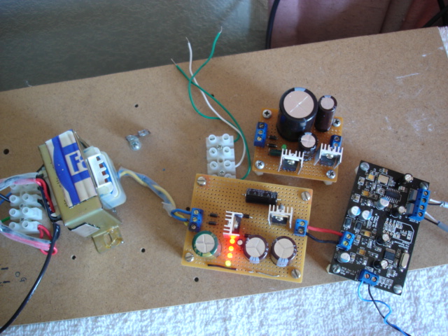

Hi JP,
No, it is not the flea. It is more like the first part of the flea, I think it is called the Regulator booster. It is simply a mosfet based capacitance multiplier in front of a On-semi MC7805. Kind of a variance of this:
regulator booster - pink fish media
The other one is LM317T in the front, followed by the CM. The LM317T adj pin has a string of LED for voltage reference, and 2 x 10uF as the adj bypass caps.
Since I had all the parts at home, so why not build them while waiting for the PS PCB.
On paper, the LM317T should be a better one, but I didn't recall any noticeably difference when I switched one to the other. It could be my ability to hear things or my music memory just isn't good enough. It may also be that the onboard regulators are doing a good job.
Now that I have the dac up for 2 weeks, and one week after putting in the tantalum caps to replace the ceramic. I will say that the Dac sounds very good. My impression is no lack of dynamic and detail. I am no good in describing sounds. So, I am going to AB compare other Dac's that I have. Then I will post my subjective feedback. One particular comparison will be to the AK4396 Dac with all the recommended mods. It is going to be fun!!

Picture of the DAC power by a super regulator.
C19 and C22 will change to Tant cap later.

Looking at your pictures I see that the SPDIF connector should have been at the same side of the board as the L/R connections. After having drawn multiple tens of versions (in months) there finally is a final version. Then, when you have the first example in your hand you think: that could have been designed better 😉
Nice build. You do need to clean the PCB's with PCB cleaner. The flux only has negative effects when it stays on PCB's after soldering. What are the blue electrolytic caps (brand/type) ? The heatsink seems overrated and the fins are mounted the "wrong" way but nothing will go wrong with 70 mA load. You might want to try a 4.7 µF tantalium cap for C8 too.

Hi Skylab,
Is the UCC regulator ideal for being the pre-regulator in this project?
It is a well-designed regulator. But in my experience, it is inappropriate for pre-regulation generally.
I am not syklab but the UCC is fine for supplying 5 V to the DAC. The DAC has good onboard regulation by means of 4 onboard regs all well decoupled, all with beads at their outputs. I even wanted to use a 3 V transformer and use several common mode coils and a few 4700 µF + PPS caps but lacked the opportunity to test. So no regulator at all just ripple and RF filtering. The concern I had when using ADP151 was that they die at input voltages higher than 5.5 V so I never finished it. MIC5205 are more sturdy regarding their inputs. I won't have time to do this anymore since I will be moving houses in october. Everything has to be packed again.
You can spend multiple the amount the DAC has costed on a power supply with the best caps you can find but it won't bring you very much. It should be RF immune for a fact. So use beads and coils where you can especially when you use a toroid !
Feel free to experiment as much as you can with various power supplies. I am the first to accept new insights/experiences with this DAC.
