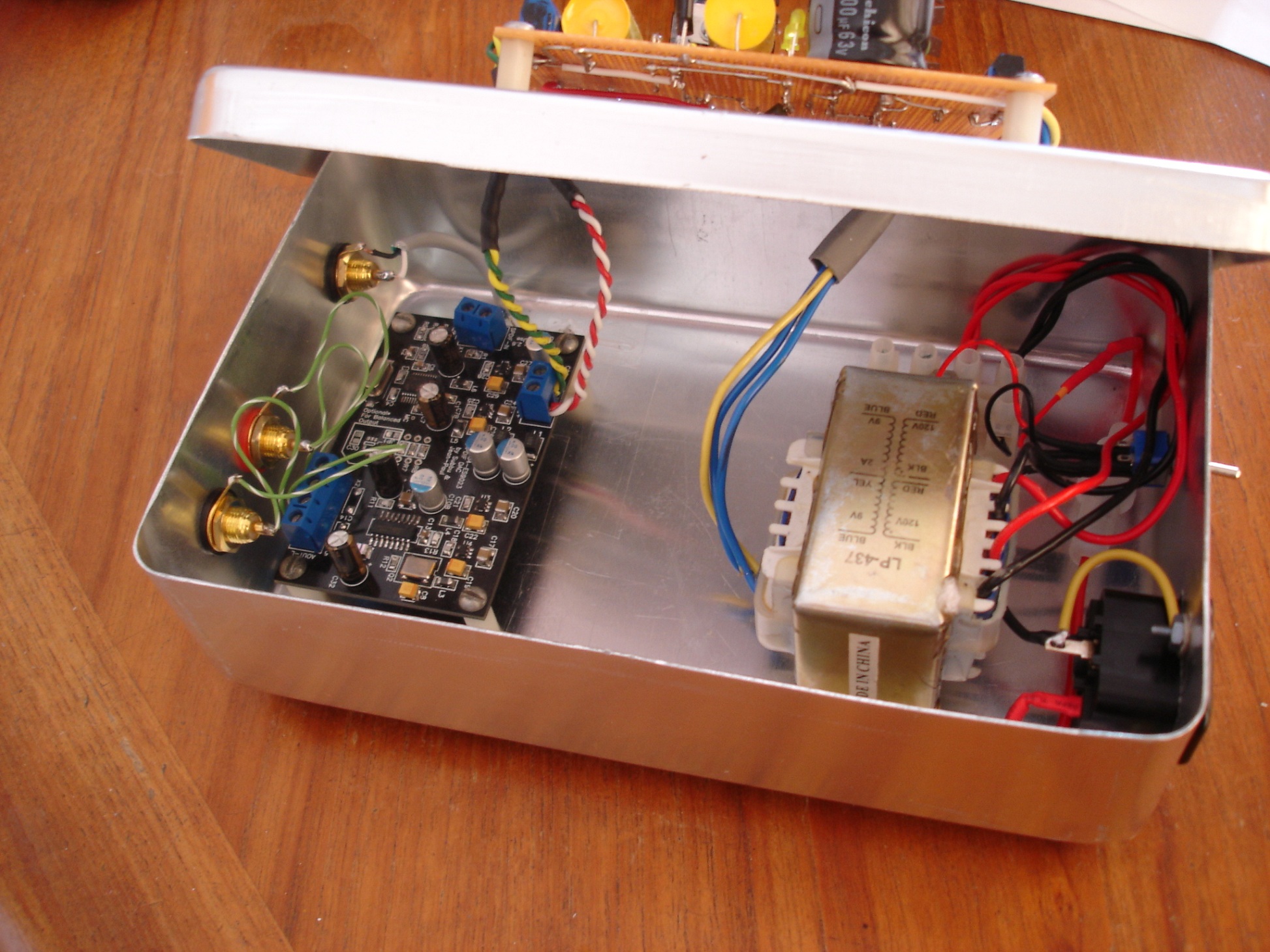

Nice build Stixx. I would have placed the transformer away from the outputs though. Despite the shielded cable it would have been better to avoid 50 Hz stray-in at all. Maybe you can use a "mumetall" sheet. I use that often and it results in total shielding. I would place the transformer to the front side of the case, move the DAC PCB closer to the RCA outputs and the shunt supply somewhat to the right (so the transformer and the shunt supply 180 degrees turned).
Thanks JP. My idea was to place the transformer close to the IEC inlet to have the AC wiring as short as possible. I also tried to have all the connections as short as possible, and I'm not sure whether I met that goal 😉
Anyway the hint with the Mu-metal is a good one... do you have a source you can disclose?

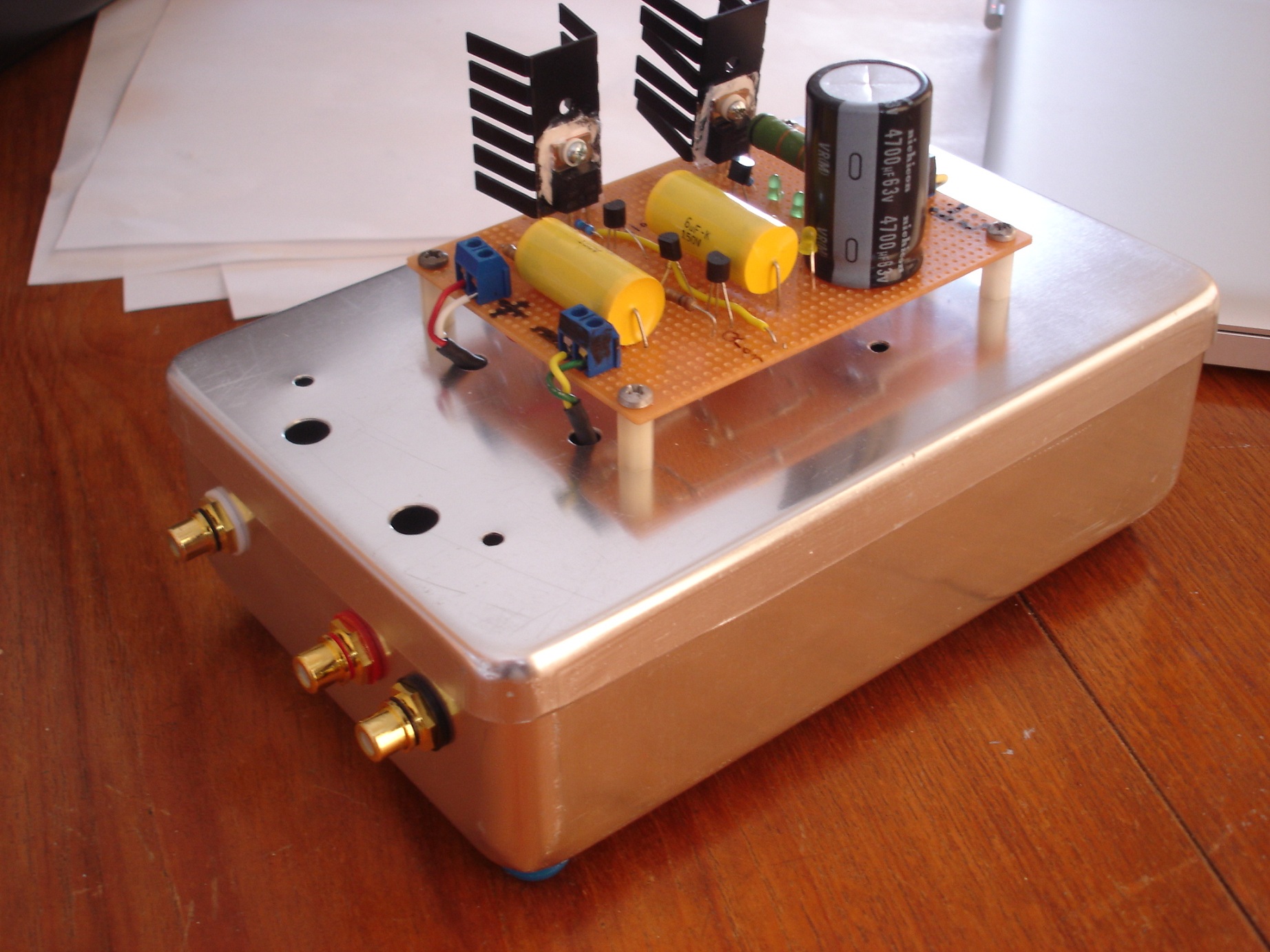

Same combo, SSLV1.1 Bib on a perforate board + JP/Subbu v2.6 except it is a surplus 3 for $10 alu can 😱
am I right, did you actually UN-twist ethernet cable for your output wiring? original hehe.
love the regulator lovechild dry humping the dac enclosure =)
The output wire is from a roll of surplus telfon silver plate copper 24 ga wire, something like USD20 for 2000', way more than I can ever use in my life time 🙂
Now you mentioned it, it does look like those cat 5 wires. I suspect that might be where it was for!!

pchw, your placement of parts is better but output wiring could be shorter by omitting the output connector and solder solid wire first in the DAC PCB and then to the output connectors. Minor detail.
Me too. I suspect the LM723 power supply PCB will fit in the enclosure which will be at least visually somewhat more appealing.
Better longer AC wiring than 50 Hz stray-in from the transformer...
I use NOS mumetal sheets but stock is almost gone. Can't remember where I got it from, it was a long time ago.
Qusp, yup, all safety green, approximately 1/2 - 2/3 of a 1K meter roll.
JP, the way that it is set up is to provide flexibility for testing the 2nd v2.6 board soon. At the moment, I can swap any parts inside at ease. Judging from Subbu's completed PS board in the picture, I probably can fit it inside with very minimal effort.
