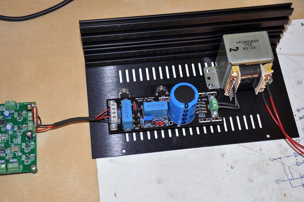

Although the party has already moved on to V3 of the Subbu/JP-DAC I recently connected the original version of the board to a newly built Salas shunt reg (putting out 5V DC).
It just has max. 10 hours on it but I am very positively surprised as the ES9023 DAC is a very neutral and good sounding performer! Comparing to my Audiosector DAC (featuring a Bobken-style reg and BG throughout) I can say that JP’s ES9023 is doing extremely well… in fact it’s hard to pick the better one of the two.
Both qualify as very natural and authentic sounding DAC’s (to my ears of course😉) with a credible soundstage and very good timbre. The Audiosector might have a bit more impact and slightly better bass whereas the ES9023 is super-neutral and has a very smooth treble while retaining all the details you’d ever want.
So hats off to Jean-Paul and Subbu for their good work!
PS. pic shows the DAC just connected to power while I was testing the shunt reg...

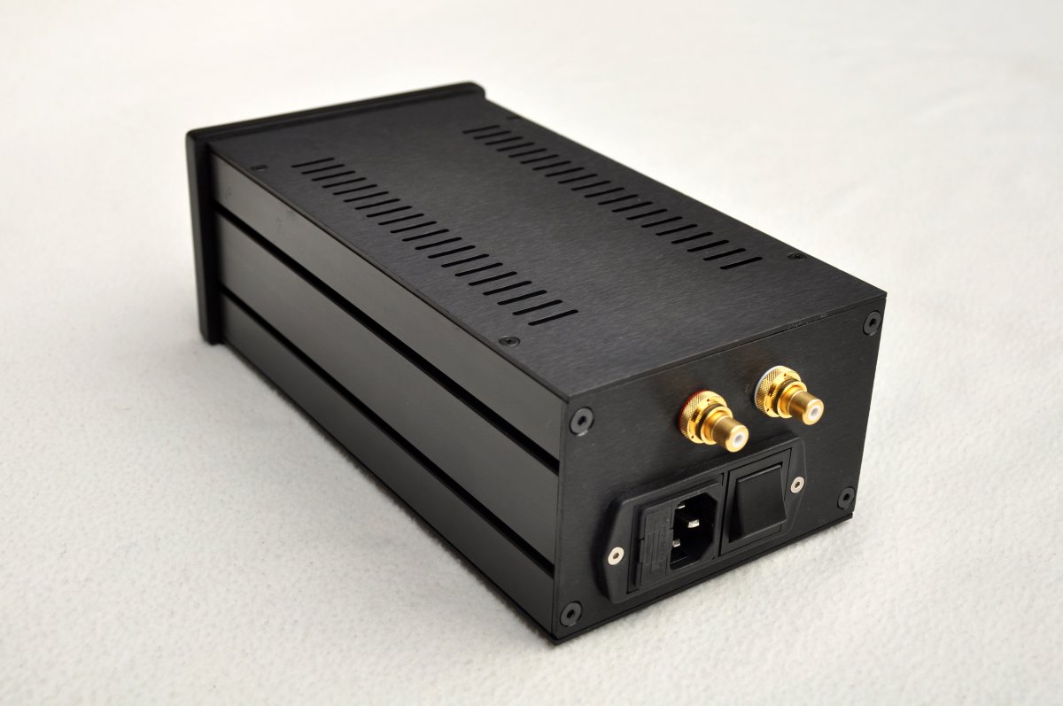

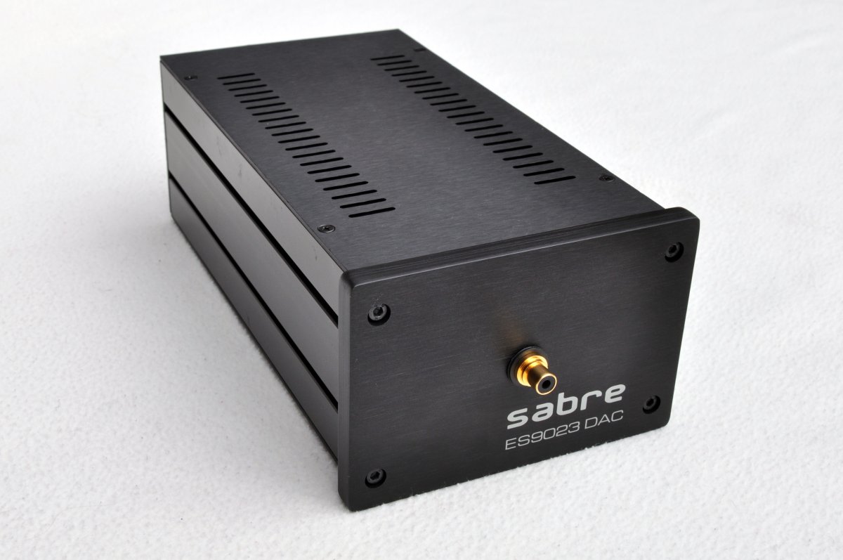

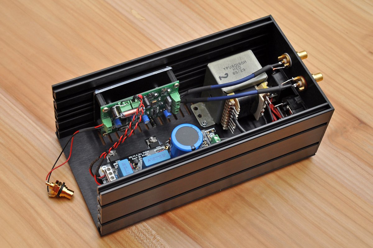

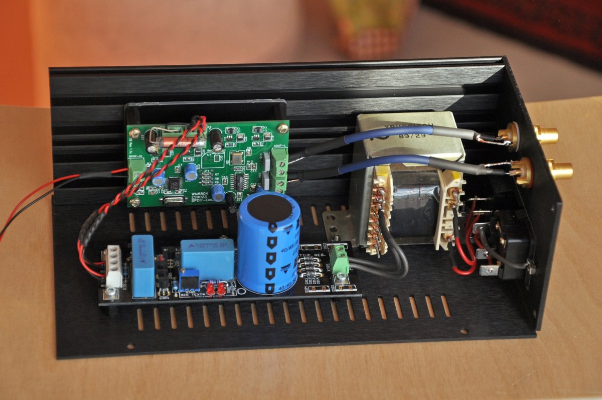

Nice build Stixx. I would have placed the transformer away from the outputs though. Despite the shielded cable it would have been better to avoid 50 Hz stray-in at all. Maybe you can use a "mumetall" sheet. I use that often and it results in total shielding. I would place the transformer to the front side of the case, move the DAC PCB closer to the RCA outputs and the shunt supply somewhat to the right (so the transformer and the shunt supply 180 degrees turned).
AFAIK you can separate the supplies of the WM8804 and the ES9023 with rev 1 boards. Since the power supply seems to have 2 outputs it would not hurt to test/try that.
With the current V3 version both SPDIF and RCA outputs have moved to the underside of the PCB so the PCB can be mounted straight to the back cover just under the RCA plugs on a metal sheet. This was a message from our marketing department.
